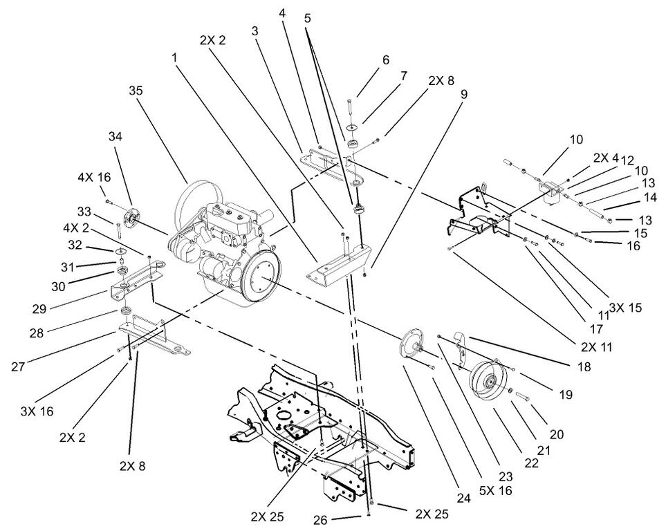

oker 12 #1 Posted October 28, 2023 (edited) Hi! Due to an issue with the injector pump, I have to take out the engine from the tractor. Now i'm having some trouble with the engine mounts. In the parts catalog, the way the front mounts are assembled is really clear, no doubt at all.... but the rear mounts are not clear ...sadly i didn't take any photos of these rear mounts , so it would be great if anybody could upload a photo of the rear engine mounts. Thanks !! Edited October 28, 2023 by oker Share this post Link to post Share on other sites
gwest_ca-(File Mod) 11,738 #2 Posted October 28, 2023 Have you tried a different model year to see if the illustrations are different? https://www.partstree.com/search/?type=model&term=523dxi 1 Share this post Link to post Share on other sites
gwest_ca-(File Mod) 11,738 #3 Posted October 28, 2023 Found this in 2003 manual 1 Share this post Link to post Share on other sites
oker 12 #4 Posted November 1, 2023 Thank´s for the reply. It's a little bit tricky to set engine mounts in place. The motor needs to behold with a jack in order to fit the rear engine mount otherwise it´s impossible to mount the engine in place. Share this post Link to post Share on other sites
