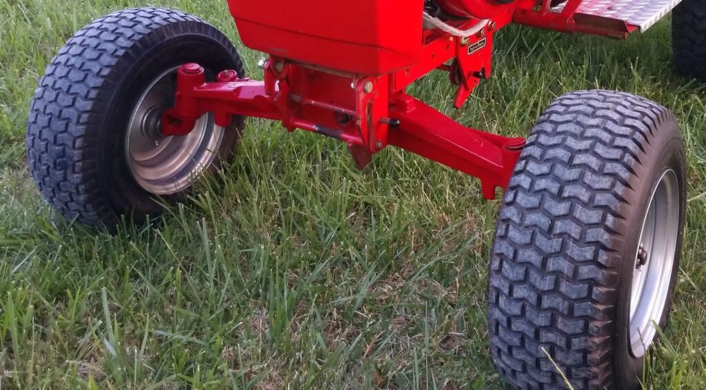

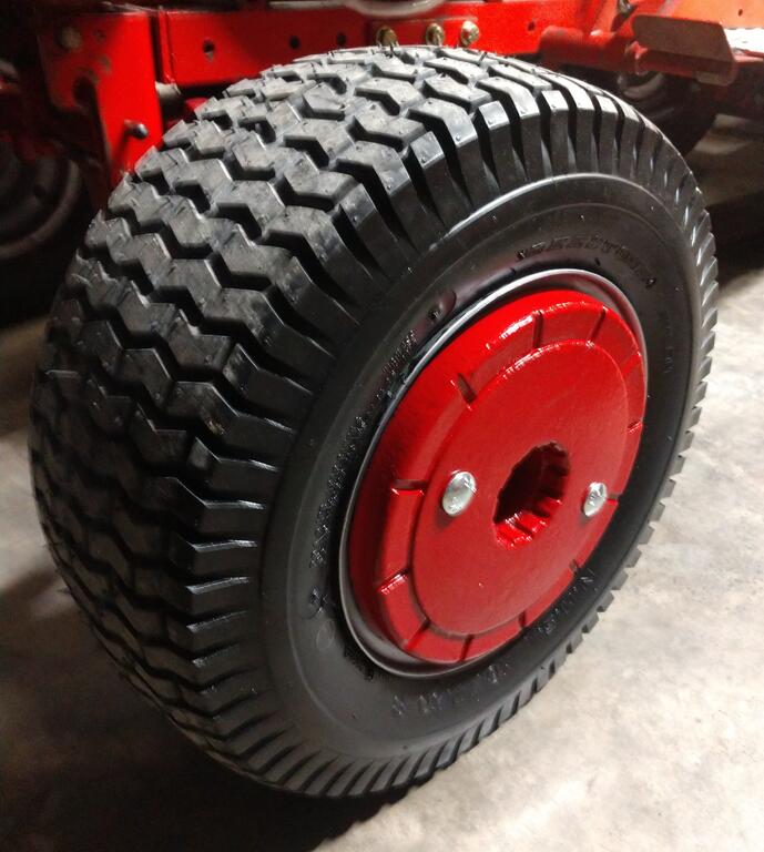

kpinnc 16,199 #3 Posted October 28, 2023 (edited) I can show you a direct comparison. The first pic is a 16x6.50-8, the second are 7.50-8 on the same wheel. Apart from the wheel weight, there's not much difference. Side by side you really can't tell. Back when tires actually measured what they claimed to be, it might have been a bigger difference. Now the 7.50 tires are only about 1/4 inch wider each side. Edited October 28, 2023 by kpinnc 2 Share this post Link to post Share on other sites
