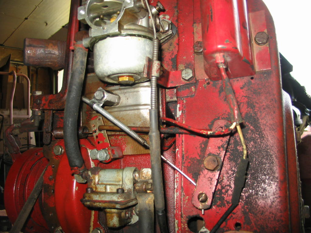

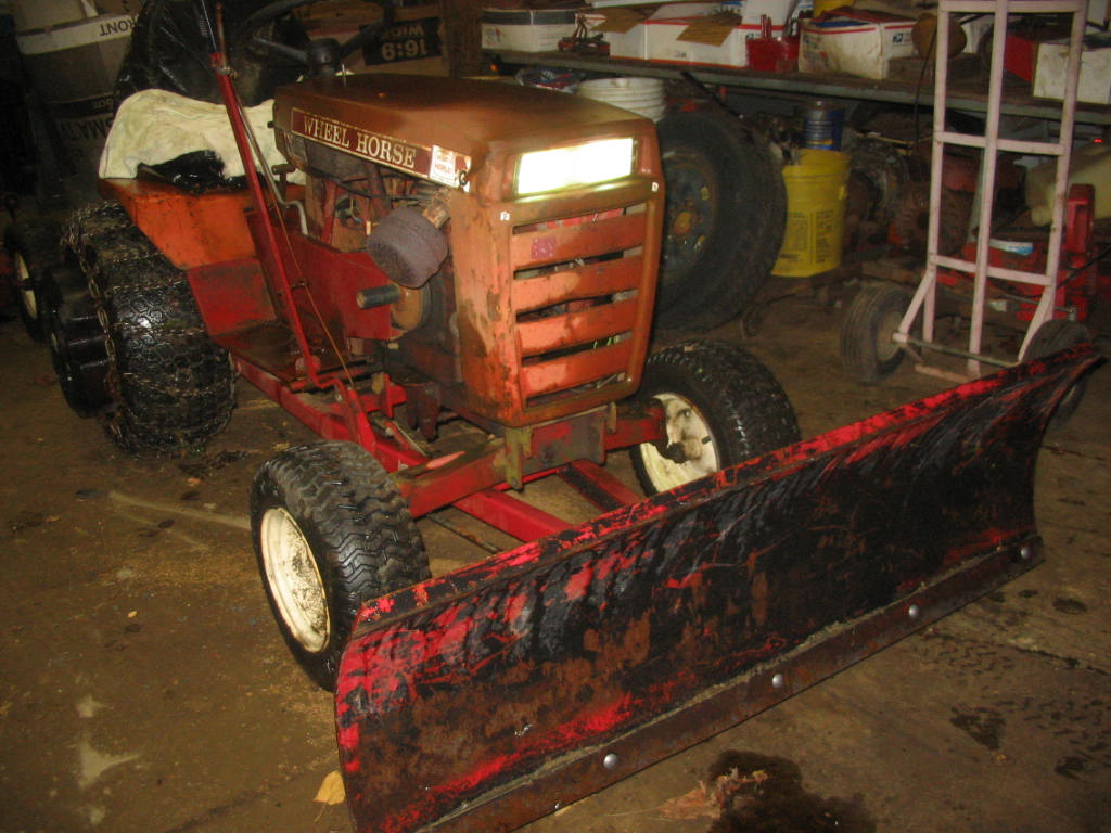

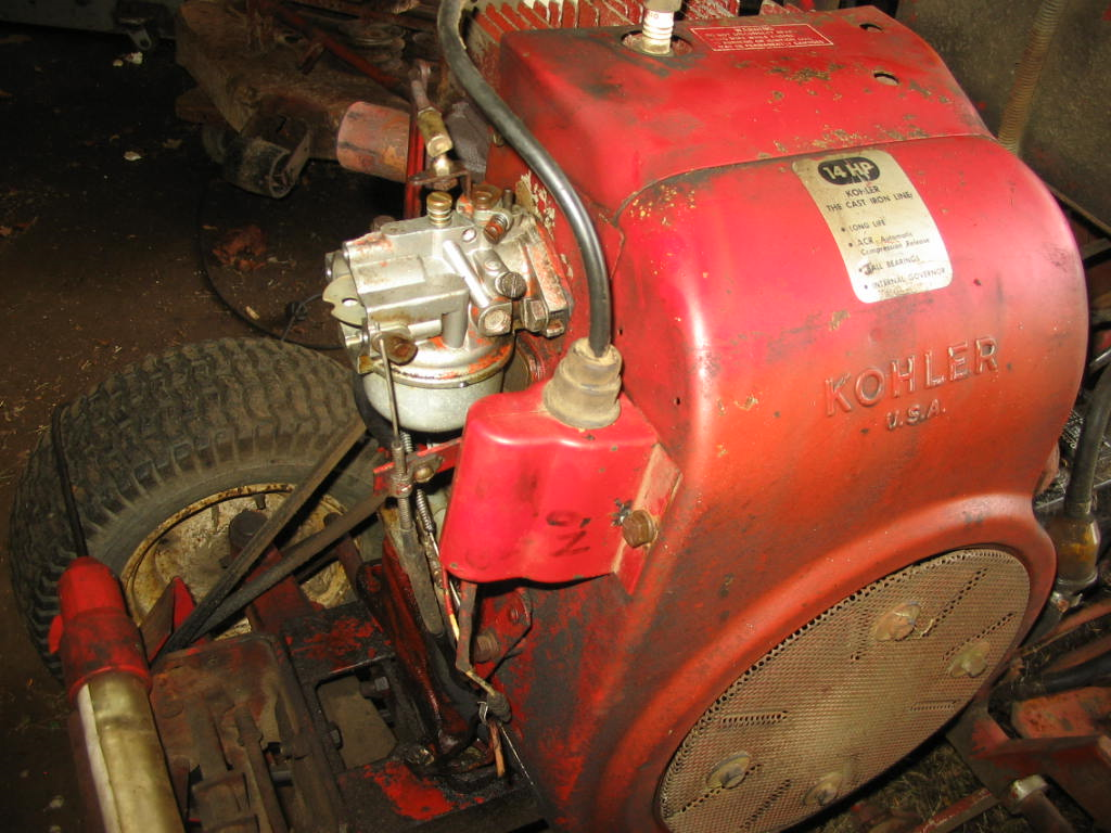

daveoman1966 3,877 #1 Posted October 25, 2023 (edited) My 1972 Bronco 14 with K321 motor--- breakerless ingnition--- BACKFIRES occassionally....but keeps running. Recently, it quit running on me---midway of mowing, of course. I had to push it to my garage and have not tried to start it. What causes the BACKFIRE.... In 2016, I had a local shop LAP the valves and have not had any issues since then...until now. I have a KOHLER carb rebuild kit but not sure that is the BACKFIRE source problem. ps... The engine smokes very little when running, even at 3/4 throttle. The KILL WIRE is and has NOT been working for 2 years and I have to FLOOD it out (choke it) to stop the motor. HELP WANTED--- Edited October 25, 2023 by daveoman1966 notes Share this post Link to post Share on other sites

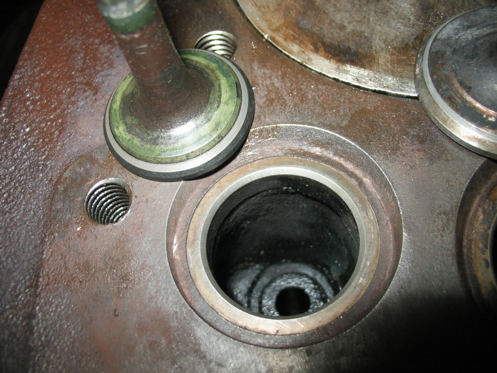

Mike'sHorseBarn 3,351 #3 Posted October 25, 2023 23 minutes ago, kpinnc said: If your kill wire doesn't work, and you're choking the engine to shut it off- that may be the biggest contributing factor. I would agree with this. You may want to check your valve lash again, and if that picture of the valves is from 2016 you may want to check them again. Breaklerless ignition is good at burning valves. I have an electro 12 that needs a good valve job done to it. Share this post Link to post Share on other sites

953 nut 62,166 #12 Posted October 26, 2023 21 hours ago, daveoman1966 said: breakerless ingnition--- BACKFIRES occasionally....but keeps running. . The KILL WIRE is and has NOT been working for 2 years I would begin by repairing the known problems and looking for related issues. It could have a fuel issue but I'm thinking the backfire is ignition related. Most intermittent problems are a poor connection or insulation breaking down. Your ignition system has a trigger device under the flywheel shroud that is connected to the module by a thin wire that has been subject to heat, vibration and other things that could cause the insulation to become compromised. Not a dead short but an intermittent momentary short to ground. Remove the fan shroud and carefully inspect the wire from the module. Connect a new kill wire to the "M" terminal of your ignition switch, even if this doesn't cure the problem it should be done. Replace the spark plug wire, it could have a poor connection causing the problem. If the engine runs well and has good power I doubt that you have a valve problem. The choke being needed has been addressed by @RED-Z06 and @Tuneup, follow thier advice. Share this post Link to post Share on other sites
