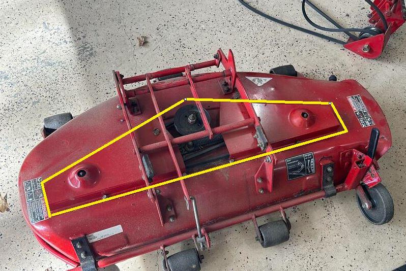

KVustrud 92 #28 Posted October 25, 2023 Just thinking outside the box, has anyone ever tried this? What if you just cut out a section in the top and then cut a single plate from 1/8" or 1/4" steel and welded that in place? That would greatly strengthen the weak points around the spindles as well as the rigidity of the deck. Thoughts? Again, my deck seems great now...but I like tinkering and making improvements and could find another deck to play with! 1 Share this post Link to post Share on other sites

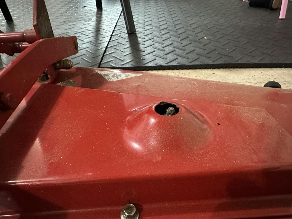

Lee1977 7,805 #33 Posted October 25, 2023 1 hour ago, KVustrud said: Just thinking outside the box, has anyone ever tried this? What if you just cut out a section in the top and then cut a single plate from 1/8" or 1/4" steel and welded that in place? That would greatly strengthen the weak points around the spindles as well as the rigidity of the deck. Thoughts? Again, my deck seems great now...but I like tinkering and making improvements and could find another deck to play with! If you want to reinforce the 42" deck add the plate to the top of the deck the way WH did on the 48" deck. The 42" deck is bad to crack and rust out right under the height adjustment lever. It was bad design moving the heigh adjustment to the open end as the closed end is a lot stronger. I would add an 1/8" plate on the inside under the height adjustment. I added reinforce plates also under the wheel brackets. your deck already has the reinforcement under the lift brackets. 1 Share this post Link to post Share on other sites
kpinnc 19,008 #34 Posted October 25, 2023 (edited) 2 hours ago, KVustrud said: 1/8" or 1/4" steel and welded that in place? That would greatly strengthen the weak points around the spindles as well As the area around the spindles has stamped stress points already, it will make very little difference. To prevent creating a rust pocket, you'd have to cut out and replace the area you specified. You would also have great difficulty welding it in without warping one part or the other. Edited October 25, 2023 by kpinnc 1 Share this post Link to post Share on other sites
Lee1977 7,805 #35 Posted October 25, 2023 2 hours ago, kpinnc said: As the area around the spindles has stamped stress points already, it will make very little difference. To prevent creating a rust pocket, you'd have to cut out and replace the area you specified. You would also have great difficulty welding it in without warping one part or the other. His doesn't look to have the stamped area around the spindle mounts. I know my 1989 42" deck doesn't have them. I have seen that formed area on rear discharge deck 2 Share this post Link to post Share on other sites

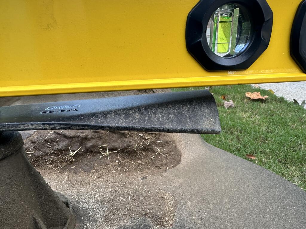

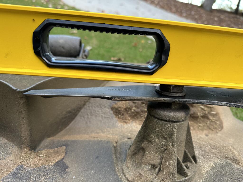

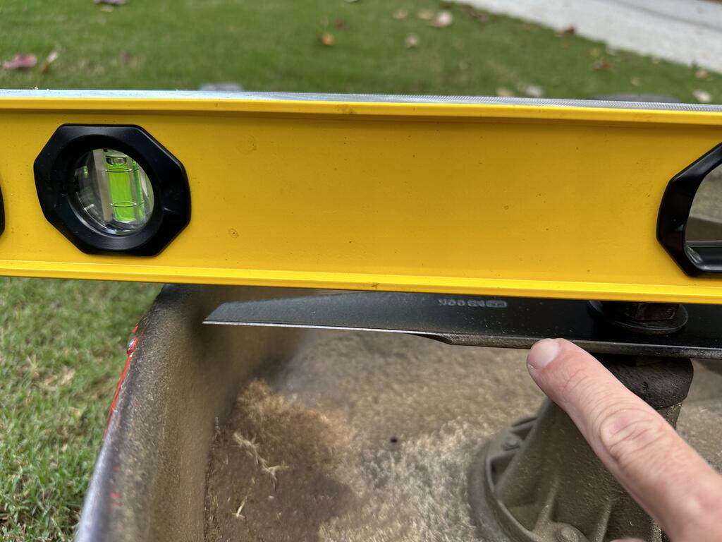

KVustrud 92 #39 Posted October 26, 2023 So it does cut very clean and nice and operates very quietly. But I think I have a problem. The right side (chute side) definitely cuts a little lower than the other two blades. If I place a straight edge across the blades, I can see the middle and left side blade sit even and have even space between blade tips and level. The right side blade however does not, it’s pretty far off. Is this a “sprung” deck??? Ugh this is frustrating. I bought a WH because the deck rides on the ground and I need a clean cut!!!! (Bermuda cut at 2”) 1 Share this post Link to post Share on other sites

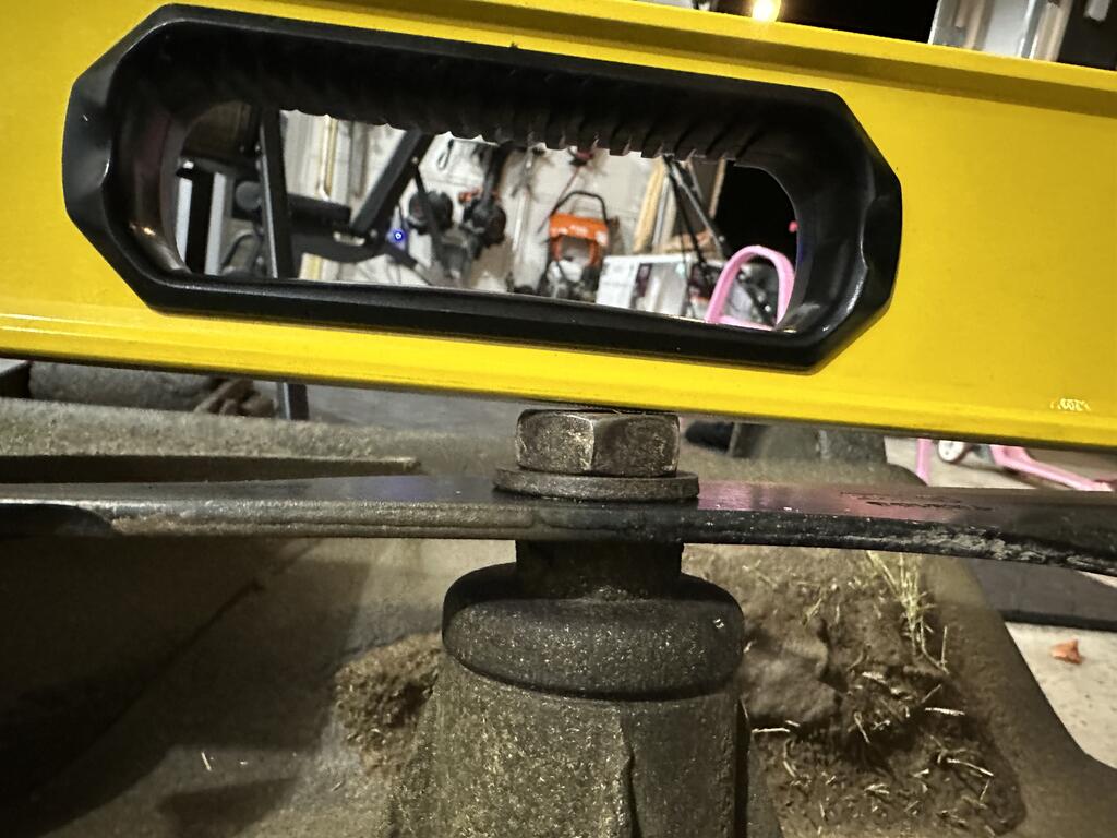

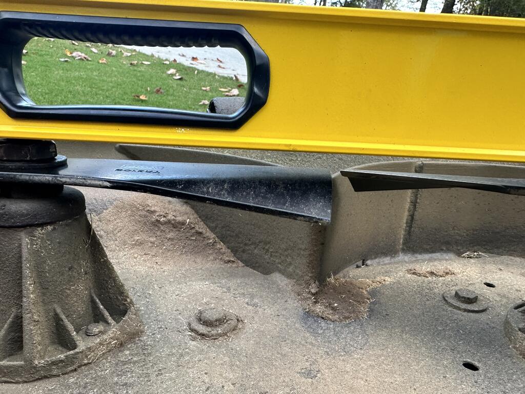

KVustrud 92 #40 Posted October 26, 2023 (edited) You can see the nut is not even flush on the straight edge and the difference in distance between blade and straight edge on each side. (Last 2 pics in this post are the good ones. The other prior pics are the uneven right side where something is off) it’s like that spindle assembly is bent inward towards middle of deck. This forcing outside of blade at chute end of deck lower to the ground. This explains the uneven cut. Edited October 26, 2023 by KVustrud 1 Share this post Link to post Share on other sites
KVustrud 92 #41 Posted October 26, 2023 (edited) Need to figure this out. I love the engineering, the build quality, the simplicity of the tractor. But I NEED it to cut nice! Help me lol! Really disappointed in the deck right now, not the tractor! Is my solution a 48” deck? Im not against a rear discharge either. Or am I overthinking this and just need to put a pipe on that blade and bend it back? Edited October 26, 2023 by KVustrud 1 Share this post Link to post Share on other sites
oliver2-44 11,782 #42 Posted October 26, 2023 2 hours ago, KVustrud said: Need to figure this out Or am I overthinking this and just need to put a pipe on that blade and bend it back? That probable will bend the blade and make it worse. Most likely the top of deck area that the spindle bolts to is bent. I restored a 42 “ deck which had a sprung shell from a visible front impact and the left blade was bent from an impact. I stripped the deck and used a rosebud to heat and straighten the shell. Like you, I also had to straighten the mounting area for the left spindle. It has cut great for 5 years now. The previous owner game me the tractor and deck because it started cutting poorly…..probably never looked at the deck to see the obvious bent areas 1 Share this post Link to post Share on other sites

KVustrud 92 #48 Posted October 26, 2023 13 hours ago, KVustrud said: So it does cut very clean and nice and operates very quietly. But I think I have a problem. The right side (chute side) definitely cuts a little lower than the other two blades. If I place a straight edge across the blades, I can see the middle and left side blade sit even and have even space between blade tips and level. The right side blade however does not, it’s pretty far off. Is this a “sprung” deck??? Ugh this is frustrating. I bought a WH because the deck rides on the ground and I need a clean cut!!!! (Bermuda cut at 2”) Opinions please? Am I being too much of a perfectionist here? Or does this really look like a problem? To me, it does....but maybe my expectations were too high in terms of deck tolerances? 1 Share this post Link to post Share on other sites
Handy Don 17,561 #49 Posted October 26, 2023 I aimed to be within about ¼” (~7 cm) edge-to-edge to the ground when I set up my refurbished ’68 gear drive two-blade mowing deck. The deck itself was true but I wanted to be sure the gauge wheels and the forward part of lift frame were all good as well. During the refurbishing, I did discover that one of the spindle bearings was missing entirely (not just the needles--ALL of it) so I’m sure that was the cause of the blade tips on that side gouging the shell and the excess wear on one set of gears. I ended up rebuilding the rusted out/worn supports for all three of the anti-scalp wheel mounts, as well. As for “perfectionism”--I say "to each their own." I prefer to cut my very mixed vegetation “lawn” at ~3.5” (~85 cm) and at that height so a slight difference in cutting height isn’t noticeable. 2 Share this post Link to post Share on other sites
