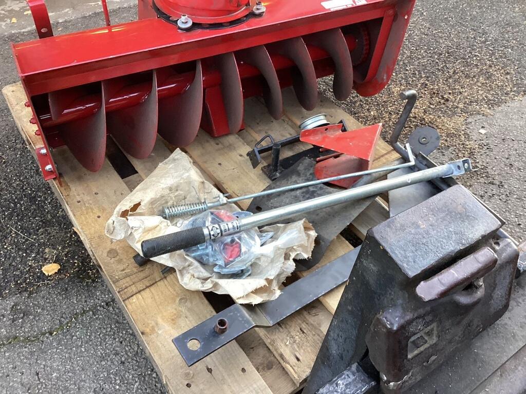

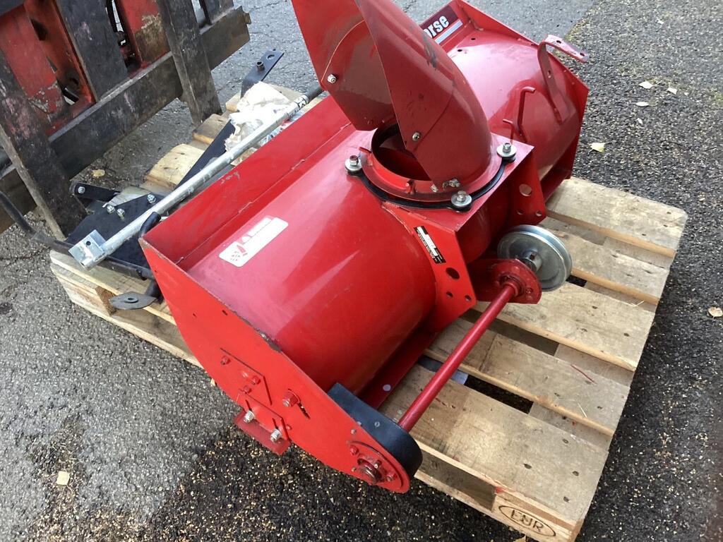

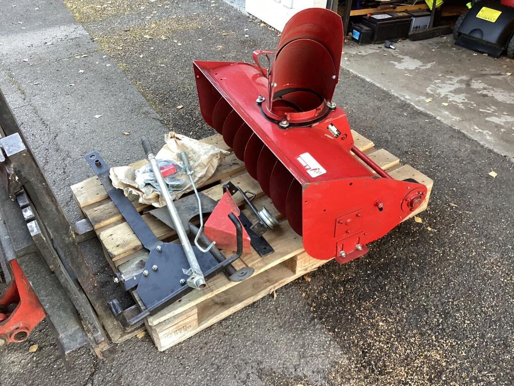

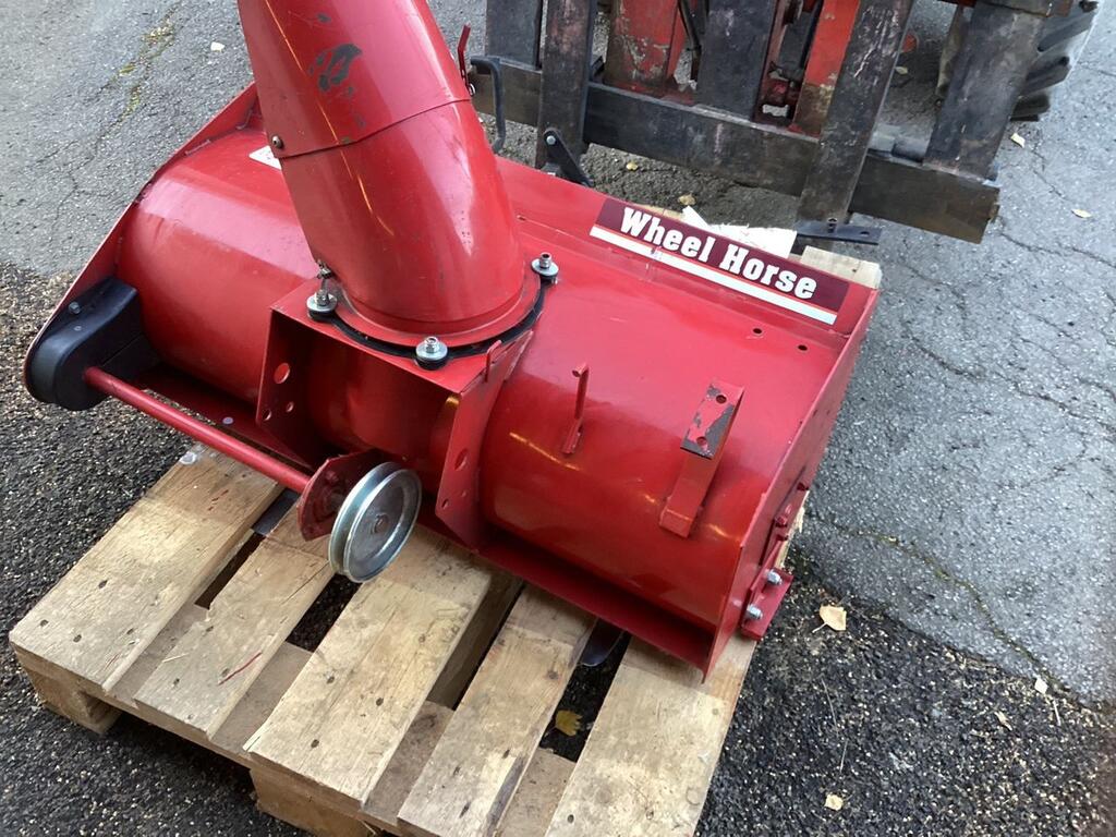

Ian928 46 #1 Posted October 23, 2023 Will it fit? Can we make it fit relatively easy? Thank you! 1 Share this post Link to post Share on other sites
gwest_ca-(File Mod) 11,752 #2 Posted October 23, 2023 I don't think it will fit. Post all the numbers on the data decal. Can see it in the first photo left side below the chute. 2 Share this post Link to post Share on other sites
Ian928 46 #3 Posted October 23, 2023 I will ask the seller for the info. We have the original blower that can be used for parts, but it is not in a good condition like this one. 1 Share this post Link to post Share on other sites
Ed Kennell 43,119 #4 Posted October 23, 2023 24 minutes ago, Ian928 said: Will it fit? No, that blower is for a vertical engine tractor. Can we make it fit relatively easy? Easy, no. Anything is possible if you like to cut, fabricate, and weld. You would need a longer jack shaft to move the drive pulley to the right to align with the engine pulley. Also need to fabricate the mounting support and a belt clutch/tensioner assembly. Thank you! 2 Share this post Link to post Share on other sites
953 nut 62,223 #5 Posted October 23, 2023 1 hour ago, Ian928 said: We have the original blower that can be used for parts, If you have fabrication and welding skills there is no reason it couldn't be adapted to work with the blower and mounting hardware you have. 1 Share this post Link to post Share on other sites
Ed Kennell 43,119 #6 Posted October 24, 2023 (edited) If you do decide to adapt it to your horizontal engine tractor, make sure the rotation direction is correct. I am not sure if they are the same. Looking at the auger and rethinking, I believe they are different. Edited October 24, 2023 by Ed Kennell 2 Share this post Link to post Share on other sites

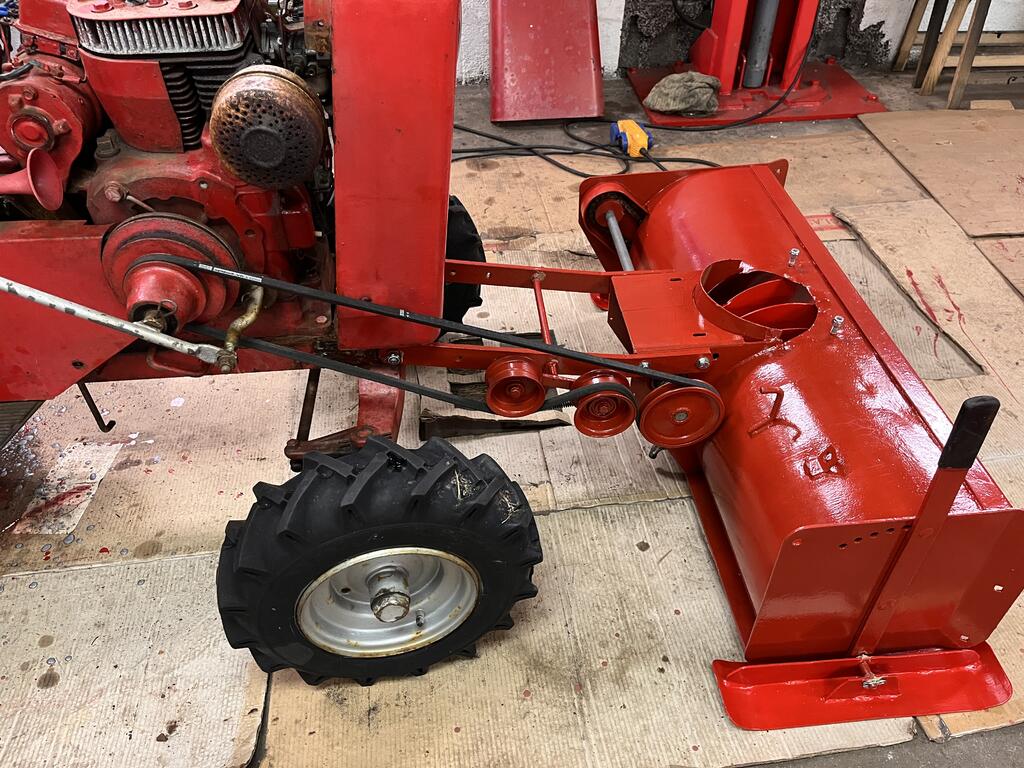

Ian928 46 #7 Posted October 24, 2023 Quote This is the serial number as written to me from the owner: id nr. 06365l01 5 0326 v Is it possible to get some information from this? 1 Share this post Link to post Share on other sites
Handy Don 14,694 #8 Posted October 24, 2023 IMHO, you’d be much better off spending your time to get a blower that already fits. Adapting that one is not trivial and involves not only the mount/lift mechanism but also re-doing the drive line. 2 Share this post Link to post Share on other sites

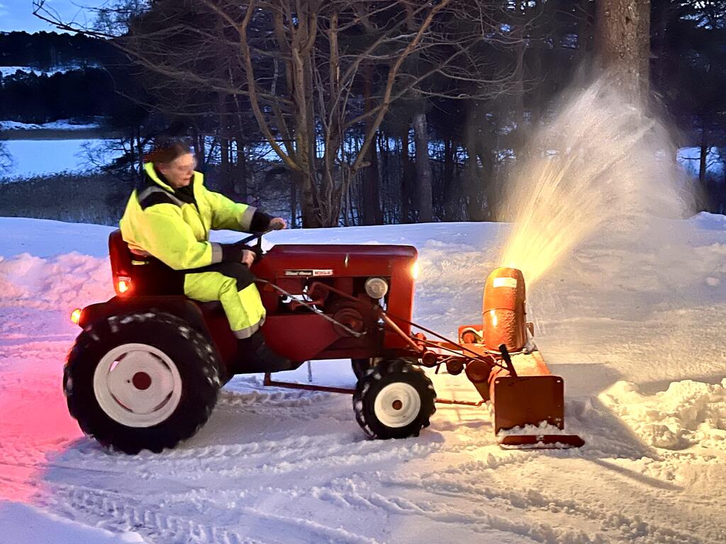

Ian928 46 #13 Posted January 2, 2024 Hello again, sorry that I did not respons earlier. We decided to restore the original ST-374 Snow Thrower. We used a chemical dipping bath to remove rust and paint, then all parts received two coats of epoxy then two coats of red enamel. We renewed all bearings and made a Lifting flag and rod. It was mentioned how people in Norway have been using ingeniuity to cope when it was hard to get spare parts. The snow thrower had at one time had its small wheels replaced by aluminium skis (of course, we are Norwegians after all!), we tried to fit those but the skies only made the thrower try to climb on top of the snow, so we found some small wheels instead. The thrower is working wery well, with the correct speed it will throw the snow really well. We now need to find some snow chains for the rear wheels. 4 Share this post Link to post Share on other sites
