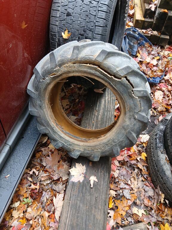

Handy Don 17,735 #201 Posted October 26, 2025 On 10/25/2025 at 12:52 PM, 702854boy said: I think this tire has another 40 years of use in it Shredded and used under NFL artificial turf, maybe Share this post Link to post Share on other sites

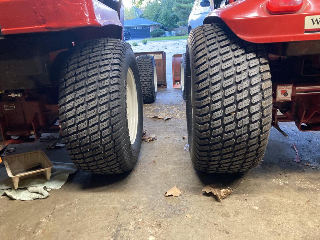

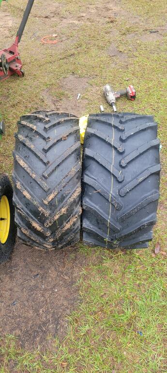

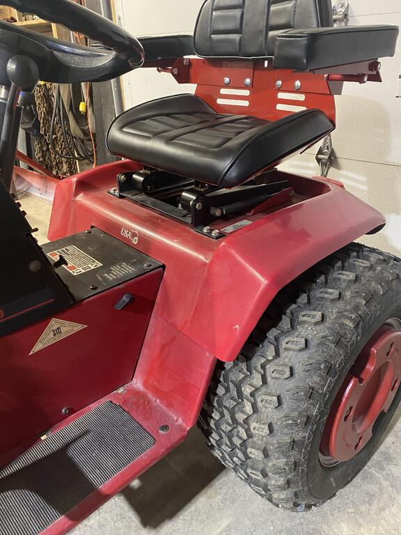

sqrlgtr 4,224 #202 Posted November 6, 2025 Swapped out some 23-8.50 Deestone for 23-8.50 carlisle. Raised tractor by a little over an inch and probably 1/2” or more wider. You may have to enlarge oics to see differences and last pic is with one each on traactor. 2 Share this post Link to post Share on other sites
RED-Z06 2,720 #203 Posted November 6, 2025 22 minutes ago, sqrlgtr said: Swapped out some 23-8.50 Deestone for 23-8.50 carlisle. Raised tractor by a little over an inch and probably 1/2” or more wider. You may have to enlarge oics to see differences and last pic is with one each on traactor. Yes Deestones run extremely small, i sent a set back this year because their 23x10.50-12 measured 21x9.50-12.. 3 Share this post Link to post Share on other sites
sqrlgtr 4,224 #204 Posted November 7, 2025 They do run small shame to because they are pretty good tires beside that. I have had those for a least 12yrs. 1 Share this post Link to post Share on other sites

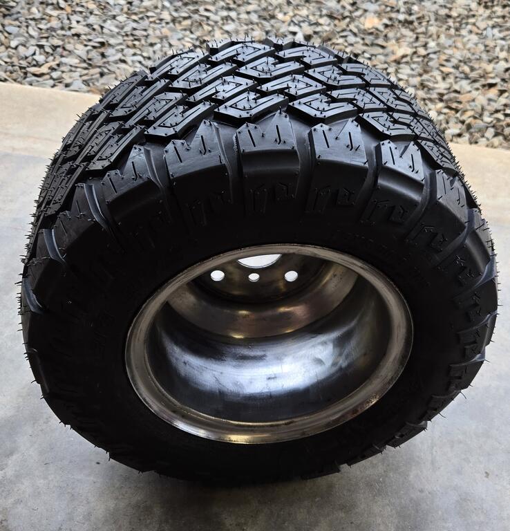

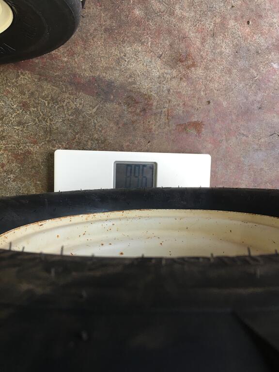

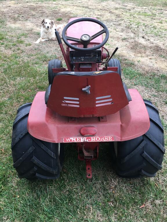

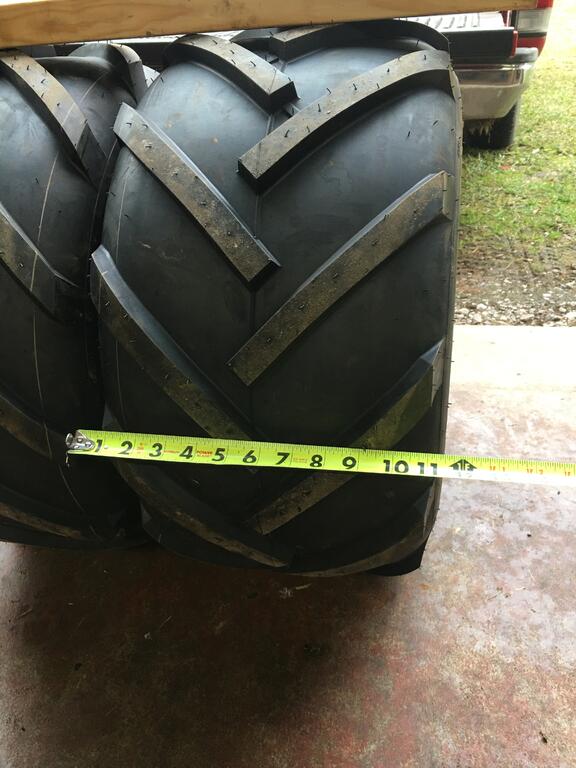

sqrlgtr 4,224 #205 Posted December 26, 2025 (edited) Horseshoe brand 24-12-12 tires. They are a little over 23.5” tall with a width of around 12” sidewall to sidewall right at 11” across tread. Picture beside an older 23-10.50-12 for comparison. Weight 89.6 lb. With rim gaurd. On 9.5 inch rim. Edited December 26, 2025 by sqrlgtr 1 Share this post Link to post Share on other sites
ebinmaine 81,278 #206 Posted December 26, 2025 1 hour ago, sqrlgtr said: Horseshoe brand 24-12-12 tires Niiiiice fat meats. 1 Share this post Link to post Share on other sites
sqrlgtr 4,224 #207 Posted December 27, 2025 Wifey caught me with her floor scale and wanted to know why I had it out in shop. I told her I had to replace the springs she had stretched out in it. Took her a minute but she didnt find that response to funny 1 1 Share this post Link to post Share on other sites

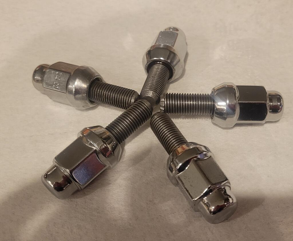

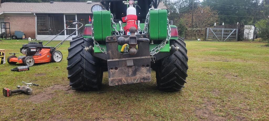

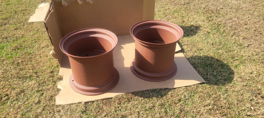

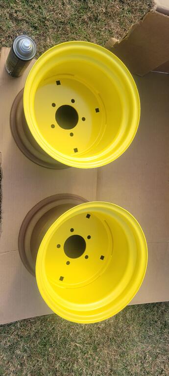

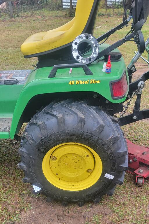

RED-Z06 2,720 #211 Posted December 27, 2025 I ordered a pair of Tiron 10.5 wide wheels to put on my loader tractor, i hated how the old 26x12x12 lugs had bulged out and rounded. So, i had wheels but the wheels had 1/2" holes, i bought spacers with the right size studs but the 7/16 lug bolts wouldn't hold the spacers, so i bought 7/16-20 all-thread, and 7/16-20 lug nuts, and made my own bolts, got the wheels on to realize that the wheels are flat, no lug centric pockets, so I ordered some flat faced 7/16-20 lug nuts, got a set of 26x12x12 Tru-Powers on, ballast in, and weights installed. Game changing setup for stability and traction. So, this is what 26x12x12 tru-power tires look like on 10.5 wide wheels. 3 Share this post Link to post Share on other sites
Handy Don 17,735 #212 Posted December 27, 2025 3 minutes ago, RED-Z06 said: 7/16-20 all-thread, and 7/16-20 lug nuts Most all-thread is pretty low-grade steel unless you specifically look for the stronger stuff 2 Share this post Link to post Share on other sites
RED-Z06 2,720 #213 Posted December 27, 2025 34 minutes ago, Handy Don said: Most all-thread is pretty low-grade steel unless you specifically look for the stronger stuff Grade B7 125,000 tensile strength. 3 Share this post Link to post Share on other sites

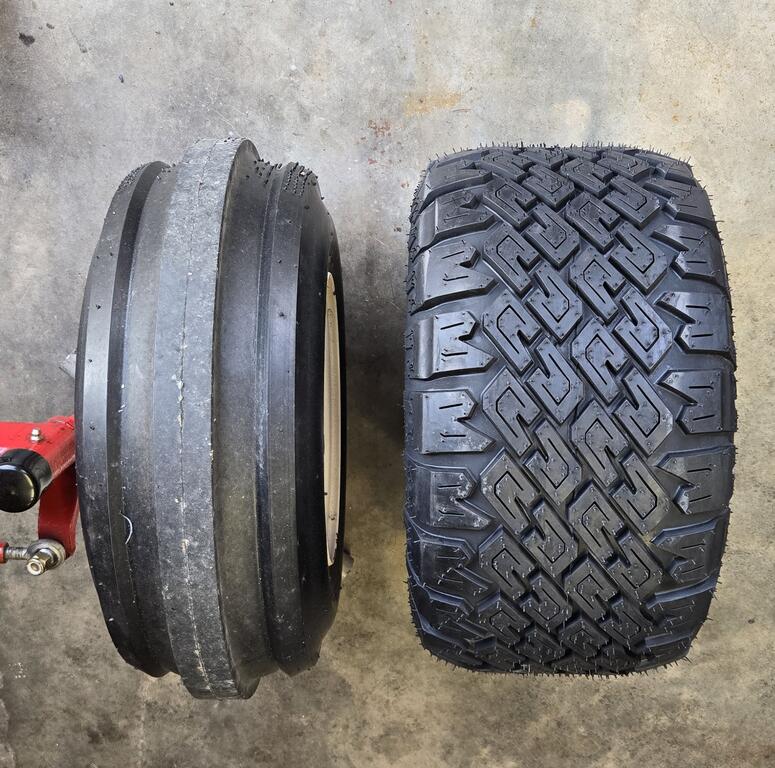

kpinnc 19,105 #214 Posted March 2 (edited) Got some new tires that I thought would be a good reference here. Armstrong "Big Bite" 16x8.50-8. 4 ply rated. Actual measurements are dead on 16 inches tall, 8 and 3/8 wide. First pic is one next to a 7.50 wide tire, next beside the old Firestone 6.50 tri ribs. Mounted on 8x7 wheels. Edited March 2 by kpinnc 1 5 Share this post Link to post Share on other sites
David414 323 #215 Posted March 6 On 12/26/2025 at 4:23 PM, sqrlgtr said: Horseshoe brand 24-12-12 tires. They are a little over 23.5” tall with a width of around 12” sidewall to sidewall right at 11” across tread. Picture beside an older 23-10.50-12 for comparison. Weight 89.6 lb. With rim gaurd. On 9.5 inch rim. Great look! Where did you get those rims? Will the larger tires interfere with the mowing deck? Share this post Link to post Share on other sites
sqrlgtr 4,224 #216 Posted March 6 4 hours ago, David414 said: Great look! Where did you get those rims? Will the larger tires interfere with the mowing deck? The wheels came off an older Craftsman mower. Not sure on deck? I haven't had a deck on this particular tractor in a long time. I think they would be alright but really not fer sure. . Share this post Link to post Share on other sites

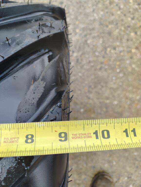

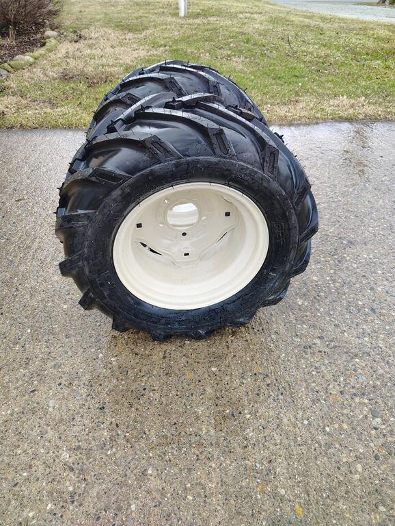

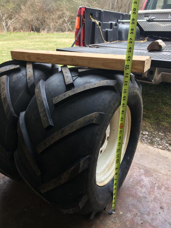

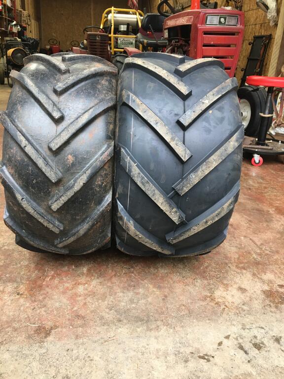

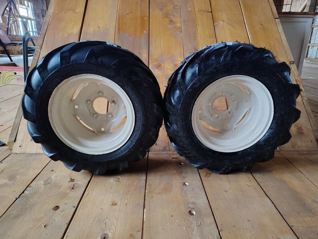

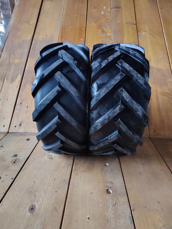

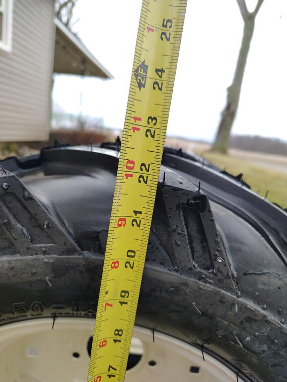

AlexR 3,139 #217 Posted March 7 Here is the run down on the BKT TR-315 23x10.50-12 -7.5" wide rim -Less then 5 psi fluid filled -22.5" height -8 3/4" width Deestone (left) vs BKT Right Deestone (left) vs BKT (right) 2 1 2 Share this post Link to post Share on other sites
ebinmaine 81,278 #218 Posted March 7 14 minutes ago, AlexR said: 8 3/4" width Interesting how yours are so much narrower than mine. I have a set that measures 9.5 inches across. 1 Share this post Link to post Share on other sites
SylvanLakeWH 32,919 #219 Posted March 7 1 hour ago, ebinmaine said: Interesting how yours are so much narrower than mine. Common problem... same brand, same marked "size"... different country of manufacture... go figure... 2 Share this post Link to post Share on other sites
AlexR 3,139 #220 Posted March 7 (edited) 1 hour ago, ebinmaine said: Interesting how yours are so much narrower than mine. I have a set that measures 9.5 inches across. Are yours mounted on a rim and inflated any? I do like how the BKT's tread is a flatter on the edges then the deestones. Both tires on are the same size rim and should be close to the same psi. Edited March 7 by AlexR 1 Share this post Link to post Share on other sites
kpinnc 19,105 #221 Posted March 8 4 hours ago, ebinmaine said: have a set that measures 9.5 inches across. Rim width has a big effect on how wide the tire spreads, and how flat the tread and sidewalls end up. Especially true for ag cleats. 2 Share this post Link to post Share on other sites
ebinmaine 81,278 #222 Posted March 8 4 hours ago, AlexR said: Are yours mounted on a rim and inflated any? I do like how the BKT's tread is a flatter on the edges then the deestones. Both tires on are the same size rim and should be close to the same psi. Mine are not mounted yet, no. Share this post Link to post Share on other sites

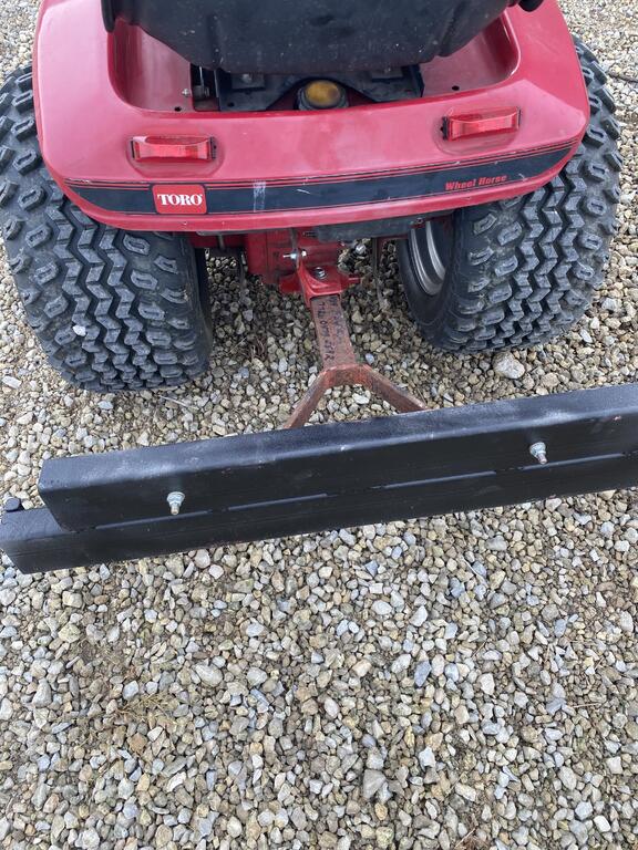

Tonytoro416 1,396 #223 Posted March 8 Tread or lugs on a new tire do no good if only 70% of them actually come into contact with the surface. When setting up my 416 I was not settling for anything less than a flat contact patch. Makes a world of difference if your tires are hunting for traction and your able to give them all that’s available 3 Share this post Link to post Share on other sites
HyperPete 949 #224 Posted March 8 18 hours ago, AlexR said: Here is the run down on the BKT TR-315 23x10.50-12 -7.5" wide rim -Less then 5 psi fluid filled -22.5" height -8 3/4" width Deestone (left) vs BKT Right Deestone (left) vs BKT (right) Now that is interesting to me, I was not aware that I should drop the tire pressure with beet juice! This likely contributed to my lack of traction in the snow. I have the same tires, I'll reduce them to 5 psi. 2 Share this post Link to post Share on other sites
ebinmaine 81,278 #225 Posted March 8 1 hour ago, HyperPete said: Now that is interesting to me, I was not aware that I should drop the tire pressure with beet juice! This likely contributed to my lack of traction in the snow. I have the same tires, I'll reduce them to 5 psi. Having lower air pressure isn't a requirement for fluid filling specifically. It helps with keeping more of the tread on the ground surface by making the flat part at the bottom longer and wider. Are you using chains? 1 Share this post Link to post Share on other sites
