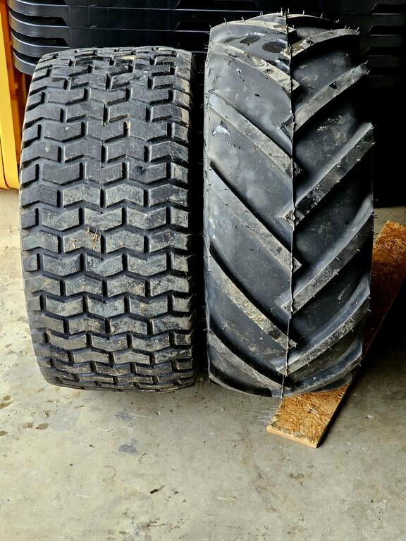

HyperPete 943 #178 Posted June 9, 2025 I have the AGs, but I'll be South of Cancun until Saturday night, so I can't get measurements until then. Here are some photos of them along with Carlisle turfs from January, before mounting.. 1 1 Share this post Link to post Share on other sites

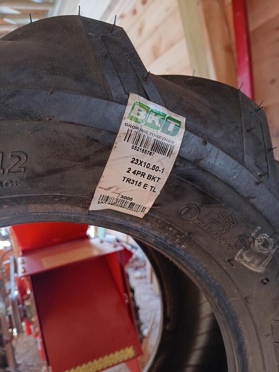

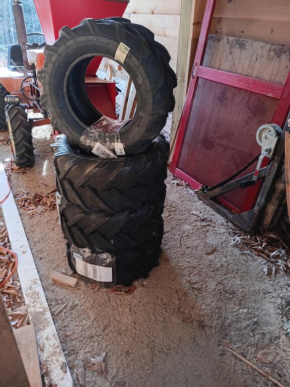

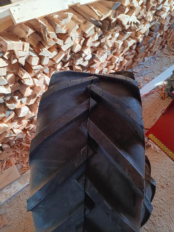

ebinmaine 81,053 #184 Posted July 16, 2025 On 12/15/2024 at 4:37 PM, ebinmaine said: Here we have some BKT TR315 Trencher/Agricultural tires. 23 x 10.50 x 12 I don't have these mounted yet. They measure 21 3/4" x 9 1/2" as setting. They'll definitely grow some with the rated 20 lbs air pressure. 4 ply. These are available online for anywhere from $90 to $120 each all year. I paid $80 each on a sale. November 2024. I believe these will be excellent for our particular usage. I like a slightly heavier duty tire than most. These have a good aggressive sharp square edged full width bar 45⁰ ish AG tread which should self clean nicely and also retain decent ride quality for those who like a smoother tire. My usage is on mid 70s C Series. Stock size was 8.5 wide. The added couple inches MAY cause clearance issues with Automatics. Spacers solve that. @AlexR 1 Share this post Link to post Share on other sites

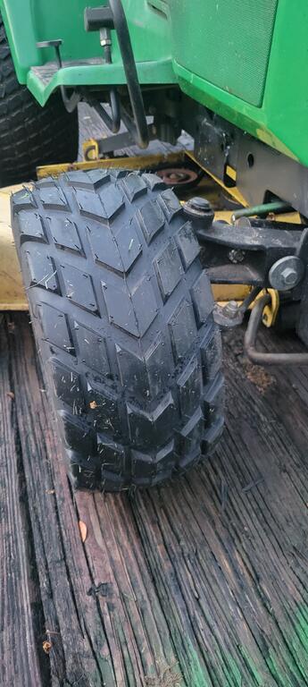

RED-Z06 2,720 #185 Posted August 23, 2025 On 10/24/2023 at 12:28 PM, kpinnc said: These tires are 18x9.50-8. The rims are an inch wider than standard "wide" front wheels. Finally got a pair of those fronts 1 1 Share this post Link to post Share on other sites
kpinnc 19,037 #186 Posted August 23, 2025 @RED-Z06 They look nice! 1 Share this post Link to post Share on other sites

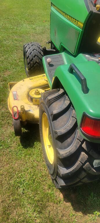

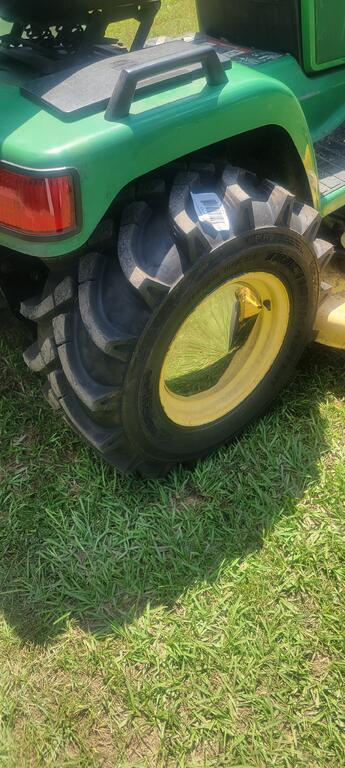

RED-Z06 2,720 #187 Posted August 24, 2025 Mowed 3acres of foot high wet grass yesterday, these tires self clean extremely well. The old turfs would accumulate a thick belt of cut grass, these tires did pickup grass but accelating briefly it threw it off. Great tires 1 1 Share this post Link to post Share on other sites

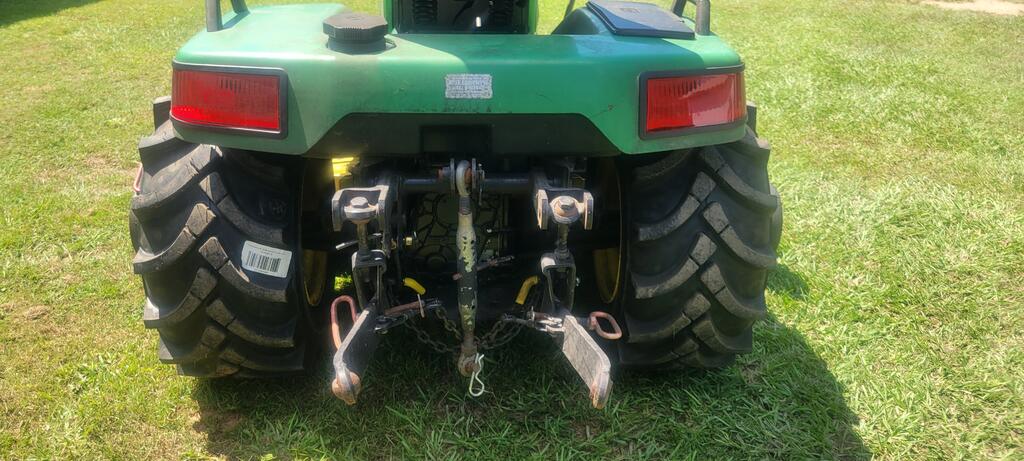

RED-Z06 2,720 #188 Posted September 4, 2025 These are 26x12x12 Hercules 8ply Traction Masters, the absolute hardest tires ive ever mounted in my life, if not for having the front loader to force the rims into the tires, then to push the tire down below the bead, there's no way i could have done it. Inflated height us 26", width is 11.5", 3 Share this post Link to post Share on other sites
ebinmaine 81,053 #189 Posted September 4, 2025 3 hours ago, RED-Z06 said: 26x12x12 Hercules 8ply Traction Masters, the absolute hardest tires Inflated You could definitely run those with 0 air pressure. Mebbe give em a hair more flexxeeness. Share this post Link to post Share on other sites
RED-Z06 2,720 #190 Posted September 4, 2025 6 minutes ago, ebinmaine said: You could definitely run those with 0 air pressure. Mebbe give em a hair more flexxeeness. They are definitely stiff🤣 1 Share this post Link to post Share on other sites

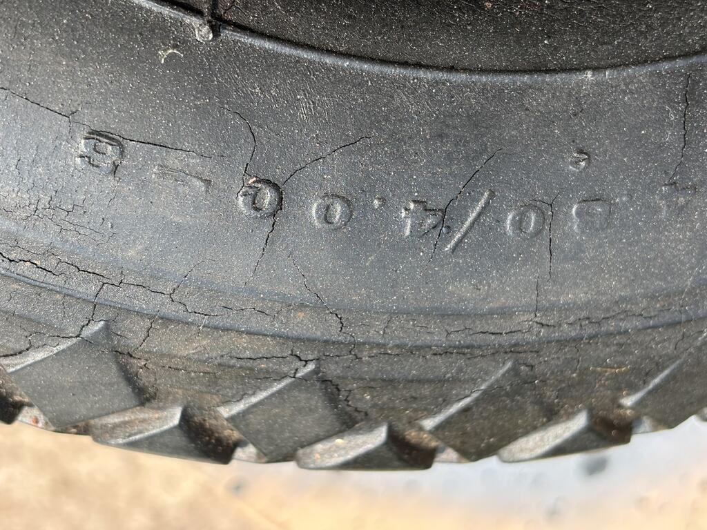

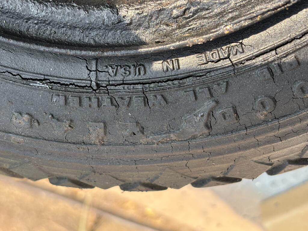

Lane Ranger 12,161 #193 Posted September 5, 2025 I am looking for one good used Goodyear tire like the one in photos. I would like to save this one but it has a lot of cracks after 67 years of use! First pick is of the one i saved from ghe pair! Miller tire paint can only do so much with an old tire! Let me know if you have one to sell with or wothout wheel! ! 2 Share this post Link to post Share on other sites
