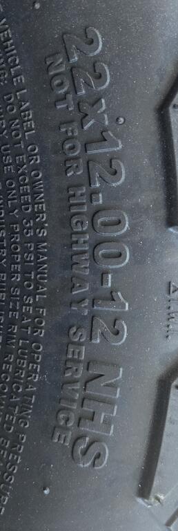

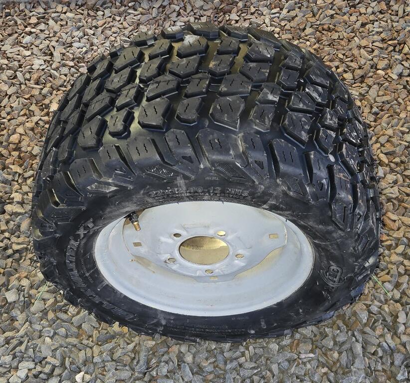

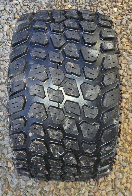

kpinnc 19,037 #230 Posted April 24 An unusual size and tread on these: OTR Grassmaster in 22x12-12 size. Typically used on commercial ZTRs. Actual measurements are 22 inches tall, 11.5 wide. Probably would make true 12 inch width on 10 inch wide wheels. 2 1 Share this post Link to post Share on other sites
ebinmaine 81,053 #231 Posted April 24 53 minutes ago, kpinnc said: OTR Grassmaster in 22x12-12 size. Actual measurements are 22 inches That's good to see. My OTR Lawn Trac are also nearly a full size of the listing. 2 Share this post Link to post Share on other sites
kpinnc 19,037 #232 Posted April 24 3 hours ago, ebinmaine said: That's good to see. My OTR Lawn Trac are also nearly a full size of the listing. The last four tires I've bought were OTR. They are a bit expensive compared to the no name stuff on the jungle site (I've had good luck with those so far as well), but they seem to be very good quality. Time will tell on the longevity of course... But all four of those tires are accurate on sizing. They do measure what is written on the sidewalls. 3 1 Share this post Link to post Share on other sites

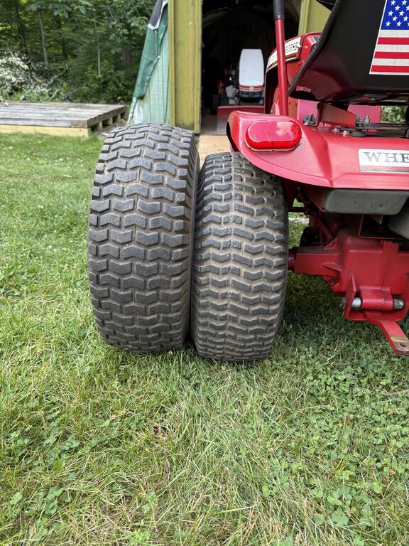

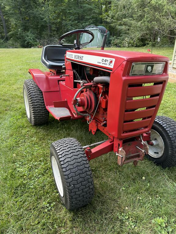

Sparky-(Admin) 26,630 #236 Posted June 29 New C-81 purchase came with 22x7.50’s, would have been 23x8.50’s when new. Amazing how much height diff there is! 4 Share this post Link to post Share on other sites
ineedanother 2,885 #237 Posted June 29 1 hour ago, Sparky said: New C-81 purchase came with 22x7.50’s, would have been 23x8.50’s when new. Amazing how much height diff there is! That might mow grass well with 6" front rims, otherwise maybe not so much. Share this post Link to post Share on other sites
Handy Don 17,634 #238 Posted June 29 (edited) 1 hour ago, Sparky said: New C-81 purchase came with 22x7.50’s, would have been 23x8.50’s when new. Amazing how much height diff there is! And probably almost 5% slower with the 22’s! Edited June 29 by Handy Don 1 Share this post Link to post Share on other sites
Sparky-(Admin) 26,630 #239 Posted June 30 On 6/28/2026 at 10:06 PM, Handy Don said: And probably almost 5% slower with the 22’s! Once I’m done servicing the C-81 it’ll get the new “racing” 23’s 4 Share this post Link to post Share on other sites
ebinmaine 81,053 #240 Posted June 30 10 minutes ago, Sparky said: Once I’m done servicing the C-81 it’ll get the new “racing” 23’s Why don't you quit screwing around and step it right up to a 24. Imagine all that extra speed. 3 Share this post Link to post Share on other sites

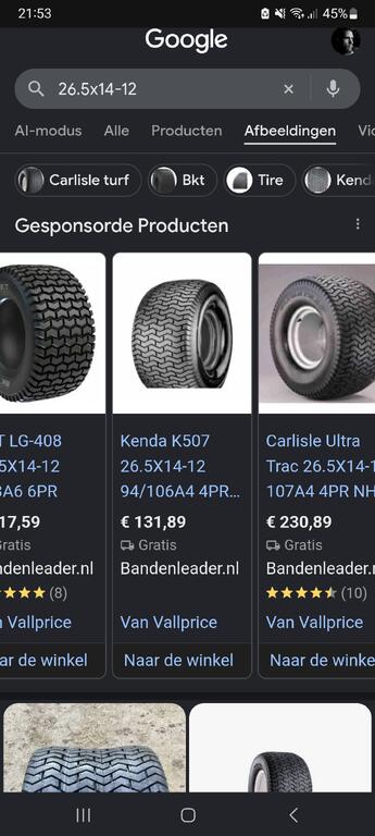

sjoemie himself 3,266 #244 Posted September 7 Soo we had a zero turn (wheel) come in at work with some massive tires on equally massive rims. Was wondering if something like this would fit on a WH. Sure as heck would look cool! Size is 26.5x14.00-12 (will try to take some actual pics and measurements tomorrow). 1 Share this post Link to post Share on other sites
ebinmaine 81,053 #245 Posted September 7 10 minutes ago, sjoemie himself said: wondering if something like this would fit on a WH. Sure as heck would look cool! They'd be super close. If they run small to stamping size they may just fit. Here's my post on 24 x 12 x 12. Share this post Link to post Share on other sites
sjoemie himself 3,266 #246 Posted September 7 13 minutes ago, ebinmaine said: They'd be super close. If they run small to stamping size they may just fit. Here's my post on 24 x 12 x 12. Eric, I've put 26x12-12 on the 512-D with minor seat hightening-adjustemefication.. 24's should fit no problem? 1 Share this post Link to post Share on other sites
ebinmaine 81,053 #247 Posted September 7 1 minute ago, sjoemie himself said: Eric, I've put 26x12-12 on the 512-D with minor seat hightening-adjustemefication.. 24's should fit no problem? My 24s were good. Share this post Link to post Share on other sites

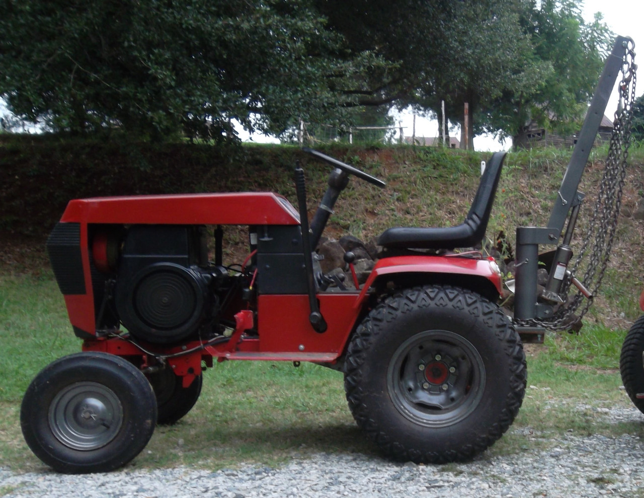

Lee1977 7,808 #248 Posted September 7 (edited) 2 hours ago, sjoemie himself said: Soo we had a zero turn (wheel) come in at work with some massive tires on equally massive rims. Was wondering if something like this would fit on a WH. Sure as heck would look cool! Size is 26.5x14.00-12 (will try to take some actual pics and measurements tomorrow). 312-8 with 25 x 900 x12. 78 and later models have a bar under the back of the footrest. earlier models don't have that bar. The fender bracket, gas tank and fender was raised 1 3/4". Edited September 7 by Lee1977 2 Share this post Link to post Share on other sites

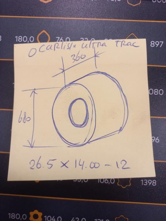

sjoemie himself 3,266 #249 Posted September 8 Some actual measurements on the 'steamrollers'.. Width: 14-3/16" (@29psi) Height: 26-3/4" (@29psi) Rim dia: 12" Brand: Carlisle Type: Ultra Trac Size on tyre: 26.5x14.00-12 1 Share this post Link to post Share on other sites
Handy Don 17,634 #250 Posted September 8 3 hours ago, sjoemie himself said: Width: 14-3/16" (@29psi) Height: 26-3/4" (@29psi) 29psi...isn’t that like driving on wooden wheels?! 1 Share this post Link to post Share on other sites
