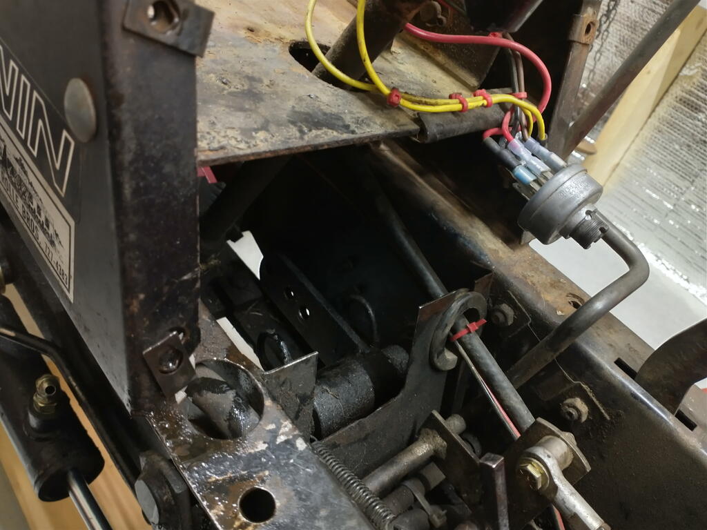

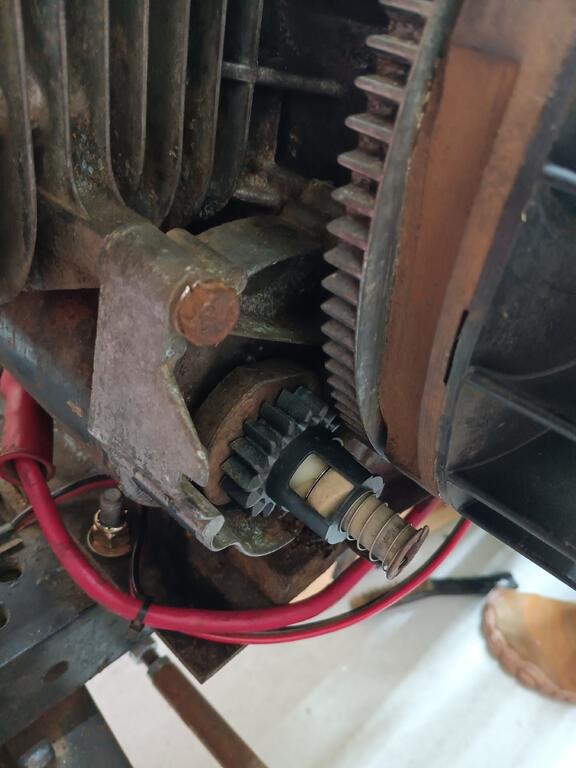

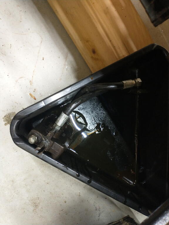

ebinmaine 81,035 #287 Posted June 19, 2025 A few days ago I brought the starter to my local small engine repair shop so they could sell me a replacement gear. While there he offered to "throw it on". In just a couple minutes that was done. Yesterday Trina got the hydro lift valve out. Next will be to clean and rebuild the replacement one and begin reassembly. 2 Share this post Link to post Share on other sites

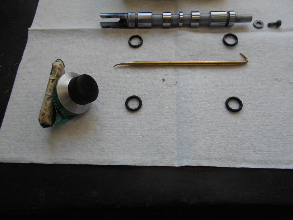

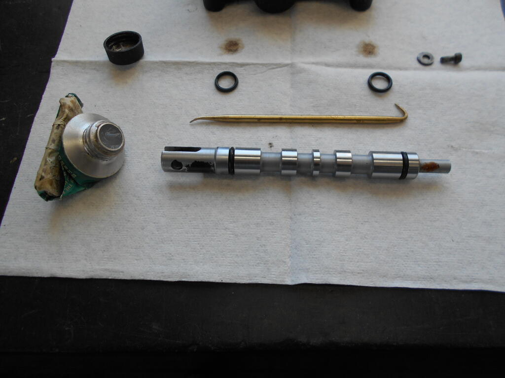

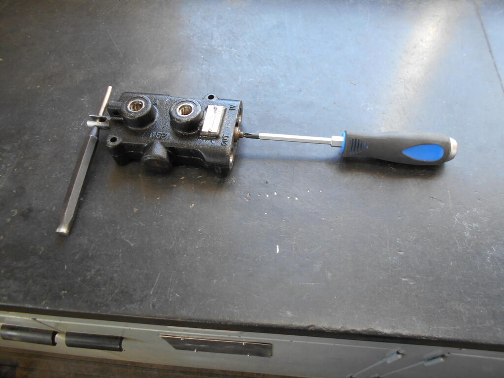

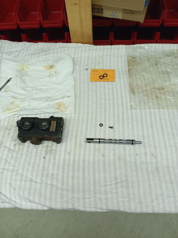

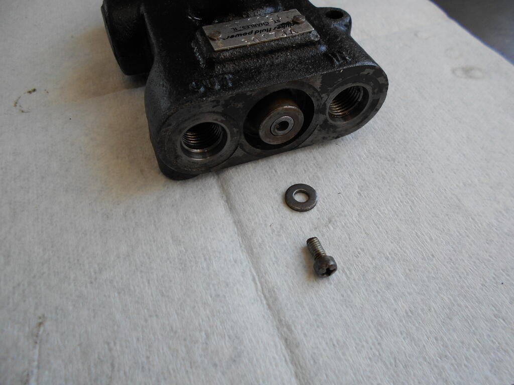

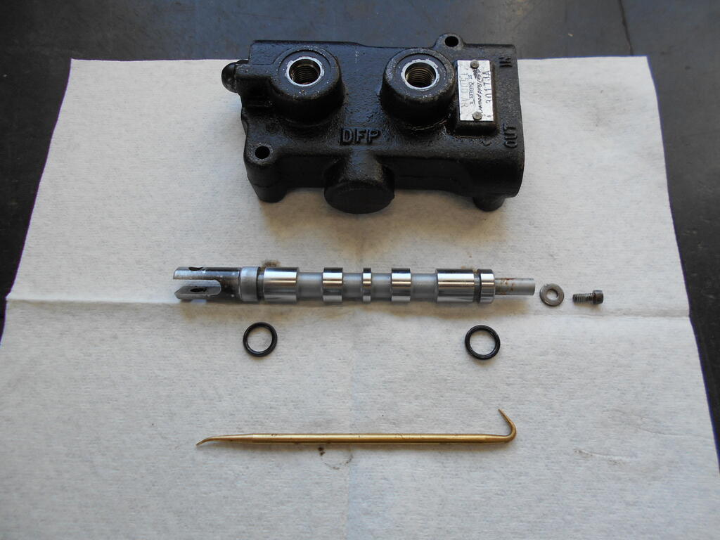

cleat 9,401 #288 Posted June 19, 2025 Here are a few pictures to help Trina out. I remove the single screw on the back of the valve to pull out the control rod leaving the snap ring and springs in place. The rod now should easily pull out the front side of the valve (really easy if the O rings are worn). At this point you can remove the O rings from the control rod. I use a brass pick but just do not scratch the rod. New #111 O rings ready to install. I have used Nitrile in the past but found they can swell and make the valve hard to move so I now use Viton. I lube the O rings with silicone grease then push it back into the valve. Install the screw and washer into the end of the rod and securely tighten. I do not touch the pressure regulator in the valve. Now you can transfer the cylinder hoses to the valve making note of their placement on the valve because if you mix them up the valve will operate backwards (don't ask how I know). The valve hoses use #905 O rings and the supply hoses use #906 O rings. I have never seen a valve fail, just leak due to worn O rings. 1 1 Share this post Link to post Share on other sites

Horse Newbie 7,405 #292 Posted June 22, 2025 On 6/19/2025 at 5:52 AM, ebinmaine said: A few days ago I brought the starter to my local small engine repair shop so they could sell me a replacement gear. While there he offered to "throw it on". In just a couple minutes that was done. Yesterday Trina got the hydro lift valve out. Next will be to clean and rebuild the replacement one and begin reassembly. Don’t mess with that acorn nut ! 1 Share this post Link to post Share on other sites
ebinmaine 81,035 #293 Posted June 22, 2025 30 minutes ago, Horse Newbie said: Don’t mess with that acorn nut ! Oh no no no no no. 1 Share this post Link to post Share on other sites
Horse Newbie 7,405 #294 Posted June 22, 2025 28 minutes ago, ebinmaine said: Oh no no no no no. Handy Don and me were discussing those control valves today at The Big Show. He mentioned to me about not messing with it, unless a person has the skills and tools to reset the pressure adjustment. 1 Share this post Link to post Share on other sites
ebinmaine 81,035 #295 Posted June 28, 2025 Hydraulic valve is rebuilt and reinstalled. 3 Share this post Link to post Share on other sites
Handy Don 17,625 #296 Posted June 28, 2025 When I added two circuits and a pressure relief valve into Clyde (a 520/518 hybrid; Eaton 1100), I was fortunate to find a friend with the tools to run a proper pressure test on the full system. We were able to calibrate both the old and new relief valves per spec in about 10 minutes. Right tools, some skill, and the tractor already largely disassembled made the job straightforward! 1 Share this post Link to post Share on other sites

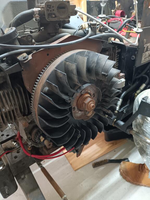

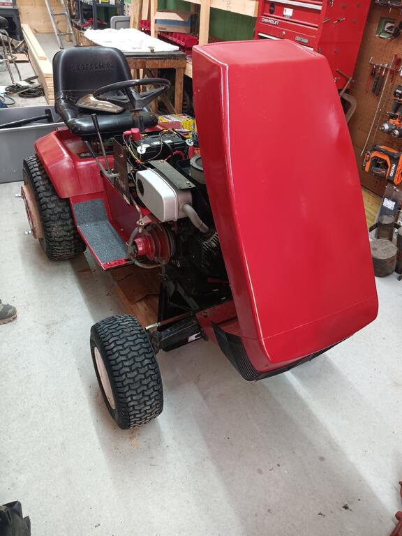

ebinmaine 81,035 #297 Posted June 28, 2025 We got the hydraulic valve back in. Hoses in. Electrical system back in. Battery charging. Starter installed. Flywheel and alternator are all vacuumed out. Flywheel cleaned, wire brushed with a brass brush and cooling fins reinstalled. Engine starts!! 4 Share this post Link to post Share on other sites

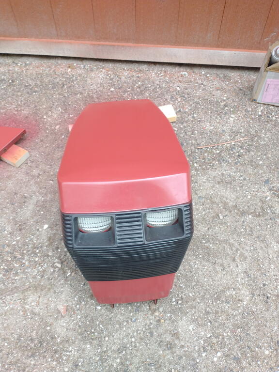

ebinmaine 81,035 #298 Posted June 28, 2025 Left to do: Remove and inspect PTO bearing. Remove hood. Repaint. Add grip tape to steps. Change engine oil. CHECK ALL NUTS BOLTS & PINS FOR PROPER TORQUE. Reattach dash plate and other sheet metal. At delivery: Deck maximum up & down adjustment. Deck level adjustment. 4 Share this post Link to post Share on other sites

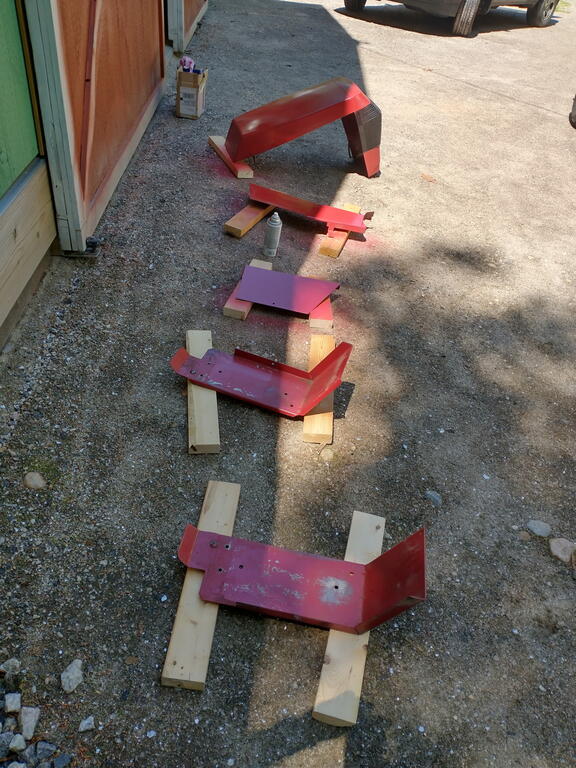

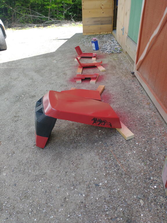

ebinmaine 81,035 #300 Posted June 29, 2025 The BBT aka The Paint Department was right busy today. 1 Share this post Link to post Share on other sites
