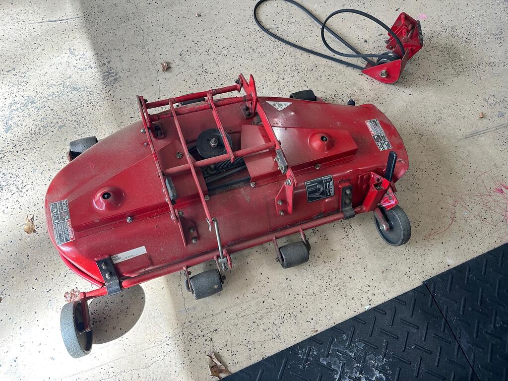

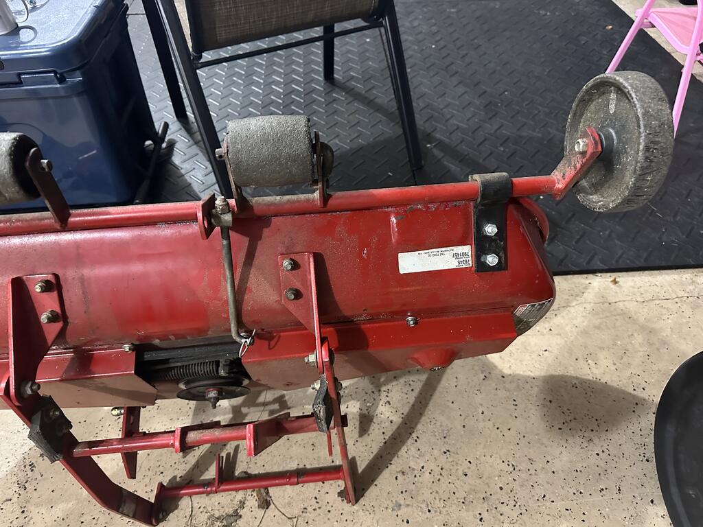

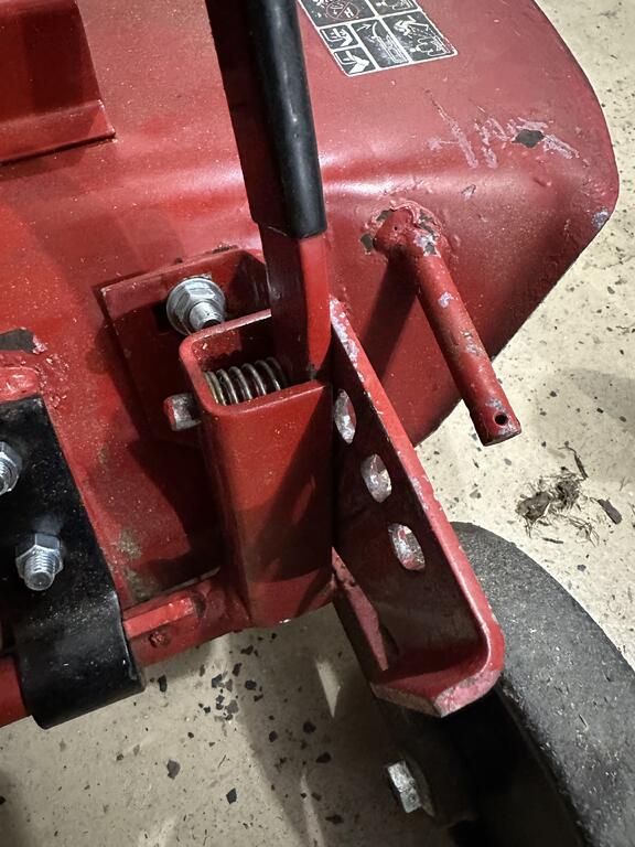

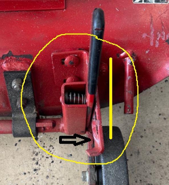

KVustrud 92 #56 Posted October 23, 2023 Pulled the deck off in preparation to put the new blades on when they come (the ones on here are DULL DULL, not worth sharpening). The bracket that holds the deck height adjustment lever is bent outwards some. I need to inspect it closer, but has anyone seen this before? It's almost like I'd need to reinforce the deck where the two bolts run through and mount it. Outside of that, the deck looks to be in fantastic shape. 1 Share this post Link to post Share on other sites

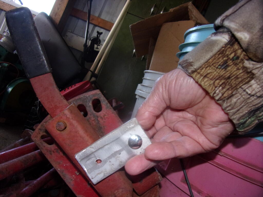

Ed Kennell 47,269 #57 Posted October 23, 2023 1 hour ago, KVustrud said: has anyone seen this before? A very common problem. Yes, a reinforcement plate could work. I have fixed some by drilling a 1/4" hole at each end of the slotted bracket and with a plate inside of the U channel, pulled the assembly back together. BTW, did you check if the Vee notch was installed correctly. 1 Share this post Link to post Share on other sites
KVustrud 92 #58 Posted October 23, 2023 7 minutes ago, Ed Kennell said: A very common problem. Yes, a reinforcement plate could work. I have fixed some by drilling a 1/4" hole at each end of the slotted bracket and with a plate inside of the U channel, pulled the assembly back together. Can you post a pic of this fix please? Trying to envision it.... 7 minutes ago, Ed Kennell said: BTW, did you check if the Vee notch was installed correctly. What exactly are you referring to here? 1 Share this post Link to post Share on other sites

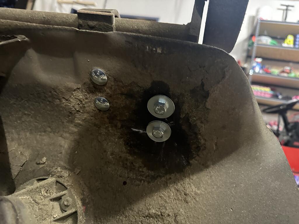

Brockport Bill 2,470 #60 Posted October 24, 2023 my guess is that lift handle has been apart disassembled from mower shell ? -- i suggest you check the shell carefully for fracture lines -- both where the lever handle bracket has bolts that go through to underneath of shell ... as well as the two bolts in black bracket clamp to the left that hold the axle connected to the shell. Those are major stress points n shell -- I also suggest you consider replacing the red screw/bolts that hold the lift height lever bracket to shell and replace with carriage bolts that have the heads underneath the shell.... and have the nuts on the "top" outside of the shell..... that way you avoid the nuts and the bolt threads being underneath the deck on the bottom where the nuts and threads will be damaged and corroded. That problem will be avoided by having the carriage bolt heads "flush" underneath coming up to the top outside of the bracket which is the way the black bracket bolts and nuts were installed. Good luck, Bill 3 Share this post Link to post Share on other sites

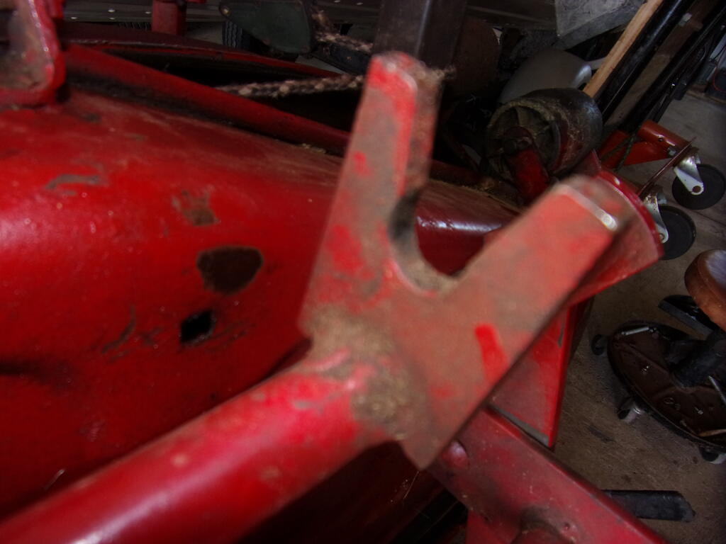

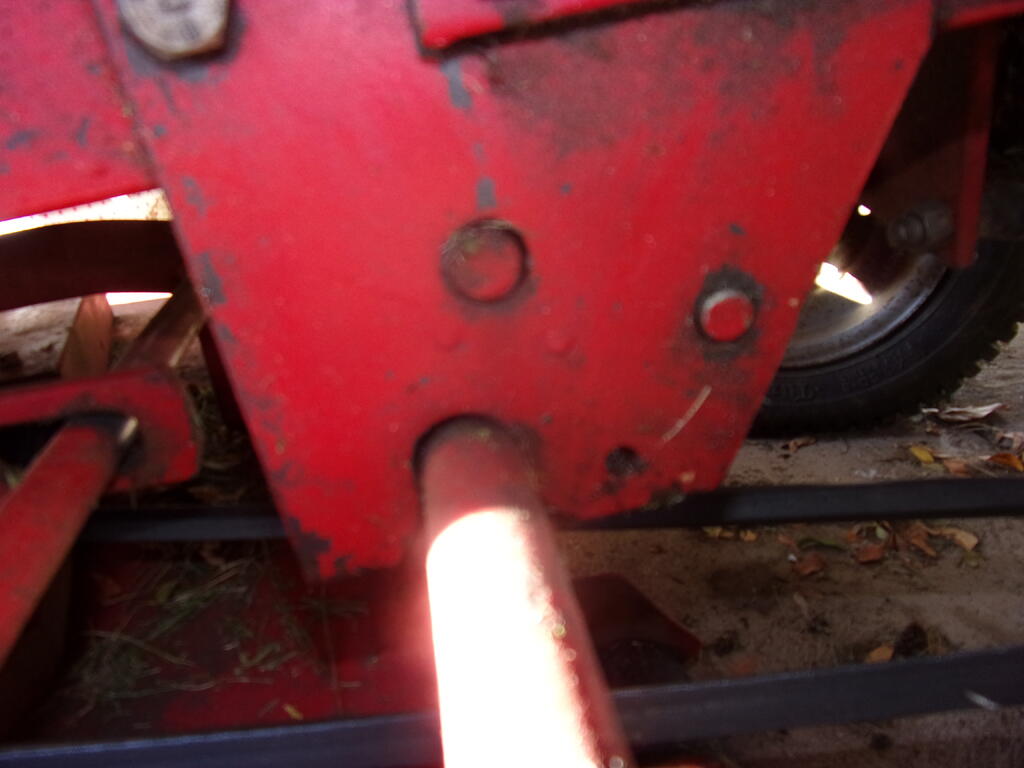

Ed Kennell 47,269 #61 Posted October 24, 2023 22 hours ago, KVustrud said: Can you post a pic of this fix please? Trying to envision it.... I no longer have the decks, but here is the idea. A bar and two bolts to hold the assembly together. The bar would have to be longer of course. In an earlier post you said the front of the deck elevation was not changing when you adjust the rear height gage wheels. I asked you to check if the notch on the front support bar was engaged properly. This is the notched bar that must be hooked on the rear rod on the mid attach-a-matic . The deck will not lift properly if this is not assembled properly. 1 2 Share this post Link to post Share on other sites
KVustrud 92 #62 Posted October 24, 2023 16 minutes ago, Ed Kennell said: I no longer have the decks, but here is the idea. A bar and two bolts to hold the assembly together. The bar would have to be longer of course. In an earlier post you said the front of the deck elevation was not changing when you adjust the rear height gage wheels. I asked you to check if the notch on the front support bar was engaged properly. This is the notched bar that must be hooked on the rear rod on the mid attach-a-matic . The deck will not lift properly if this is not assembled properly. Got it, thank you for the images! I figured out the front of the deck leveling, the screw adjustment was all the way up on the knob. 2 1 Share this post Link to post Share on other sites

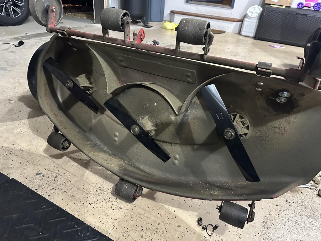

KVustrud 92 #63 Posted October 25, 2023 19 hours ago, Brockport Bill said: my guess is that lift handle has been apart disassembled from mower shell ? -- i suggest you check the shell carefully for fracture lines -- both where the lever handle bracket has bolts that go through to underneath of shell ... as well as the two bolts in black bracket clamp to the left that hold the axle connected to the shell. Those are major stress points n shell -- I also suggest you consider replacing the red screw/bolts that hold the lift height lever bracket to shell and replace with carriage bolts that have the heads underneath the shell.... and have the nuts on the "top" outside of the shell..... that way you avoid the nuts and the bolt threads being underneath the deck on the bottom where the nuts and threads will be damaged and corroded. That problem will be avoided by having the carriage bolt heads "flush" underneath coming up to the top outside of the bracket which is the way the black bracket bolts and nuts were installed. Good luck, Bill Done! And you were right, old bolts and nuts were so rough I had to cut them out! Got a good bit done tonight! 1 Share this post Link to post Share on other sites
