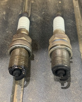

JoeM 9,279 #1 Posted October 6, 2023 Working on a friends machine today, removed the spark plugs and they were pretty bad. Briggs ans Stratton brand. I have seen these before and have not been to lucky because it seems they are always needing replaced. Usually use Champion, pretty much work good and are decently priced. Plus, Champs are a throw back to my drag car days. Whats your poison, and why? Anyone using those fancy new ones? Like E3 3 Share this post Link to post Share on other sites
953 nut 62,960 #2 Posted October 6, 2023 The one on the left looks like it is oil fouled. I have always been an advocate of Champion Spark plugs too. 2 Share this post Link to post Share on other sites

RED-Z06 2,689 #6 Posted October 7, 2023 Its hard to read a plug unless you know how the engine was previously ran. If an engine is cold started and idled the plugs will usually be black because they'll never heat up enough idling. Part throttle same way..not enough heat. When im reading a plug to check the engines tune ill try to get it up to full speed for at least a couple minutes and put a load on it for at least a minute, then cut it off at that point. If you idle it down, you dont get a good read. 1 Share this post Link to post Share on other sites

JoeM 9,279 #9 Posted October 7, 2023 13 hours ago, 953 nut said: The one on the left looks like it is oil fouled yep, thinking the valve seal is going bad. This machine is one with 801 hours. The leak down was near perfect. There has been issues with I think running lean. The muffler has been overheated and burned out. Someone was working on it but I am not sure what all was done, other than messing up the carb linkages. and carb bolts loose. It would only come up to 2500 rpm. The carb had dirt issues for sure. low speed jet seemed like it was not working at all. cleaned up and adjusted the linkage and it runs pretty good, but noisy. It is getting an FEL transplant and I think it will run fine other than the muffler. Just a little back ground on this animal. 12 minutes ago, ebinmaine said: An auto parts sales rep once explained to me that Champion tried to consolidate a few heat ranges to save production costs Wonder if Champ made the Briggs plugs? 1 Share this post Link to post Share on other sites
