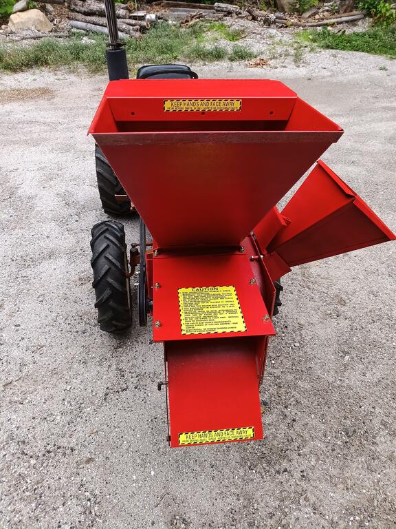

ebinmaine 80,088 #76 Posted June 25, 2024 5 minutes ago, sqrlgtr said: I may have missed it but is that regal red paint? Rust-Oleum 2x Apple Red Gloss. It's a little brighter red than the Wheel Horse colors. Same color as My 1975 C160 Automatic. It's actually a pretty close match to one of the colors Mackissic used on their own equipment. 1 Share this post Link to post Share on other sites

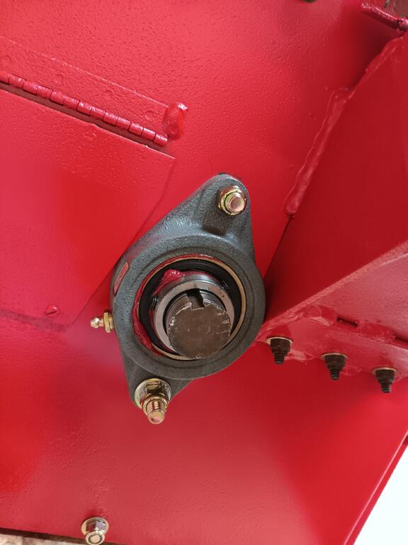

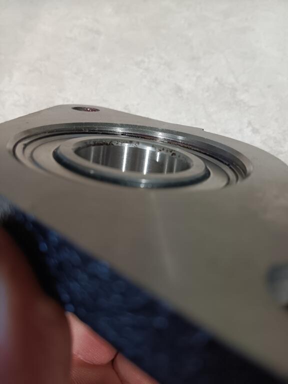

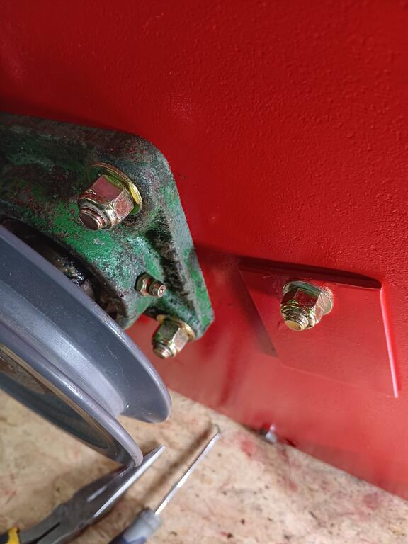

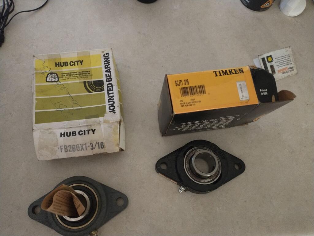

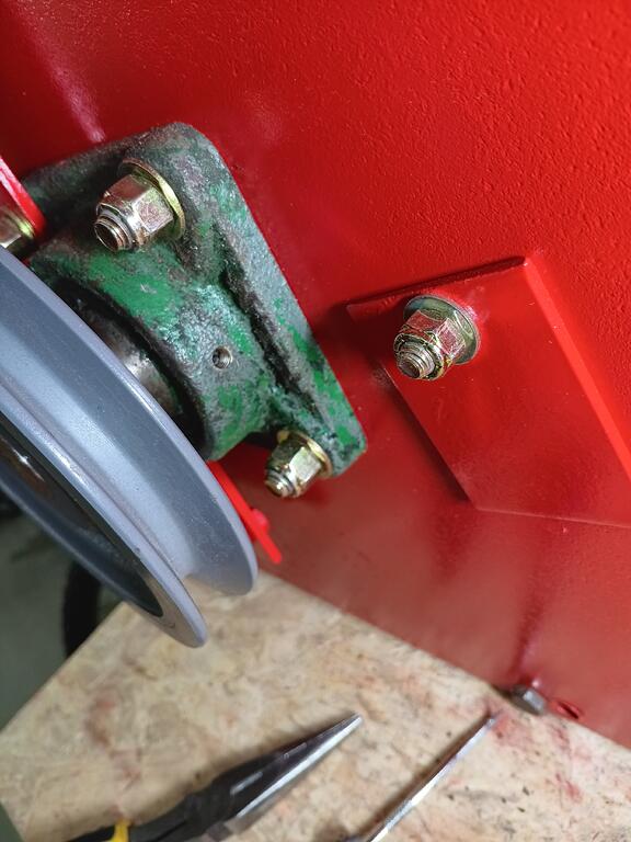

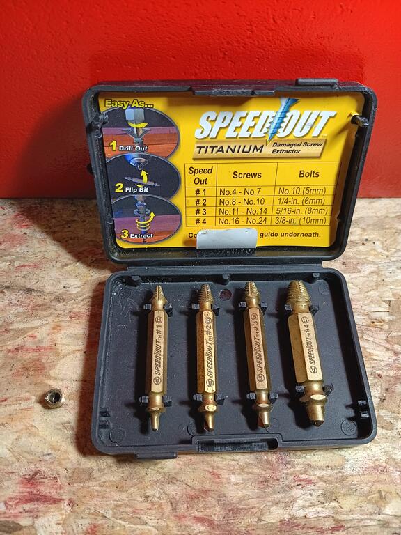

ebinmaine 80,088 #77 Posted July 2, 2024 I got a few minutes to get back into this bearing swap today. Here's the two I ordered. The one on the left is what I knew I needed. The right side is a different brand and part number but appeared usable. Curiosity got the better of me so I wanted to see it. Both are USA made New Old Stock. Good thing I got two... because one was bad. Possible shipping damage. ? See how the inner bearing is knocked outta plane... I unbolted the side again and removed the bad (old) bearing. Got it all bolted back together. Then I adjusted the side chipper anvil. 1/16" clearance. Added grease to the replacement bearing. Went to grease the oldest bearing... (original green paint??) But the grease zerk was broken. I knew that but had forgotten. I found a set of ez outs last year. Put them to work. I'll stop by the hardware store next chance I can. 1 Share this post Link to post Share on other sites
gwest_ca-(File Mod) 12,417 #78 Posted July 2, 2024 That is a self-aligning bearing. The outside is spherical so you could turn it 90 degrees in the housing to remove it. If the mounting locations on each side were not identical a straight shaft would align the bearings to operate correctly. 1 Share this post Link to post Share on other sites
ebinmaine 80,088 #79 Posted July 2, 2024 1 minute ago, gwest_ca said: That is a self-aligning bearing. The outside is spherical so you could turn it 90 degrees in the housing to remove it. If the mounting locations on each side were not identical a straight shaft would align the bearings to operate correctly. Quite true for a normal operating unit. This one was unwrapped and bone dry when it arrived. It has some surface rust on the outside and the rotation of the bearing feels rough. It won't take grease and won't straighten. Unfortunately it appears this one's been stored dry too long and damaged beyond use. Share this post Link to post Share on other sites
Handy Don 17,197 #80 Posted July 2, 2024 19 minutes ago, ebinmaine said: Unfortunately it appears this one's been stored dry too long and damaged beyond use. If you are unable to return it, I’d consider dosing with penetrant and letting it sit for a few weeks and if it comes free, dose it with a light machine oil so you can exercise it while feeling for significant bearing issues. It might be handy, if you can revive it, as a backup spare. 1 Share this post Link to post Share on other sites

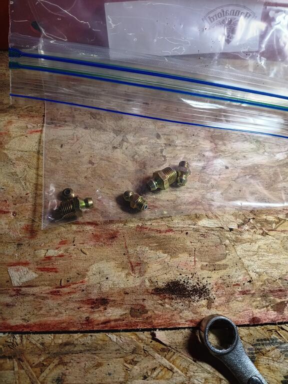

ebinmaine 80,088 #82 Posted July 2, 2024 I stopped by the hardware store and grabbed some new grease zerks in 2 sizes. I know there's some larger ones around here but these are always welcome as spares. New fitting in place. Extra dose of nice new red grease. I over filled it while rotating the shaft so the old gunk would be emptied as much as possible. 1 Share this post Link to post Share on other sites

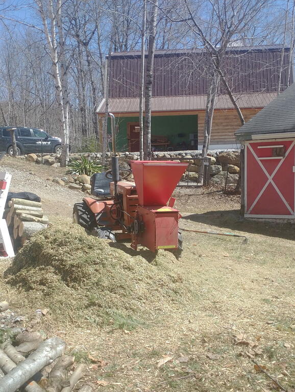

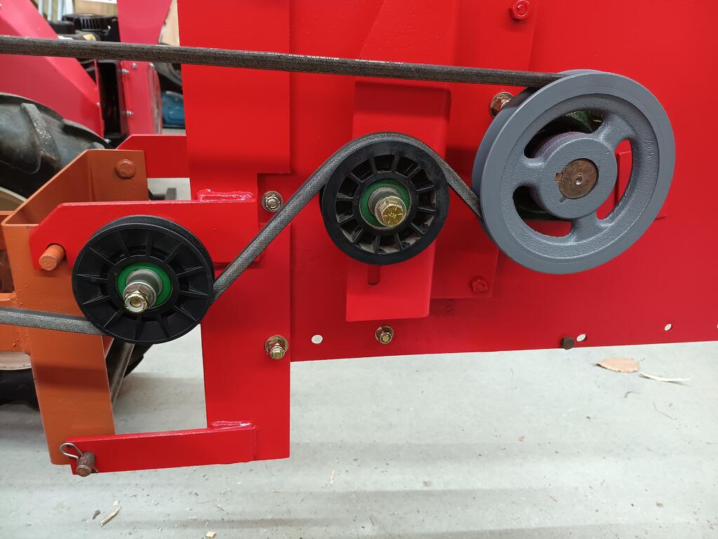

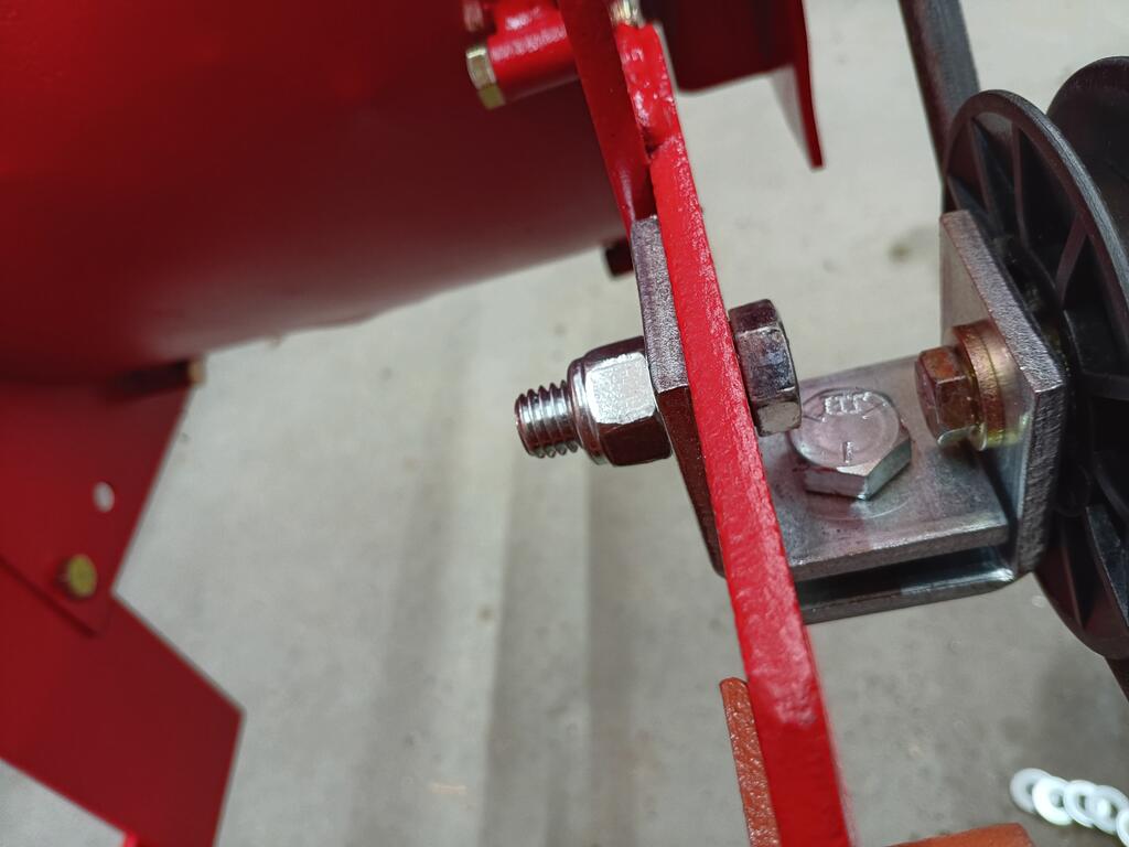

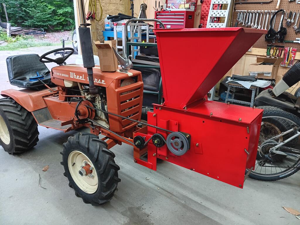

ebinmaine 80,088 #83 Posted July 4, 2024 Here's what I came up with for an idler setup. I used L brackets I'd ordered for the Two Stage Tall Chute snowblower last year. I pulled the digital tach out and checked the engine upper RPM limit. It was set quite low. I knew it getting quiet. 5 years ago I had it just over 3000 RPM. This morning it was at about 2500, 2600. Didn't really matter not having any engine driven implements on. I corrected that. Engine RPM max: Unloaded. 3300, 3325 Chipper engaged. 3275, 3295 Chipper RPM. 2475, 2500 Chipper could be a couple hundred rpm higher but we'll test it this way and see how it does. Likely leave it. I put all the decals on this morning. 6 Share this post Link to post Share on other sites

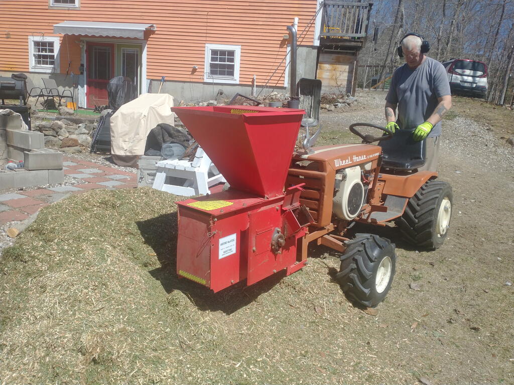

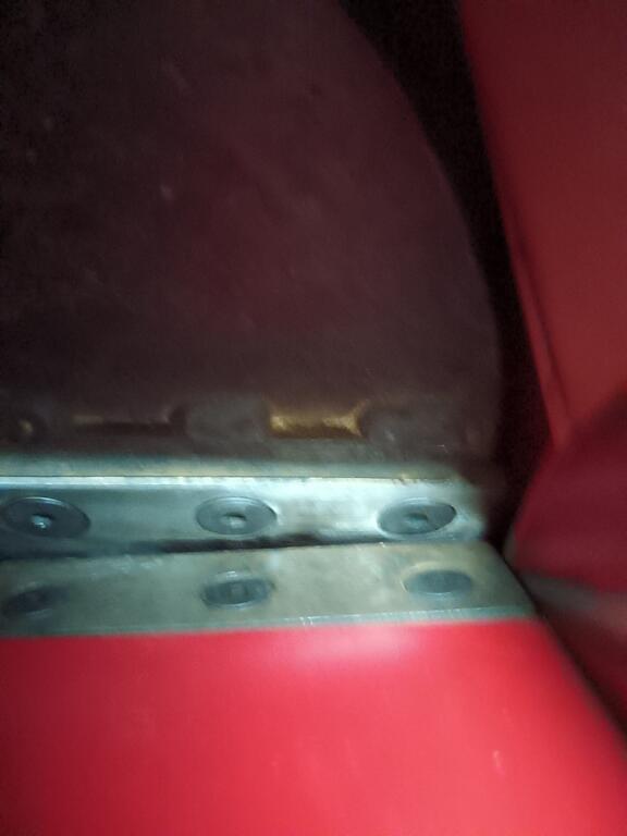

ebinmaine 80,088 #87 Posted April 11 We've been giving this ole beast some serious exercise lately. Time to adjust the belt and side knife plate already. 1 Share this post Link to post Share on other sites

peter lena 9,993 #90 Posted April 12 @OoPEZoO looking right at it ? first flat belt idler pulley after chipper blade set up ? would bet its lubrication heat / stress , failure ! self explanatory , tiny sealed bearing , unknown lube , violent incremental bearing / belt stoppage, starts the typical BELT WAVE OF RELATED STOPAGE . look up a similar pulley with a , larger bearing , with wide rubber side grease shields , carefully remove shields , small pocket flat screwdriver , small flat putty knife , wipe out . carb cleaner flush , lucas x-tra HD green chassis grease ? hand pack , 550 deg flash point , polyurea rated , stays with bearing , all my decks , pto,s , related , long past failures , were ELIMINATED with this lube , you know what doesn't work , make the change , would also plan a mod to long unsupported , belt runs , that heavy loading power wave , is showing you the way . looks like a basic fix to me , pete 1 Share this post Link to post Share on other sites
ebinmaine 80,088 #91 Posted April 12 20 hours ago, ebinmaine said: adjust the belt 38 minutes ago, peter lena said: @OoPEZoO looking right at it ? first flat belt idler pulley after chipper blade set up ? would bet its lubrication heat / stress , failure ! self explanatory , tiny sealed bearing , unknown lube , violent incremental bearing / belt stoppage, starts the typical BELT WAVE OF RELATED STOPAGE . look up a similar pulley with a , larger bearing , with wide rubber side grease shields , carefully remove shields , small pocket flat screwdriver , small flat putty knife , wipe out . carb cleaner flush , lucas x-tra HD green chassis grease ? hand pack , 550 deg flash point , polyurea rated , stays with bearing , all my decks , pto,s , related , long past failures , were ELIMINATED with this lube , you know what doesn't work , make the change , would also plan a mod to long unsupported , belt runs , that heavy loading power wave , is showing you the way . looks like a basic fix to me , pete On this particular application I have two options. A. Replace the idler pulley with a larger one. B. Larger (wider) belt. Yesterday between the sessions of chipping I adjusted the belt but found it is maxed out. I could also move the idler down so it's making a longer reach but that has potential problems involving the axle. The existing belt is 1/2 x 86. I've ordered a 5/8 x 88. More to come... 1 Share this post Link to post Share on other sites
