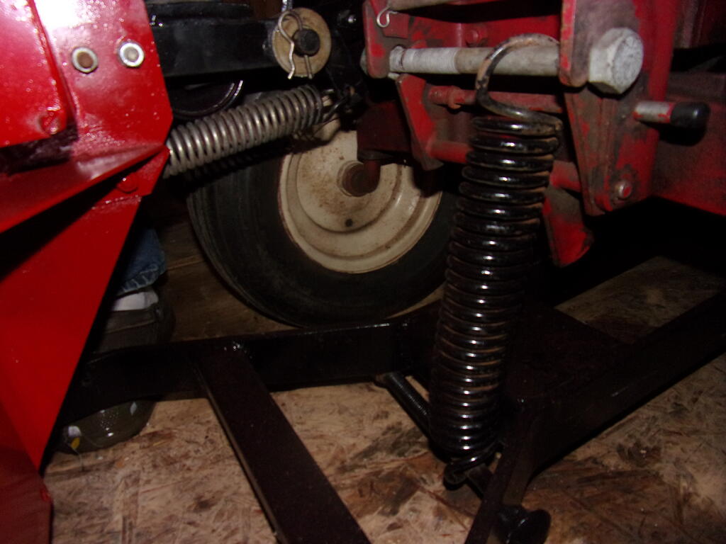

Ed Kennell 41,776 #6 Posted September 27, 2023 The two springs that came with my Bervac daully were too much lift. The blower actually floated. I went to one spring so I had some down force . These are some heavy springs that are attached to the front A-O-Matic. Back in the day, I had a single blower on C-120 with manual lift. I had 3 springs on the flag to the mid A-O-Matic. This floated the blower and I could lift it with 5-10 lbs. of pull. 2 1 Share this post Link to post Share on other sites
Ed Kennell 41,776 #7 Posted September 27, 2023 (edited) 1 hour ago, lynnmor said: reduces stress on various components. It is not just about the operator. With the proper springs, you can easily cancel out 70-90% of the blower weight greatly reducing the strain on the lifting components...man and machine. Edited September 27, 2023 by Ed Kennell 4 1 Share this post Link to post Share on other sites

Racinbob 11,916 #9 Posted September 27, 2023 Back when I was young and dumb I never bothered with the lift assist spring for either the blower or tiller. I never thought about the stress on the tractor (just under the lift arm). This was the results. I would guess I did that repair in the 80's. Now I'm older, I'm still dumb but much weaker I use the spring and lifting the blower is a piece of cake. It would have prevented the need for the repair. I don't have a two stage but the results would be the same. # 4629 Spring with Eye Bolt Toro Wheel Horse Tiller and Snow thrower - Wheel Horse Parts and More 2 1 Share this post Link to post Share on other sites

lynnmor 7,788 #12 Posted September 27, 2023 The 4629 spring mentioned above is heavier than garage door springs and are hard to source other than the mentioned vendor. 2 Share this post Link to post Share on other sites
