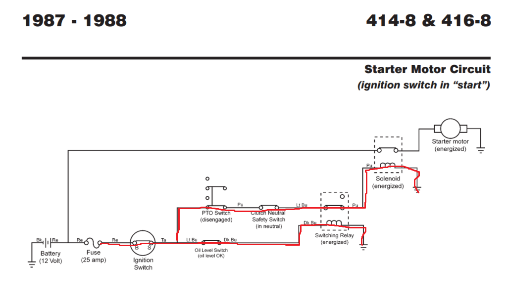

squonk 45,805 #3 Posted September 22, 2023 Wiring diagram of the starter motor circuit. The fuse is after the power feed to the starter itself. Check your safety switches for dirt/grass shorting across terminals ect. Share this post Link to post Share on other sites
953 nut 64,646 #4 Posted September 23, 2023 (edited) 20 hours ago, Skwerl58 said: The starter bendix on my 87 414-8 had been getting loud so I tried to clean it and use dry lube to improve it while it was still on the motor. I sprayed brake clean up to the corner from the cover and also a blast from the top of the starter . If the bendix is making loud noises it probably needs to be replaced. Why did you use Brake Clean? Brake cleaner can be harmful to plastic, rubber, electronics, and painted parts. It turns out some of these components can be dissolved by brake cleaner so it should only be used on brake components or other bare metal components you're looking to clean. After a bit I shot some dry lube from the top to the bendix and now it is blowing fuses when I turn the key. Is the fuse blowing when in the ON position or only in the START position? As you can see on the drawing Mike supplied there is no fuse in the starter circuit. What components did the brake cleaner get onto other than the bendix? Is the 25 amp fuse the one that is blowing? When a fuse blows it is likely that a component or wire being protected by the fuse is shorted out to ground.. You may have melted the insulation on a wire near the starter, need to inspect all of the wires that may have been sprayed. Edited September 23, 2023 by 953 nut fat finger 1 Share this post Link to post Share on other sites
squonk 45,805 #5 Posted September 23, 2023 If the 25 Amp fuse is blowing, Check the wires and components highlighted in red. Share this post Link to post Share on other sites

squonk 45,805 #7 Posted September 23, 2023 The starter is not blowing your fuse. It still may be bad, but you need to find the cause of the higher than normal amp draw on the control circuit I highlighted. There could be a problem with the safety switches themselves (if they are even in the circuit anymore) or the solenoid 2 Share this post Link to post Share on other sites
lynnmor 8,683 #8 Posted September 23, 2023 3 hours ago, squonk said: The starter is not blowing your fuse. It still may be bad, but you need to find the cause of the higher than normal amp draw on the control circuit I highlighted. There could be a problem with the safety switches themselves (if they are even in the circuit anymore) or the solenoid Since it is the 15 amp fuse, you need to add that 15 amp circuit to the above wiring diagram. If the 15 amp circuit is pulling high amps perhaps the battery cable isn’t carrying the full starter load then some of it might be loading the 15 amp circuit. Checking the tightness of a connection is not enough, the connection should be disassembled and cleaned. 1 Share this post Link to post Share on other sites
