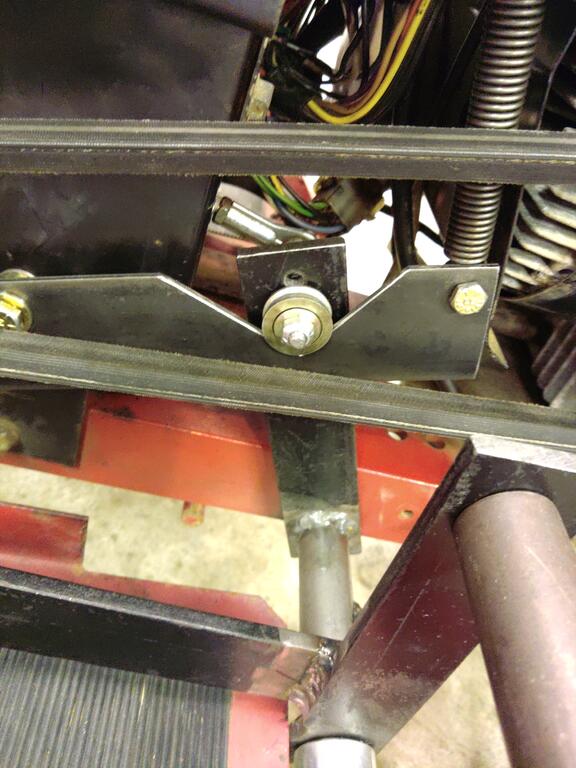

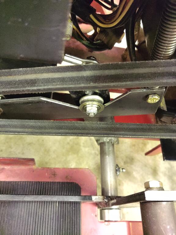

The hole positions you mention might have some effect but it’s tough to determine exactly. The trick is managing the intersection of the arc traced by the follower with the arc at each point of the V as the follower moves. You might just want to post some measurements for the full forward and reverse positions as well as the neutral position. Then its just arithmetic!
Neutral center to center is 4 1/8".  Full forward is 5" center to center.  Reverse is 3 1/2" center to center.  Thanks for the help.  I'm terrible at math.
Handy Don
Distance from return arm pivot to the center of the V? Width of the V?
Edited by Handy Don
Bill D
Pivot to center of the V is 4 1/4".  Width at the top is 2 3/4".
Bill D
I'm thinking that moving the pivot point to the bottom would probably make things worse?
Edited by Bill D
Handy Don
It looks like you moved the pivot up to get it away from the belt but kept the two arms very close to perpendicular to each other when the follower is at neutral. Good!
If you are satisfied with the performance of this setup for getting forward motion and having it return to center effectively, then IMHO adjusting the slope of the reverse side of the V shallower (a bit at a time) is the easiest way to get close to the same performance for reverse.
Will that return control arm be strong enough to not bend at the point of the V?
Bill D
I think making the reverse side shallower is probably the best way to go.  If I cut carefully it shouldn't hurt the strength of the return arm at the vee.  It's 1/8" steel, about 1/2" from the bottom of the vee to the edge.

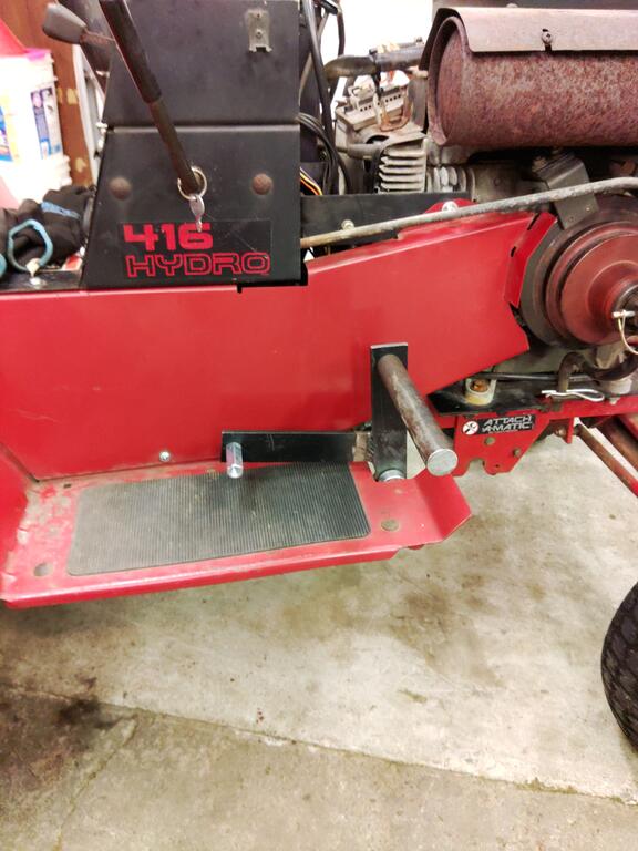

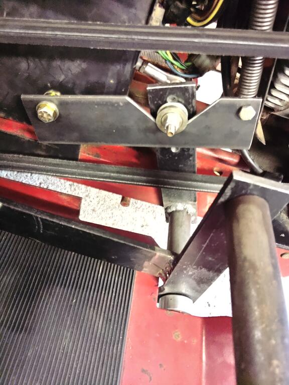

Well I think it's done.  Going to try mowing with it this week then I'll break it down and paint it at some point.  I widened the vee in return arm about 3/8" at the opening by cutting the reverse slope on the return arm.  This made for a more gentle angle on the reverse slope.  Seems to have evened out the pedal pressure and total deflection of the return arm from forward to reverse.
One minor detail I'd ike to mention for anyone thinking of copying my design; there is a nylock nut on the pivot bolt inside the hood stand (fun to install ).  This effectively double nuts the pivot bolt to prevent it from loosening in the hood stand
The best part about this design is that it required no drilling or cutting to install.  Just thread the prepunched hole in the hood stand for the pivot bolt.
