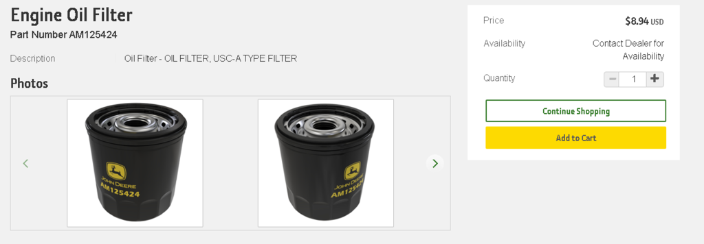

JoeM 8,271 #29 Posted September 19, 2023 checked local JD dealer here, good price and closer than the farm store Share this post Link to post Share on other sites

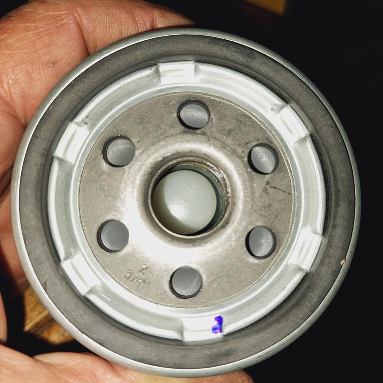

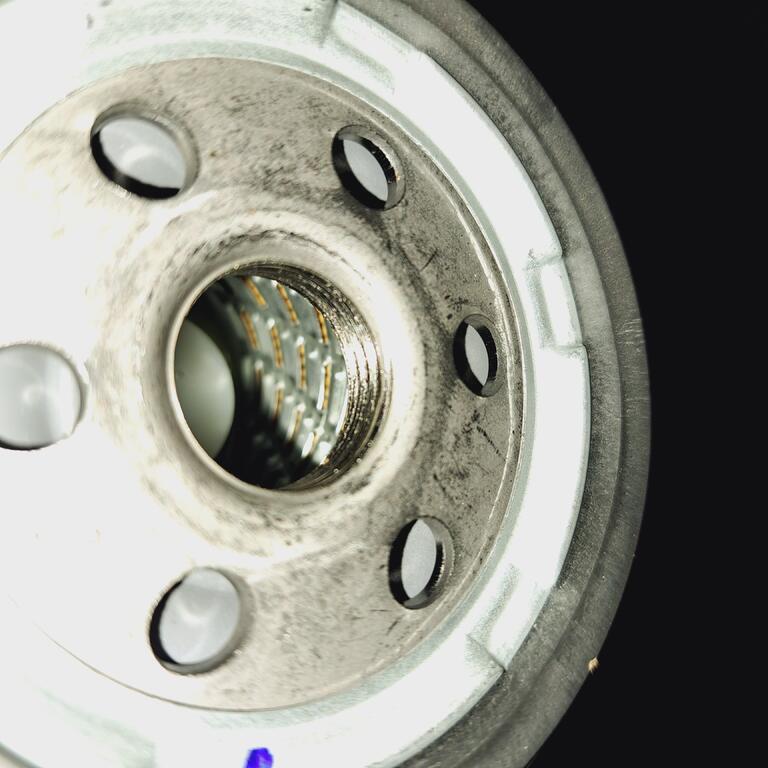

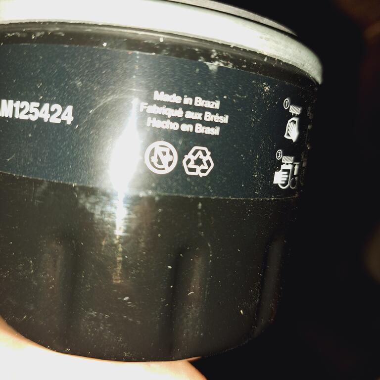

WHX?? 51,682 #31 Posted September 20, 2023 (edited) Here we go Joe oem JD ... no idea if this has a by pass or not. Not sure how to tell. Can tell you where it was made tho... not exactly Horicon or Moline USA... Edited September 20, 2023 by WHX?? 1 Share this post Link to post Share on other sites

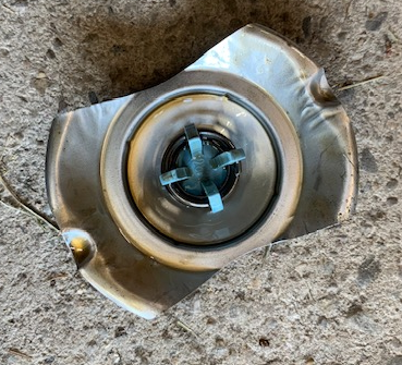

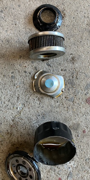

JoeM 8,271 #32 Posted September 20, 2023 20 hours ago, WHX?? said: no idea if this has a by pass or not. Not sure how to tell. I had the old OE JD filter in the drain pan and cut r open. Yep, that is the bypass valve, not much media tho. 1 Share this post Link to post Share on other sites
WHX?? 51,682 #33 Posted September 20, 2023 Thanks Joe was going to do just that so saved me the trouble. Yes not much for media there . Next time may consider the longer one Squonky mentioned. 1 Share this post Link to post Share on other sites
bds1984 1,497 #34 Posted September 21, 2023 That is an awfully short filter! My 315-8 came with one on it very similar to that. I cannot go too much longer as there will not be enough clearance which may be the case for others. I can fit a Purolator PL 10241 filter just fine but nothing longer. If one really wants to up their game, they can use a remote filter like many Cubs do. I put one on the M18 that is on my 520H and can easily run the Purolator PL3001/Motorcraft FL1A/Fram PH8A size but I currently have a Purolator PL20195 from when I had a Thunderbird SuperCoupe. There is a lot we can run for filters if we know what to look for. Share this post Link to post Share on other sites
