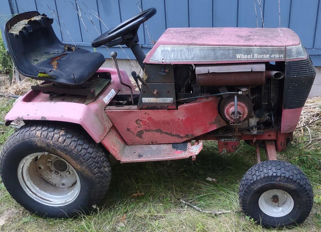

JWog23 16 #1 Posted September 18, 2023 After a few years the 416h made it back. Looking forward to fixing it up 4 2 Share this post Link to post Share on other sites

Sparky-(Admin) 23,196 #7 Posted September 18, 2023 New seat and get the mechanicals straight is all it needs right now. Worry about paint and decals down the road. Good luck with it 2 Share this post Link to post Share on other sites
lynnmor 7,833 #8 Posted September 18, 2023 Spray penetrating oil on all fasteners whenever you walk past it, this is especially needed on ALL of the Onan fasteners. Ask me how I know. 1 Share this post Link to post Share on other sites
ebinmaine 72,826 #9 Posted September 18, 2023 7 minutes ago, lynnmor said: Spray penetrating oil on all fasteners whenever you walk past it, this is especially needed on ALL of the Onan fasteners. Ask me how I know. That's excellent advice. I would also add that you should try to TIGHTEN every bolt before you loosen it. Just a tiny bit. Share this post Link to post Share on other sites
