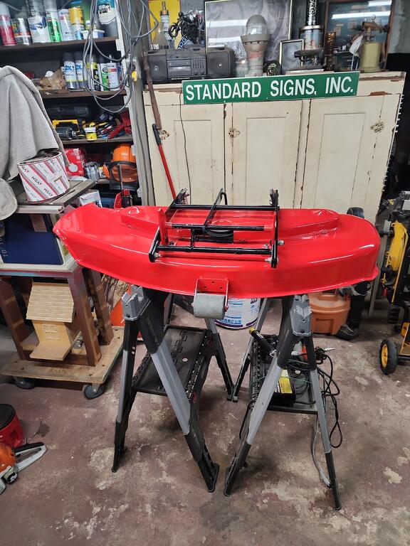

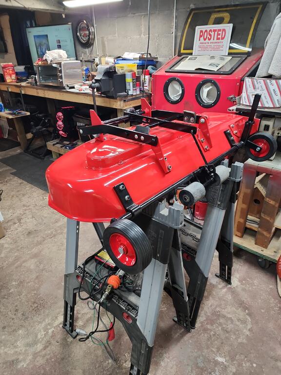

c100rider 154 #4 Posted September 20, 2023 The year tractor i have is a 74. Its a 42inch side discharge. I stripped the whole deck and rebuilt everything including the spindles. I was able to mow my yard a handful of times when I accidently hit a rock and now one of my outside spindles is messed up. I haven't examined it yet but I think I want a stronger spindle housing and guts. Besides, blades are hard to come by from my research Share this post Link to post Share on other sites
