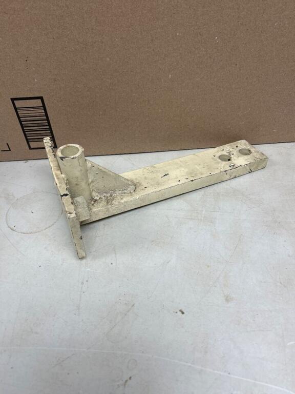

squonk 45,630 #3 Posted September 17, 2023 If you can get the pin out of the slot hitch and trans you can replace it with this 1 Share this post Link to post Share on other sites
Pullstart 68,986 #4 Posted September 17, 2023 You might be able to find something like this to fit in your slot hitch too. 2 Share this post Link to post Share on other sites
Kirby216 7 #5 Posted September 17, 2023 Is the modified bracket stronger than a a true brinly or just an easier way to adapt to newer attachments? 1 Share this post Link to post Share on other sites
squonk 45,630 #6 Posted September 17, 2023 1 hour ago, Kirby216 said: Is the modified bracket stronger than a a true brinly or just an easier way to adapt to newer attachments? The adapter tends to hang the attachment out farther creating extra load on the hitch and lift system 1 Share this post Link to post Share on other sites
Handy Don 16,022 #7 Posted September 17, 2023 1 hour ago, Kirby216 said: Is the modified bracket stronger than a a true brinly or just an easier way to adapt to newer attachments? IMHO, the slot adaptor combo is arguably weaker but not by much, really. It extends out about the same distance from the tractor but positions the sleeve a bit higher (1-2”?) when it’s level to the ground. I am running a slot hitch and drawbar on my 854 and picked up an adaptor so I can use either type of implement. I am not planning high-stress work like soil plowing or “pulling”. Ultimately, for you it’ll depend a lot on what implements you have or are buying. Share this post Link to post Share on other sites
