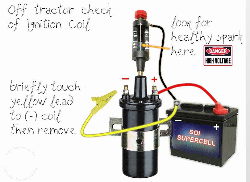

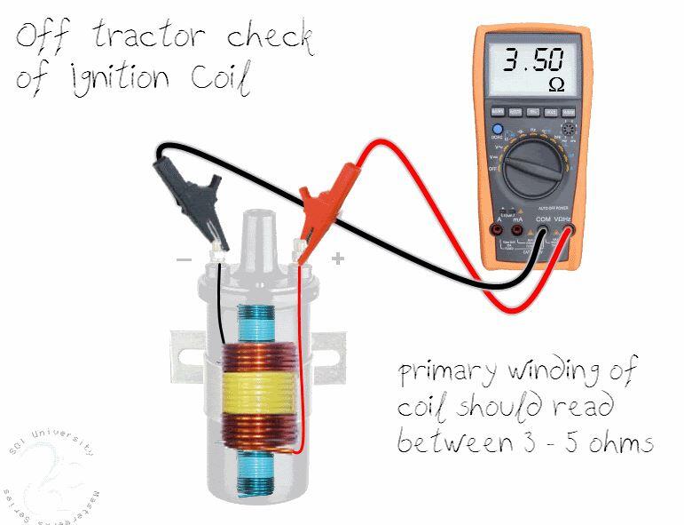

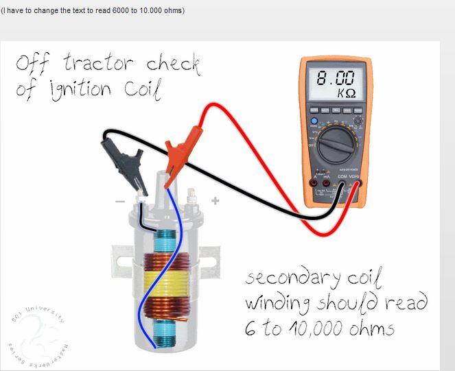

DarylJ 49 #8 Posted September 13, 2023 One problem solved, and another pops up! First, the no crank issue: Checked the wire backside of the ammeter. Nice and snug. Next was to check the safety switches…..discovered the problem in a PTO switch terminal not getting good contact. Once cleaned, the engine cranked! As this tractor had been sitting for three years in an outside shed, I shouldn’t be surprised. BUT, once the no-cranking issue gets resolved, a second problem arises: I now find there is no spark! What I’ve done thus far to troubleshoot: First was to check the points gap and scuff them with abrasive cloth. Still no spark. Next was to switch out the condenser. Still no spark, but the replacement condenser could be questionable, as it did come from the original running engine which had been sitting the past three years. So, not ruling out the condenser yet until I can find a NOS Kohler condenser. Or, is there a diagnostic test I can do on the condensers? I do have a capacitance meter here, but not sure what the acceptable reading range would be for a condenser. What is acceptable? Putting the condenser aside until I know how to check it for being defective or not, the coil was next on the list. Here is what I have done: First, there is voltage to the + terminal, 26 volts on my analog meter. Not sure what that should be, but perhaps the voltage regulator is responsible for the reading. Isn’t 26 volts a high reading for a 12v system? Regardless, there is voltage to the + terminal. Next, checked the resistance (ohms) at the coil with the multimeter. Multimeter positive probe went to the spark plug wire terminal of the coil and the negative to the engine block. 4 ohms shown. This coil had been sitting unused for many years bolted to the replacement engine. Out of curiosity, I also checked the coil on the engine I had pulled. Here, the coil read 13 ohms. This coil had sitting for 3 years on the engine just pulled from the tractor. Are both readings within acceptable range, or should I go with one instead of the other due to the disparity in these resistance readings? As my old Wheel Horses have been very reliable (have a half dozen of them) over the decades I have owned them, I have little experience in troubleshooting these types of issues, which I should view as a positive, but today I am kinda regretting not having had some similar experiences in the past with them from which to draw insight as to what is causing these issues today. Once again, any suggestions are more than appreciated! Share this post Link to post Share on other sites
pfrederi 20,062 #9 Posted September 13, 2023 The 26 voltage reading is not accurate. Disconnect the condenser it isn't needed to run (it makes the points last longer)...If it starts then you know condenser is bad replace it.. Coil tests 1 Share this post Link to post Share on other sites
Gasaholic 358 #10 Posted September 13, 2023 If I got a 26v reading at the coil + side, I would be double checking my DVOM to make sure I am seeing 12V across battery terminals first. If you have your wiring hooked up right, key on, engine off, and seeing 26V at the coil + something definitely ain't right. I'd be suspicious of my DVOM meter if I got an outta whack reading , and double check it against a KNOWN verified item , in this case, a known good 12V battery, to see if my meter reading was correct. If not, then I'd be in the market for a new meter, period. (and decent ones are cheap enough on Amazon... Though my Fluke was the best investment I ever made, even if I only used it a couple times a year, I'd still buy another if mine ever failed.) 2 Share this post Link to post Share on other sites
