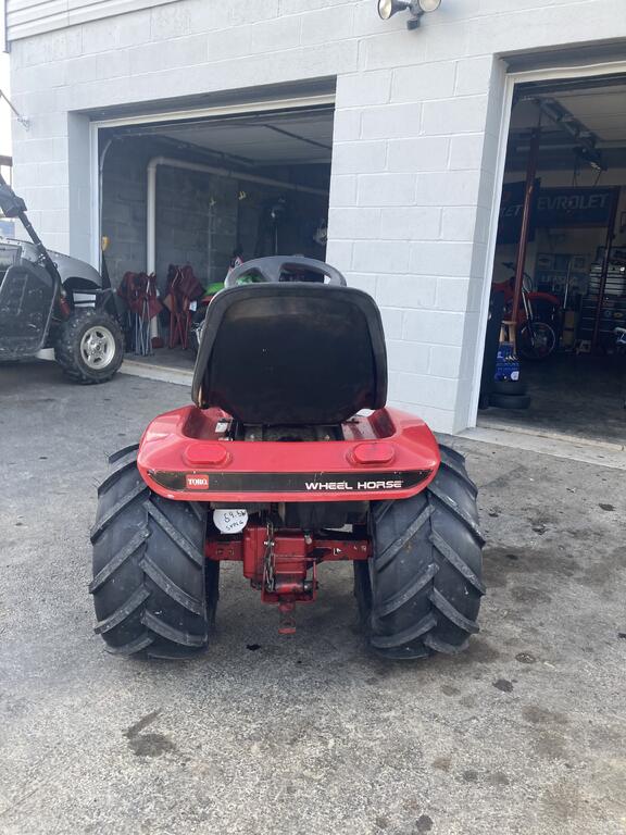

Jake the 312-8 72 #1 Posted September 10, 2023 24-12-12 11 5 Share this post Link to post Share on other sites
Wayne0 1,504 #2 Posted September 11, 2023 Them's some BIG ass tires! Share this post Link to post Share on other sites
Tonytoro416 1,309 #3 Posted September 11, 2023 Wheel spacers I assume? Share this post Link to post Share on other sites
Tonytoro416 1,309 #4 Posted September 12, 2023 I wanted to go that route on my 416 but didn’t see how I was going to be able to get them to fit. Almost bought wheels and centers from Miller tire and welded centers in with the correct backspacing to allow them under there but didn’t go that way Share this post Link to post Share on other sites
Jake the 312-8 72 #5 Posted September 23, 2023 No wheel spacers just 416 wheels with 520 size tires to get the off set they are 24-12-12 Share this post Link to post Share on other sites
Jake the 312-8 72 #6 Posted September 23, 2023 And worst case if they dont fit on urs loosen the bolts on the hubs and pull the axels out a bit u could maybe get a few inches Share this post Link to post Share on other sites
