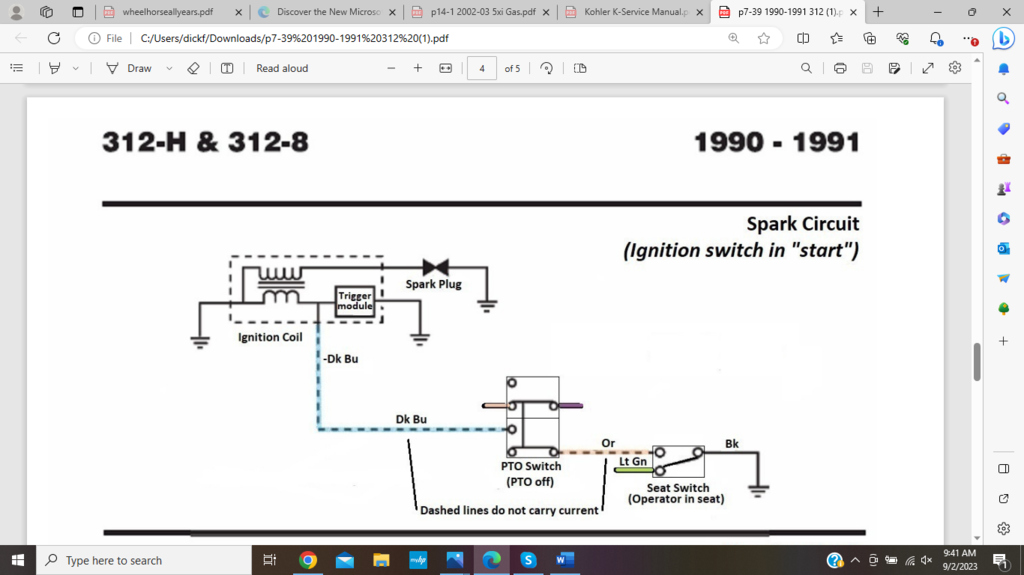

953 nut 63,075 #4 Posted September 2, 2023 Here is a wiring diagram for the ignition system wiring on your 312. If the PTO is not pulled up (off) you will not have any spark with the key in the run or start position. This wiring guide from the "Demystification Guide" should be helpful. 2 Share this post Link to post Share on other sites
