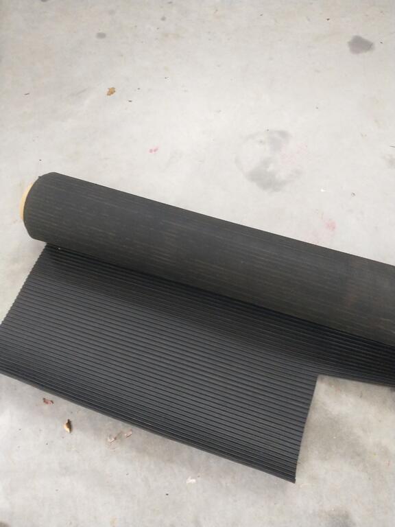

rmaynard 16,572 #11 Posted August 30, 2023 Rubber-Cal 03_167_W_RC_04 Ramp Cleat Non-Slip Outdoor Rubber Floor Mats, 0.13 inch Thick X 3ft X 4ft, Black Available from Amazon 2 Share this post Link to post Share on other sites
Searcher60 209 #12 Posted August 31, 2023 22 hours ago, rmaynard said: 22 hours ago, rmaynard said: Rubber-Cal 03_167_W_RC_04 Ramp Cleat Non-Slip Outdoor Rubber Floor Mats, 0.13 inch Thick X 3ft X 4ft, Black Available from Amazon Fantastic! Did you use 2 sided tape or glue? Thanks! Rubber-Cal 03_167_W_RC_04 Ramp Cleat Non-Slip Outdoor Rubber Floor Mats, 0.13 inch Thick X 3ft X 4ft, Black Available from Amazon 1 Share this post Link to post Share on other sites
rmaynard 16,572 #13 Posted August 31, 2023 (edited) I used double-sided carpet tape called Rhino tape. Edited August 31, 2023 by rmaynard 1 Share this post Link to post Share on other sites
