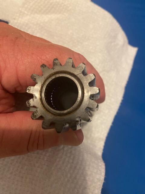

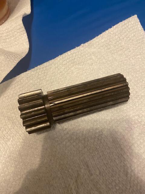

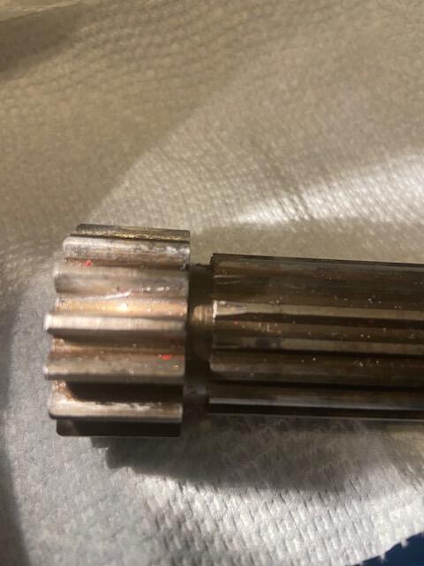

ri702bill 11,354 #3 Posted August 28, 2023 Probably cracked when the needle bearing was installed a long time ago... 1 Share this post Link to post Share on other sites
squonk 45,593 #4 Posted August 28, 2023 (edited) You can spray every component with carb cleaner and walk away for 15 minutes. Any crack will show up plain as day. It's also possible that pilot bearing is shot Edited August 28, 2023 by squonk 2 Share this post Link to post Share on other sites

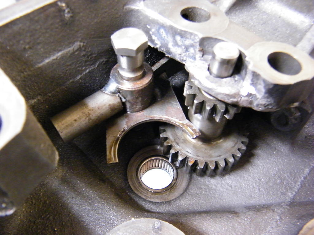

stevasaurus 23,620 #6 Posted August 28, 2023 It could also be the hi/low shift fork. It does seem that your issue is somewhere with the hi/low mechanism. Share this post Link to post Share on other sites
WHGuy413 2,851 #7 Posted August 28, 2023 56 minutes ago, stevasaurus said: It could also be the hi/low shift fork. It does seem that your issue is somewhere with the hi/low mechanism. That was something I was thinking. It shifts between the 2 ranges pretty hard. Any idea what I do for that? Share this post Link to post Share on other sites
squonk 45,593 #8 Posted August 28, 2023 (edited) 36 minutes ago, WHGuy413 said: That was something I was thinking. It shifts between the 2 ranges pretty hard. Any idea what I do for that? Needs to come apart again. The hi-lo fork is flimsy. It could be bent cracked or both. Edited August 28, 2023 by squonk 2 1 Share this post Link to post Share on other sites
stevasaurus 23,620 #9 Posted August 28, 2023 Squonk is correct. Need to open it up and carefully inspect those parts. Try shifting the trans when you get the one side off. That cracked spline shaft and/or a bad bearing would for sure cause your issues...binding in the same position when turning input shaft. Make sure you repeat those functions as you go back in, you may see where it is binding. 4 Share this post Link to post Share on other sites

stevasaurus 23,620 #13 Posted August 29, 2023 That fork mechanism was available 2 years ago...around $60. Might still be. 1 Share this post Link to post Share on other sites
squonk 45,593 #14 Posted August 29, 2023 (edited) Hi lo fork # 7209 superseded to # 116636-03 NLA from Parts Tree. Listed on Mowpart available for $76.86 https://mowpart.com/shift-fork-asm-116636-03/ Edited August 29, 2023 by squonk 1 Share this post Link to post Share on other sites
