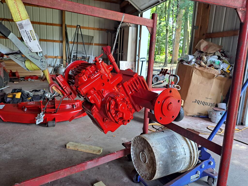

Mike_eash 59 #1 Posted August 27, 2023 Hello guys first off I know I am going to get **** for even asking this and I know it's not the right way off doing things! However I have been restoring a charger 10 I have painted everything and am ready for assembly it's been a long process! I have the tranny hanging to paint it (see pics) I drained all the fluid but obviously not everything comes out because I noticed a small leak has developed at the front of it. Is there anything I can do without tearing this thing apart? Any stop leak fluids that work ? Any suggestions Thank you Share this post Link to post Share on other sites

pfrederi 19,278 #5 Posted August 27, 2023 Put in any "miracle cure and you will have to open her up to clean out all the stuff that will get stuck in Acceleration valves and other small passages. Where is the leak. Blue, yellow or green area Share this post Link to post Share on other sites
Mike_eash 59 #6 Posted August 27, 2023 1 hour ago, rmaynard said: First question is, was it leaking before you started? Second, can you see exactly where the oil is leaking from? As far as I know nothing was leaking before I started. But if you can see my pics I believe it's coming from that gasket that is in the middle of the transmission right at the front part of it. Share this post Link to post Share on other sites
Mike_eash 59 #7 Posted August 27, 2023 1 minute ago, pfrederi said: Put in any "miracle cure and you will have to open her up to clean out all the stuff that will get stuck in Acceleration valves and other small passages. Where is the leak. Blue, yellow or green area Green area Share this post Link to post Share on other sites
pfrederi 19,278 #8 Posted August 27, 2023 Put a wrench on the housing bolts make sure they are really tight..especially the three bottom ones Share this post Link to post Share on other sites
Mike_eash 59 #9 Posted August 27, 2023 3 minutes ago, pfrederi said: Put a wrench on the housing bolts make sure they are really tight..especially the three bottom ones I did that to the bolt that was right by the leak everything seems tight I will try with my big impact on all 3 Share this post Link to post Share on other sites
pfrederi 19,278 #10 Posted August 27, 2023 I have a couple of Sunstrands that will mark their parking spot...That is what drip pads are for.... Tranny holds 5qts so an ounce or 2 over a couple months isn't a big deal. Avoids rust on teh bottom of the hydro 1 1 Share this post Link to post Share on other sites
Mike_eash 59 #11 Posted August 27, 2023 19 minutes ago, pfrederi said: I have a couple of Sunstrands that will mark their parking spot...That is what drip pads are for.... Tranny holds 5qts so an ounce or 2 over a couple months isn't a big deal. Avoids rust on teh bottom of the hydro Yeah its probably what will happen in my situation I really hate to put something on the tractor again that's not 100% but because of the fact that I have never worked on a transmission of any kind there is a chance that I might make something worse When I bought this tractor My only real concern was the transmission everything else I can work on myself We will see how it goes They are not hard to get to if maybe I would have to open it up in the future 1 Share this post Link to post Share on other sites

Gasaholic 341 #14 Posted August 27, 2023 1 hour ago, Mike_eash said: Green area Also check to be sure oil is not seeping out the tranny-to-frame mounting holes. I've seen some that had too-long bolts put in there that cracked the case and would seep oil past the bolts even when installed. 1 Share this post Link to post Share on other sites
Mike_eash 59 #15 Posted August 27, 2023 26 minutes ago, Gasaholic said: Also check to be sure oil is not seeping out the tranny-to-frame mounting holes. I've seen some that had too-long bolts put in there that cracked the case and would seep oil past the bolts even when installed. Thanks I will check that out! Share this post Link to post Share on other sites
daveoman1966 3,881 #16 Posted August 28, 2023 Your Charger 10 is 50+ years old... There is no doubt that it is in need of a Sundstrand Hydrogear overhaul just because of its age--- model 90-2046. This is NOT DIFFICULT to do---everyone has a first time so don't be timid about this. If you can turn a wrench and know what an O-ring is, you can manage this overhaul. I have done so to a dozen or more and have prepared a 'How To' .pdf file as a guide to the procedure. This file has lots of pics and I'll provide more pics as needed. I would only caution to keep your work are clean and be meticulous in this process. Here is the .pdf file. NOTE--- Gasket and O-ring kits are available for this model. B J Hydraulics is one source. SUNDSTRAND HYDROGEAR refurb.pdf 2 Share this post Link to post Share on other sites
