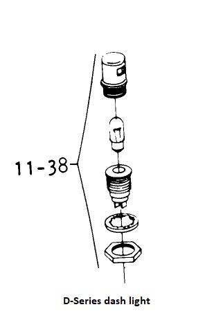

bo dawg 536 #1 Posted August 24, 2023 ok, Ive never had one to know any better, but how does the small dash light on the D-200 come apart to change the bulb? Ive messed around with it but doesnt want to come apart, afraid i will break it, so thought Id ask before I go any farther. Share this post Link to post Share on other sites
gwest_ca-(File Mod) 11,838 #2 Posted August 25, 2023 Does it look like this? Lamp holder 104032 uses a 103443 bulb which is a #1815 2 Share this post Link to post Share on other sites
bo dawg 536 #3 Posted August 25, 2023 yes that looks like it. So does the top plastic part unscrew or just pulls off to get to bulb? Share this post Link to post Share on other sites
