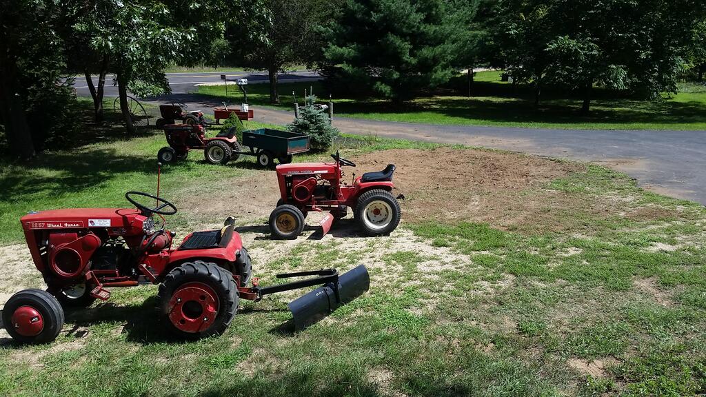

sjoemie himself 3,238 #26 Posted September 2, 2023 Thanks. Yes indeed but I ditched the top actuator for a small tractor toplink. The actuator was too weak and I had trouble finding the right working depth again after raising the implement. The rear actuator raises and lowers the wheels (for transportation) and the rake and level bars are manually adjustable with a chain. I have pins on the frame where I can hook the chains onto, choose another chain-link to adjust the depth. The idea was to let the leveler ride on the two front wheels but it's a bit too heavy (wheels have too little flotation) for that in these extremely dry circumstances. 1 Share this post Link to post Share on other sites

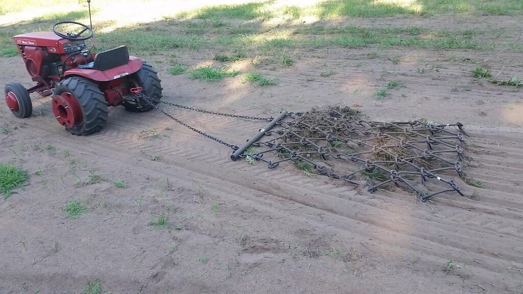

Lee1977 7,805 #29 Posted September 2, 2023 (edited) I have used this on my drive. To tear out the grass that grows in it I can pick it up by hand but It's almost impossible to release with that weight on it. Edited September 2, 2023 by Lee1977 5 3 Share this post Link to post Share on other sites

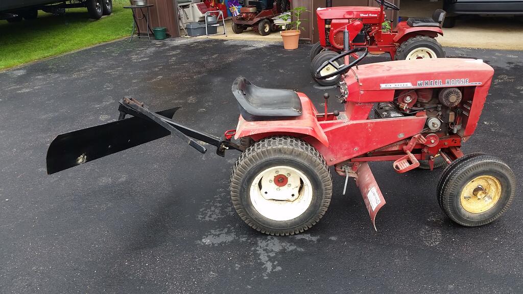

WHX?? 58,302 #33 Posted September 3, 2023 (edited) Not that I don't like a box blade KP. I have one for my big tractor but unfortunately not very well skilled with it. I got this Brinly back blade awhile back from @Joey Small Block and not very well skilled with it either. It works but needs down pressure which I have yet to finger out on a horse. Maybe a hydro with some weight? Tried it in tamden with a mid blade... no go. Can't adjust the lift heights independently. Edited September 3, 2023 by WHX?? 3 1 Share this post Link to post Share on other sites

Lee1977 7,805 #43 Posted September 18, 2023 (edited) Done any more on your drive way upkeep project. You know we need pictures! Need any drag hare teeth, I know where some are. Edited September 18, 2023 by Lee1977 1 Share this post Link to post Share on other sites

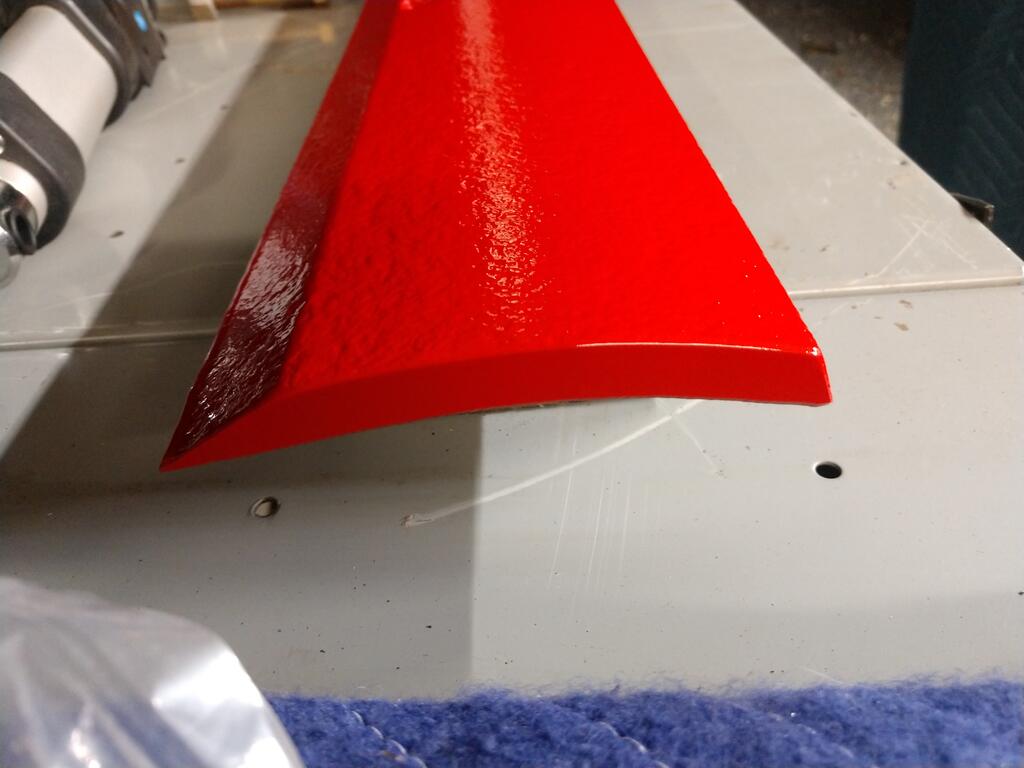

kpinnc 19,006 #47 Posted October 1, 2023 (edited) On 9/18/2023 at 12:40 PM, Lee1977 said: Done any more on your drive way upkeep project. You know we need pictures! Still in the "gathering" period right now. I did get the blade you gave me cut down to 58 inches. Not only is it stout, it was hard to cut- even with a 10-inch grinding wheel! Edited October 1, 2023 by kpinnc 4 Share this post Link to post Share on other sites
