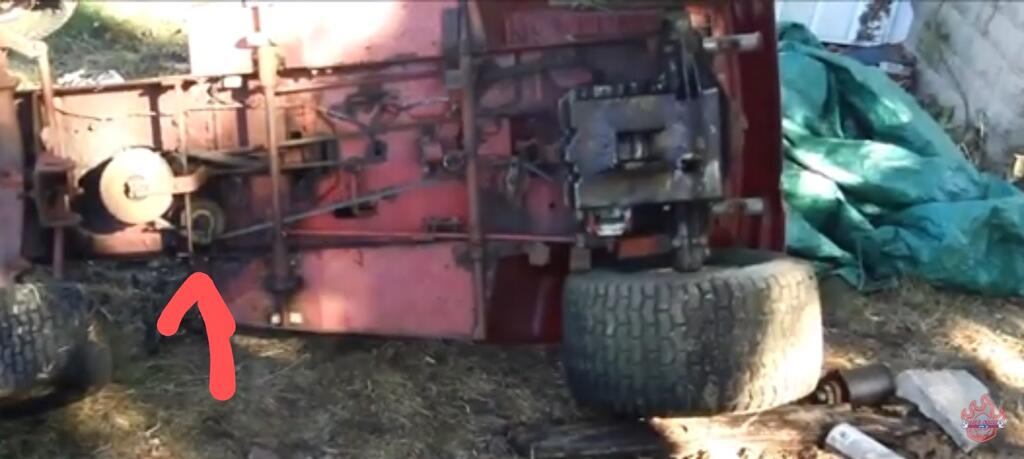

Cam28 0 #5 Posted April 13 I carnt seem to find a parts Illustration for it I have not had chance to look for part numbers on it yet all I no is it's B-115 5 speed with the 11hp but I did find I vid of sum ones and it has a extra idler wheel up by the engen which mine seem to be missing a screenshot off that vid Share this post Link to post Share on other sites
