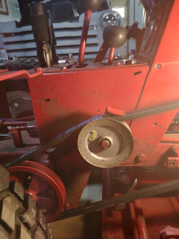

chalky493@yahoo.com 10 #1 Posted August 22, 2023 For the guys who gave me some advice , or my drive belt mess . A 82 " was to short and a 84" to long , but a 83 " just right .Also found out the clutch pedal return spring was in the wrong hole . The first picture is an 82" belt with it just on all three pulleys , the belt keeper was already on the belt , the clutch rod is disconeted . Just mowed the lawn , all good so far ! Thanks for the help ! 3 2 Share this post Link to post Share on other sites
