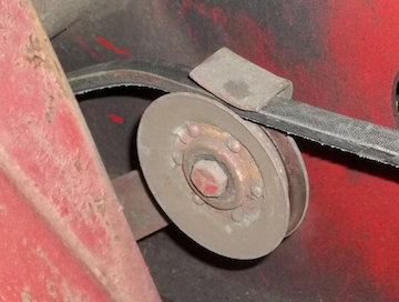

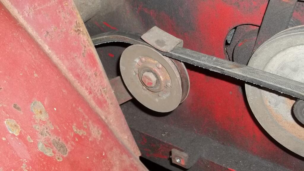

Ed Kennell 46,481 #33 Posted August 20, 2023 n Does this picture help explain how Wheel Horse was using the forward/downward rotation of the idler pulley and its belt retainer tab to pinch the belt against this fixed tab to insure the belt is not moving during declutching? You can see the location of the idler and transmission drive pulleys on the belt guard. 1 Share this post Link to post Share on other sites
