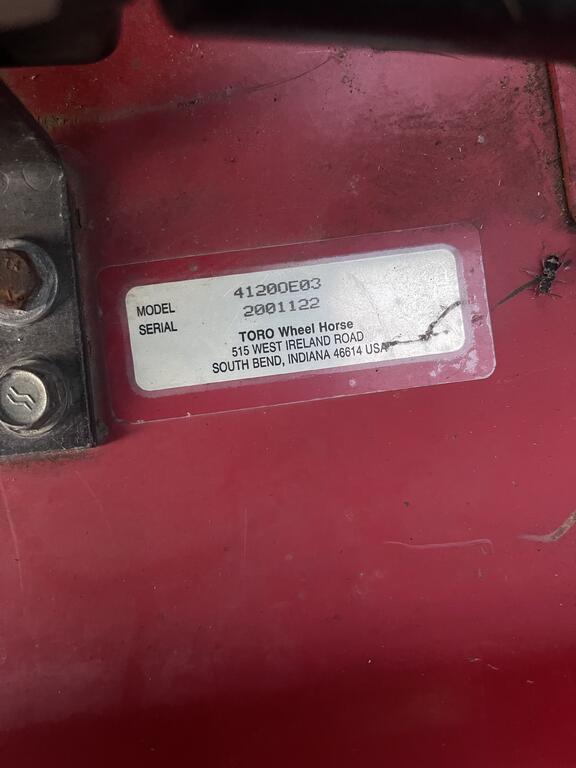

JCM 10,987 #9 Posted August 17, 2023 41-200E03 should be a 1992. Share this post Link to post Share on other sites

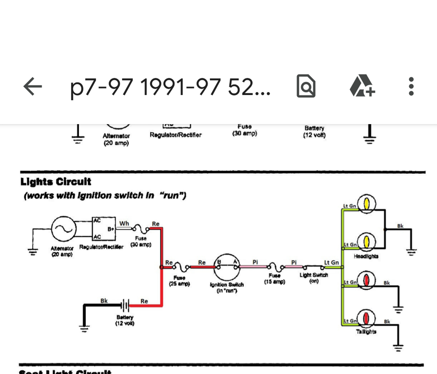

gwest_ca-(File Mod) 12,066 #10 Posted August 17, 2023 1 Share this post Link to post Share on other sites

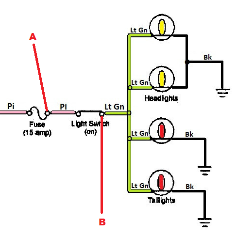

rmaynard 16,991 #15 Posted August 17, 2023 Check both sides of the light switch. If you have power at the fuse side, and power at the light side when on, then the problem has to be in the green wire. When you are testing for 12 volts, what are you using for ground? Share this post Link to post Share on other sites
Matt0000 1 #16 Posted August 17, 2023 59 minutes ago, rmaynard said: Check both sides of the light switch. If you have power at the fuse side, and power at the light side when on, then the problem has to be in the green wire. When you are testing for 12 volts, what are you using for ground? The battery ground Share this post Link to post Share on other sites
rmaynard 16,991 #17 Posted August 18, 2023 18 hours ago, gwest_ca said: Is the 15 amp light fuse getting power? 17 hours ago, Matt0000 said: yes Since your answer is that you do have 12 volts at the light fuse (A), then the only other place to check is the switch (B) If switch (B) has 12 volts at both sides, your green wire is the culprit. 1 Share this post Link to post Share on other sites

Lee1977 7,627 #21 Posted August 24, 2023 The tail lights don't go through the 9 pin connector so if they don't work and you have power past the 15 amp fuse it's the light switch. Share this post Link to post Share on other sites
