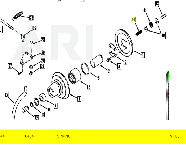

michael hall 1 #1 Posted August 11, 2023 Got a question some of you might have run into. My 1976 C120 PTO has a spring inside that is very worn. Now I spoke with my local wheelhorse dealer and he tried to find a replacement and has had no luck. He told me that there wasnt a spring in earlier models and wheelhorse discontinued putting a spring in the PTO after a few years of doing it. So any ideas on get a replacement or should I leave it out because it created issues thats why wheelhorse stopped putting them in. Whats you alls advice? Share this post Link to post Share on other sites
Lee1977 7,460 #2 Posted August 11, 2023 (edited) Yes they came with the spring and a small thrust bearing. You don't need any of that it will work just fine with out it. They did away with that in the later Wheel Horses. There was also a 3/8" screw in the end of the crank shaft, if it is still there take it out also. Edited August 11, 2023 by Lee1977 5 1 Share this post Link to post Share on other sites
Gasaholic 341 #3 Posted August 11, 2023 yep. As Lee said - There'd be a short 3/8-24 NF Stub screw in end of crank, onto which was placed a thrust washer, flat thrust roller bearing, and another thrust washer, plus the spring. The stub screw intended to keep everything lined up and in place. The purpose was to push the PTO away when de-clutching and into the PTO Brake so as to stop the PTO more quickly. This was the transition between the PTO engagement lever designs after they added the PTO brake, then they did a tweak to the PTO engagement design so that disengaging would "pull" the pto stack pulley away from clutch plate and into the brake lightly, eliminating the need for the return spring, as I recall. Unit would work just fine without the spring & bearings, though they could tend to be a little slow on the stop time after disengaging PTO, but no one but the CPSC (and Wheel Horse's liability insurance lawyers, and Dealers that were in a "sue-happy" region where folks would file a lawsuit at the drop of a hat) worried about that... having the PTO Brake there was still better than the no-brake designs, but old-school farm boys knew enough to have patience to wait until pto driven stuff stopped moving before doing anything around the implements. 4 Share this post Link to post Share on other sites
rmaynard 16,700 #4 Posted August 11, 2023 (edited) Is this what you are looking for? #44. Tell your dealer to look a little harder. Still available. As far as "don't need it", I disagree. I find that the PTO presses against the brake better with it. Edited August 11, 2023 by rmaynard 1 Share this post Link to post Share on other sites

rmaynard 16,700 #7 Posted August 11, 2023 4 hours ago, WHX?? said: Any idea what years these were? I never heard of this or seen them on any of my horses. Your horse sense impresses me @Gasaholic. Can tell you worked for a dealer. My B-100 has it and it's a 1977. Share this post Link to post Share on other sites
Lee1977 7,460 #8 Posted August 12, 2023 (edited) 9 hours ago, WHX?? said: Any idea what years these were? I never heard of this or seen them on any of my horses. Your horse sense impresses me @Gasaholic. Can tell you worked for a dealer. 1976 and 1977 C-series not sure when they stop using them. Edited August 12, 2023 by Lee1977 Share this post Link to post Share on other sites
