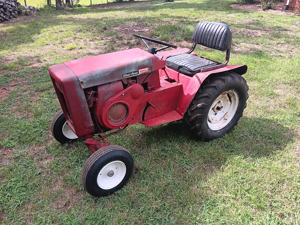

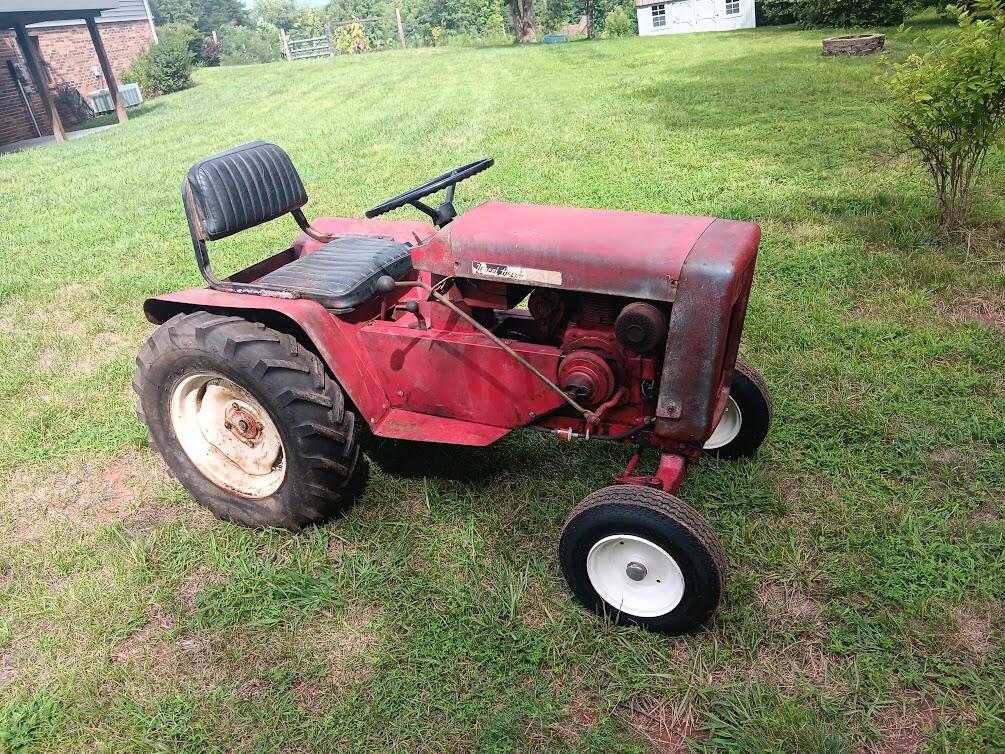

Skwerl58 767 #5 Posted August 11, 2023 Pictures after I rode it yesterday. I have a set of headlight lens and seals on the way. Will post updated picures as I complete it. 2 4 Share this post Link to post Share on other sites
Pullstart 68,179 #6 Posted August 11, 2023 Have we discussed the hub and axle situation on the left rear? Is that axle longer, or has the hub slid in? 1 Share this post Link to post Share on other sites
Skwerl58 767 #7 Posted August 12, 2023 Hub has slid in. I am waiting on the seals before I remove them, May change my mind but waiting now. Very little diesel leaked out as I was flushing it. I have sprayed the set screw holes with Kroil three times so hopefully it want be a beast to remove. 1 1 Share this post Link to post Share on other sites
