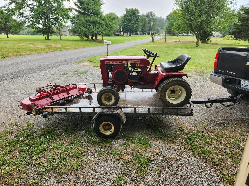

Nathan W 5 #1 Posted August 8, 2023 I have an auto 16. What is the difference between the 73 auto 16 and the 74 75 c 160? Can a end loader be used on the auto 16? Share this post Link to post Share on other sites
Pullstart 68,986 #2 Posted August 8, 2023 They had a few changes in the names and nomenclature during some company sales and changes, but for all intensive purposes they were basically the same machines. Share this post Link to post Share on other sites
oliver2-44 11,272 #3 Posted August 8, 2023 Yes a front end loader can be used on an Auto 16. It will need a subframe for the loader 1 Share this post Link to post Share on other sites

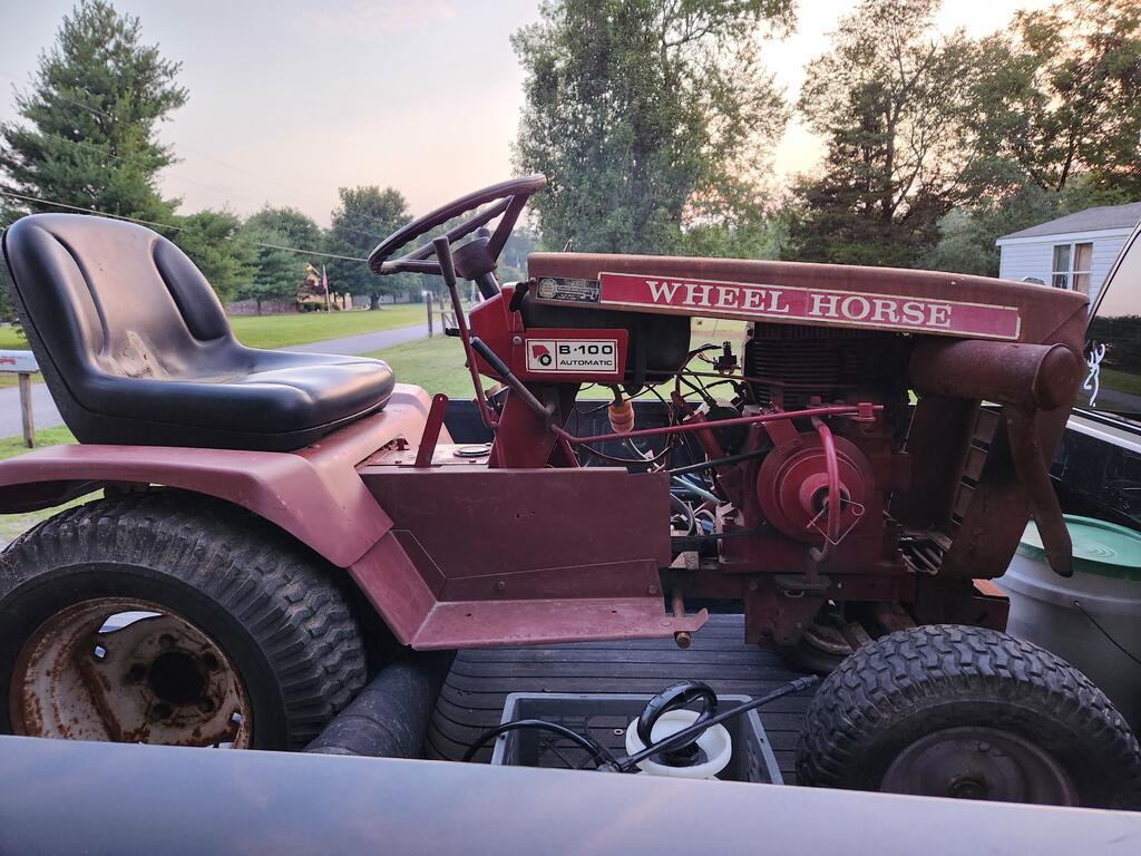

Nathan W 5 #4 Posted August 8, 2023 Thanks I have 2 73 no name. The 14 and 16. 75 b100 and 82 gt1142. Briggs blew. Put a k341 on it. Only wh I have that's 8 speed. Original owner of the auto 16 and the 82 was my dad's I purchased the other too for parts and now I'm attached to all 4. Lol 1 Share this post Link to post Share on other sites
Nathan W 5 #5 Posted August 8, 2023 Since the 341 is on the 82. Will a m18 pancake motor fit on the auto 16 with hood modifications? I would like for this tractor to be used with an end loader. I got the motor off a Yazoo Share this post Link to post Share on other sites
ebinmaine 77,554 #6 Posted August 8, 2023 4 hours ago, Nathan W said: Since the 341 is on the 82. Will a m18 pancake motor fit on the auto 16 with hood modifications? I would like for this tractor to be used with an end loader. I got the motor off a Yazoo The forward angled steering tower and narrow hood are a challenge. Wheelhorse didn't have a Twin until the steering tower was straight vertical and the hoods were much larger. On the 1977 and older the Twin engine may have to set forward to allow proper alignment of the PTO Bell. Kohler twins can be made to fit in the older C Series if: 1. Relocate the battery. 2. Raise or modify the existing hood. Maybe both. If your intention is to build a front end loader tractor my inclination would be to use the 14 or 16 Kohler single cylinder. You don't need the extra HP of the big twin 18 and it'll create a lot of extra work. Share this post Link to post Share on other sites
