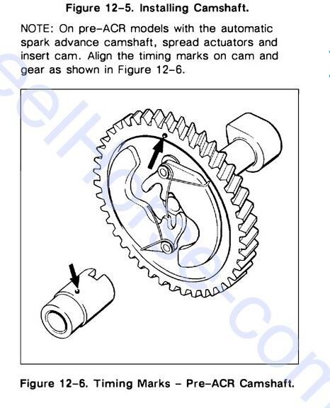

Gasaholic 334 #4 Posted August 7, 2023 (edited) Dot on the stub piece lined up with dot on cam gear, and the stub piece properly indexed into theActuator? Only thing having them 180 degrees outta sync would be to fire points at TDC of exhaust stroke, so that could be causing your backfire. (The points flat is on that stub piece, so putting it in wrong throws your point operation 180 degrees out of sync) Be sure it actually IS a 2-piece camshaft, as I have seen some 1-piece camshafts that actually were broken (between the cam lobes where fuel pump actuator bump is at - They can be broken by a grenading con rod, or by forcing fuel pump actuator to wrong side of cam lobe) When installing the 2-piece cam, it is helpful to have a temporary alignment pine (slightly smaller than the cam pin) to hold things in place and lined up during installation, and then as you push in the cam pin, the alignment pin slides out. (they were a PITA to get the end play shims in place on too!) Edited to remove "ACR" - I was thinking compression release, but meant the Automatic Spark Advance actuator (Similar to ACR, but was not for compression release, it was for spark advance timing, which was also meant to ease starting) Edited August 7, 2023 by Gasaholic Adding pic of Actuator timing Share this post Link to post Share on other sites
Chrishar 806 #5 Posted August 7, 2023 That's what my cam look like I didn't know that you had to line dot up that's probably my problem I hope I will take it apart tonight and let you know thanks again for the help 1 Share this post Link to post Share on other sites

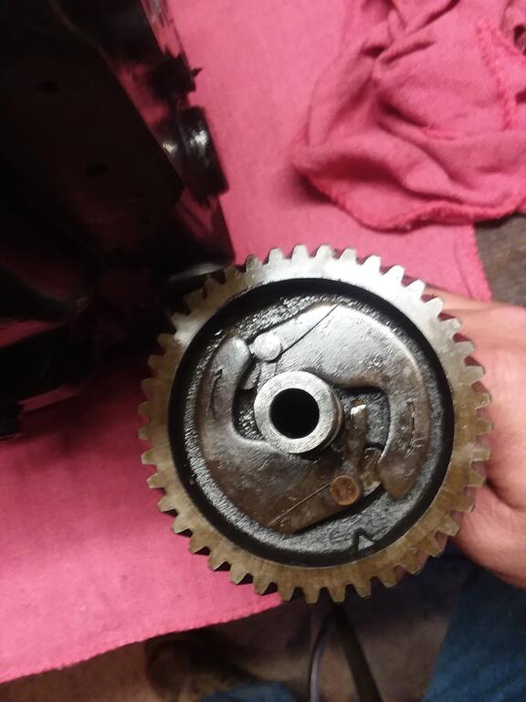

Chrishar 806 #6 Posted August 9, 2023 This what my cam look like it was 180 out 1 Share this post Link to post Share on other sites
ineedanother 1,729 #7 Posted August 9, 2023 8 minutes ago, Chrishar said: This what my cam look like it was 180 out Glad to see you likely resolved the issue and nice to have @Gasaholic aboard Share this post Link to post Share on other sites
squonk 44,623 #8 Posted August 9, 2023 That will do it. I went through the same thing last year. Bought a " rebuilt engine" that wouldn't run. Popped through the carb . Replaced the cam with a compression release design. Share this post Link to post Share on other sites
