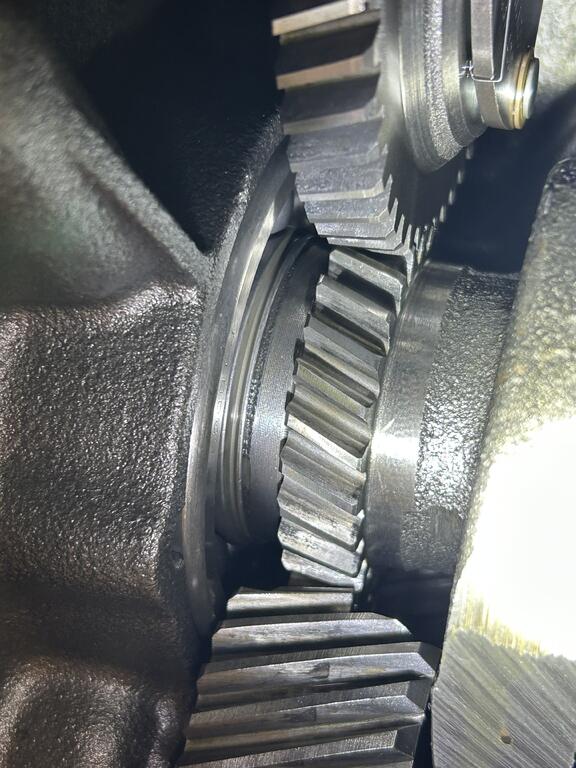

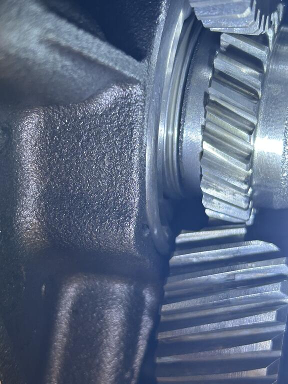

DeepH2O 66 #1 Posted July 21, 2023 Ok, fellas, need yalls help, again. I've installed the bearing plate with gasket and 2 shims. I didn't torque bolts, just snugged up with short ratchet. When I checked the gap, there was ZERO gap. Well, I figured I would install my 3rd shim. I installed plate again. Still no gap. Well, I loosened plate and then bumped the other side of shaft with a mallet and I see a good sized gap. When I make bolts up ONLY by hand, the gaps closes fully and I can't even get .0015 gauge in. Can anyone give some guidance? Pics of hand tight and another pic loose w/ gap Share this post Link to post Share on other sites
Achto 30,999 #2 Posted July 21, 2023 (edited) Sounds like you need more shims. Have any of the old ones left? Edited July 21, 2023 by Achto 1 Share this post Link to post Share on other sites
