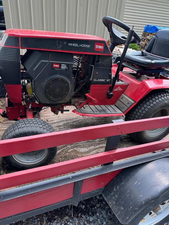

Jake.DiGregorio 1 #1 Posted July 21, 2023 Hi everyone I'm new to the wheel horse community. So this might be a dumb question. But I just got a 2004 315-8 with a 42' deck. Do I need to worry about the dial height knob on the mower or do I just adjust the height with the wheels on the deck? Share this post Link to post Share on other sites

peter lena 9,604 #3 Posted July 21, 2023 @Jake.DiGregorio , you talking about the screw thru knob ? look on any related , on line site , maybe a member will give you a shout , BTW , the paint conditition on that unit is just begging for a oil lubrication rub down . all that black plastic , use 303 vinyl restorer . get a clean soft cloth , penetrating oil of your choice , and gently rubdown every painted serface . let it sit a day , and do it again . that paint will come to life , also use that 303 VINYL ON YOUR SEAT . think of it as an opportunity , pete 1 Share this post Link to post Share on other sites
8ntruck 8,402 #4 Posted July 21, 2023 (edited) to the forum. You are correct. The mowing deck height is controlled by the gage wheels on the deck. The knob next to the lift lever adjusts a down stop that is used for other implements - most commonly the front snow blade. The only dumb question around here is the one you don't ask. There are a bunch of good folks here on the forum. Between them all, I think they have broken and repaired just about everything on a Wheel Horse that can be broken and repaired. The best part is, somebody, or several somebodies, will join the discussion with good tips and advice. There should be an owner's manual for your tractor available for download in the documentation section of the forum. Enjoy your Horse! Edited July 21, 2023 by 8ntruck 4 1 Share this post Link to post Share on other sites

ri702bill 10,812 #6 Posted July 21, 2023 Jake - Welcome! That knob is used to adjust the down height - extremely useful for plowing snow onto the grass - set it to skim and the grass does not get beat up... 3 Share this post Link to post Share on other sites

Jake.DiGregorio 1 #8 Posted July 23, 2023 Hey everyone thank you all for the advice and the link to the owners manual. I'm sorry for such a late response. So the only other question I got (for now) is the lift lever will just got up a little bit and fall all the way down. Is there a way to adjust that? I have the deck wheels on the third slot if that means anything? I can post some pictures in a few minutes. Again thanks for all the advice it's very much appreciated. 1 Share this post Link to post Share on other sites
Handy Don 15,390 #9 Posted July 23, 2023 Your lift lever is correct. It latches at the full up position (with the button at the top to release it) and it has no stops until reaching the knob-controlled low limit. This is actually a feature as it permits continual manual adjustment of height for various implements between those positions. Mowers are height-adjusted via the mechanism on the deck. Share this post Link to post Share on other sites
Rick3478 445 #10 Posted July 23, 2023 That knob sets the lower limit on implement excursion. Mowing height is normally controlled by the gauge wheels. But if you mow over any voids, like where a tree root rotted out for example, it's not desirable for the deck to drop and scalp the ground. So set the knob a little bit lower than your mowing height, and it will catch the deck before it hits the ground and float it right over the holes. 2 Share this post Link to post Share on other sites
ineedanother 1,817 #11 Posted July 23, 2023 hey @Jake.DiGregorio not a dumb question at all and I would add to the above to say that your machine is highly capable of tilling and more, which is one of the times when that adjustment is very useful. It will control the depth of your ground engaging attachments, such as a tiller or Brinley plow. Share this post Link to post Share on other sites
