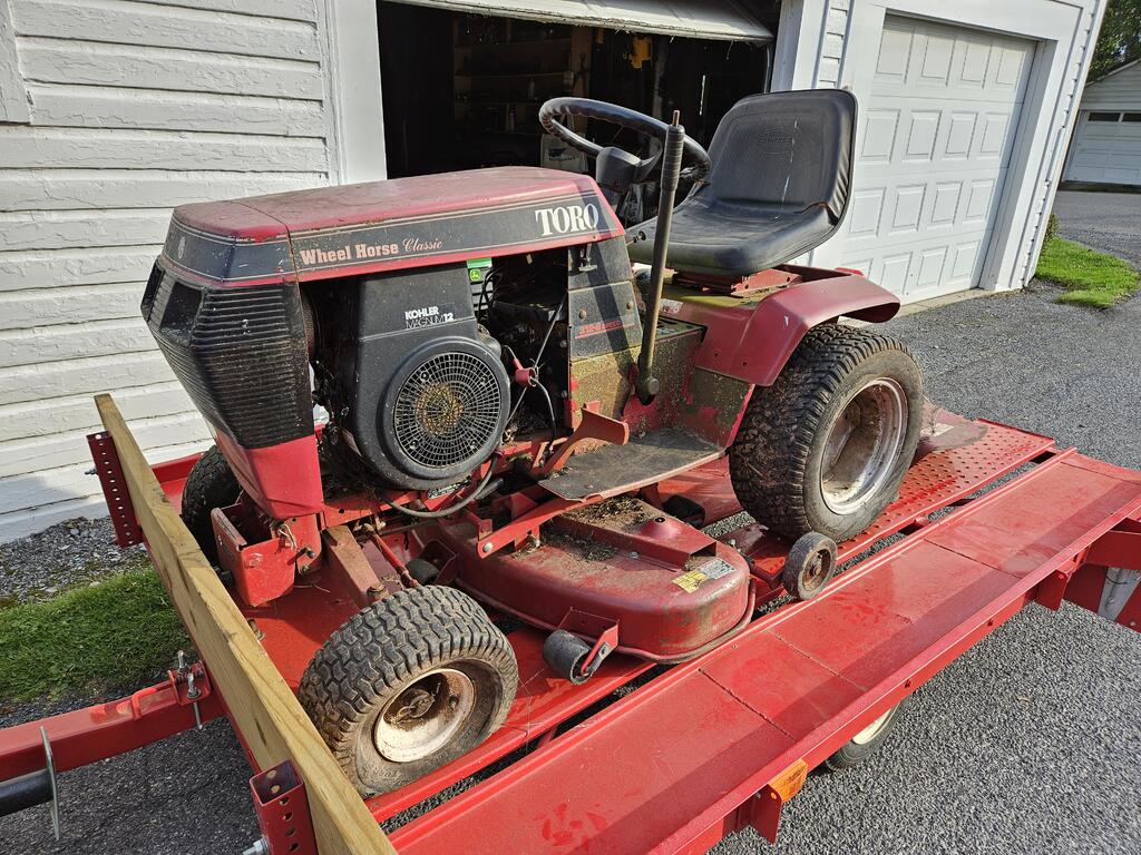

Mike'sHorseBarn 3,243 #1 Posted July 7, 2023 Did I need another horse? Absolutely not, but for $50 I had to buy it. One of my wife's co-workers got in touch with me about this 312-8 that was rough and he emphasized rough. It needs lots of love so I don't know if I'm gonna part everything out or try and get it running. Always happy to have another one though! 9 7 Share this post Link to post Share on other sites

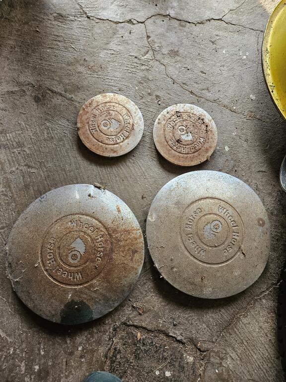

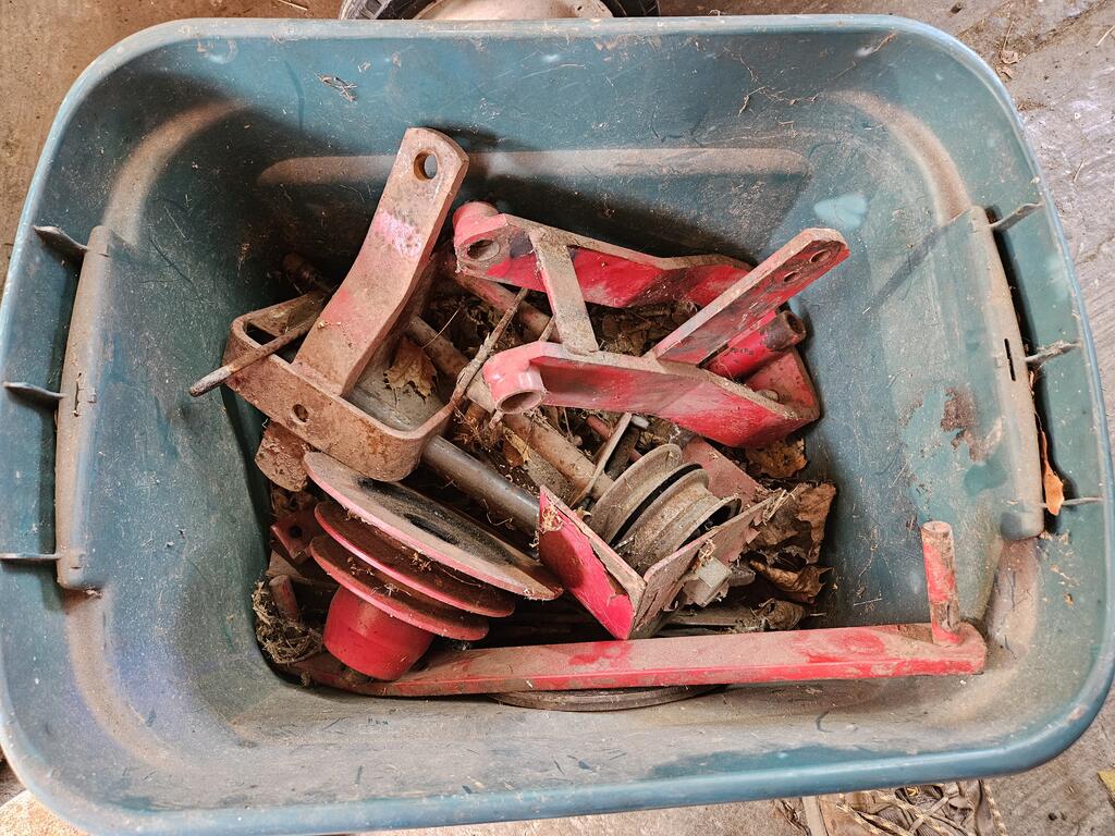

ebinmaine 72,456 #3 Posted July 8, 2023 Nicely done!! Likely those hubcaps will some up with some effort. That tote. The clevis hitch alone will easily pay out your investment. 4 1 Share this post Link to post Share on other sites

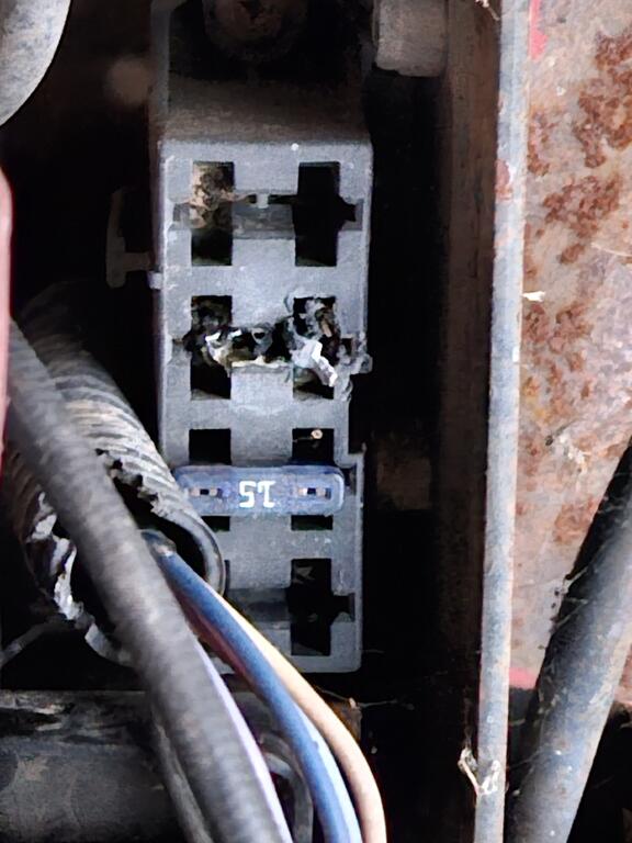

Mike'sHorseBarn 3,243 #5 Posted July 8, 2023 I've never worked on a horse this new before. It needs a new fuse block. The one on it has a couple melted in there so I need to check for shorts. Trans has some issues. The set screw for the shifter is broken off and she doesn't shift. Nothing we can't fix though! 5 Share this post Link to post Share on other sites

Mike'sHorseBarn 3,243 #11 Posted July 19, 2023 It lives! It doesn't do much else, but it lives! Doesn't charge the battery and I'm not sure what this melted fuse goes to, but it's a start! received_665734635029106.mp4 4 Share this post Link to post Share on other sites
Wheel-N-It 2,976 #13 Posted July 19, 2023 Try exciting the regulator by shorting the center terminal of the voltage regulator to the positive terminal of the battery. You will have to do this with the engine running. maybe that will bring the charging system back to life. If not, then you will have to work on the wiring. 1 Share this post Link to post Share on other sites

Mike'sHorseBarn 3,243 #15 Posted July 22, 2023 Got it moving tonight. I put a new fuse block in it and that fixed my starting and charging issue. After this video I dialed in the carb a little better. I fixed the broken shifter so I could change gears. The roll pin in the collar on the shift lever was broken, replaced that and good to go, changed fluids, amd pressure washed it. Probably tinker with it some more and then it'll be for sale I think. received_809327540632421.mp4 3 Share this post Link to post Share on other sites
