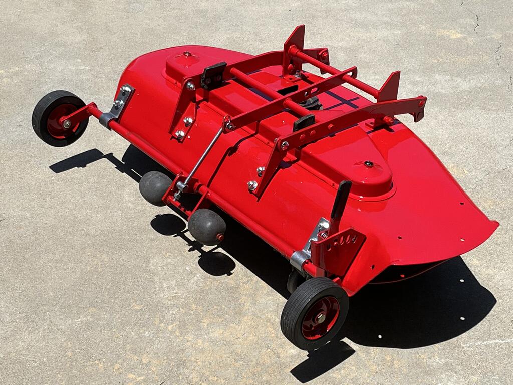

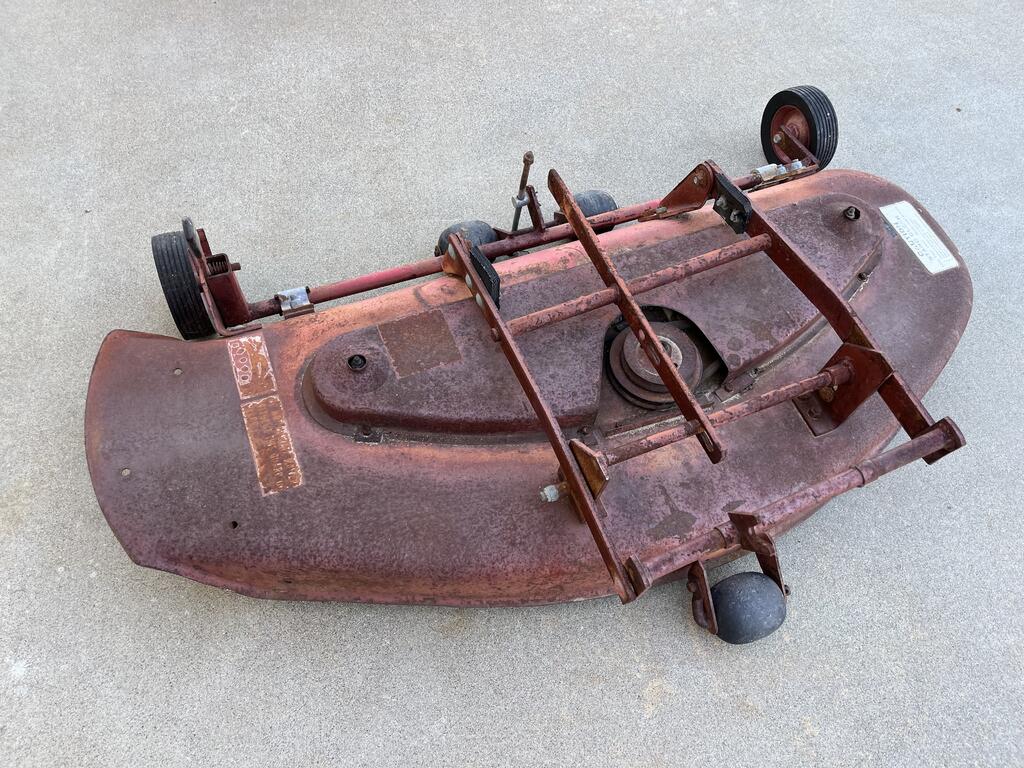

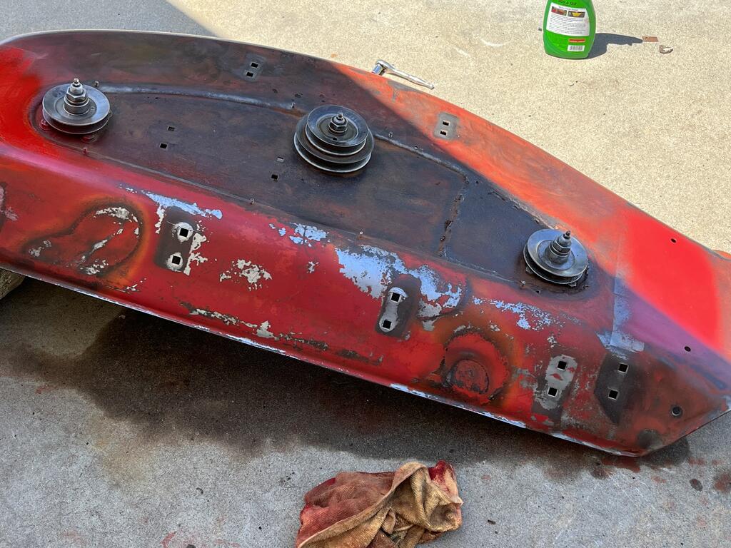

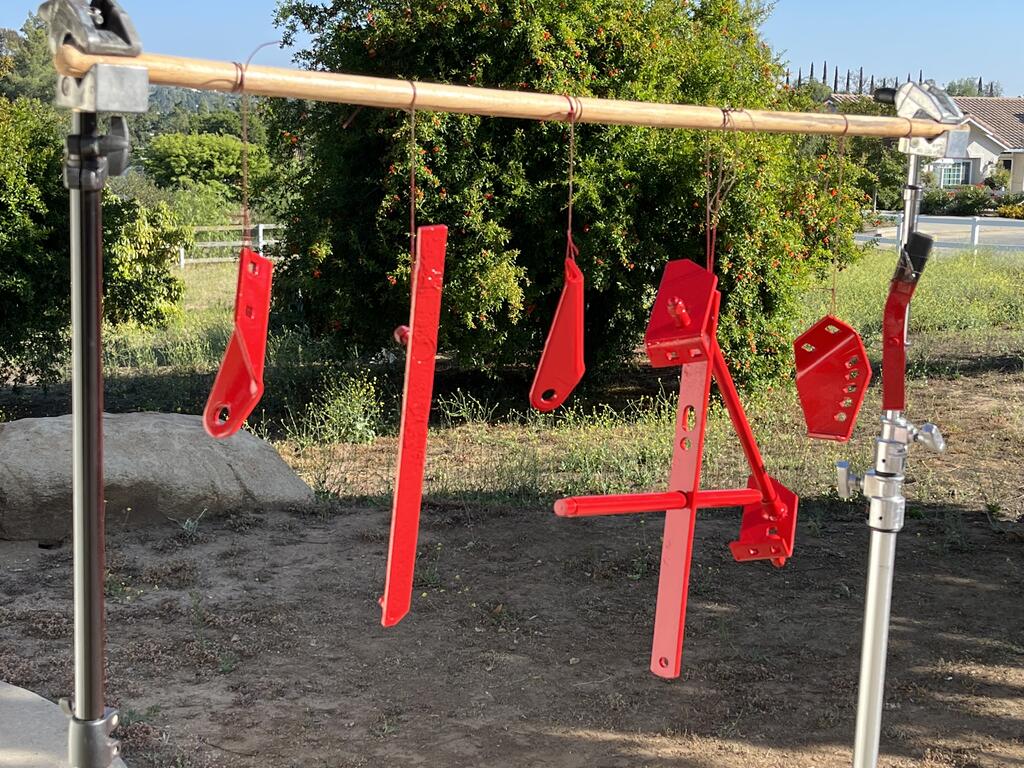

RoubaixRider 218 #1 Posted July 2, 2023 (edited) Well, after the painted cured enough (Rustoleum Sunrise Red) for reassembly over the past week, I treated the project to some new carriage bolt hardware and have new decals on the way from Terry at “Redo Your Horse”. Fun little project. Thank you to those who helped me with some questions along the way… All that’s left is replacement of the idler, pulley, and a new belt and spring. I’m going to put new blades on…the old ones look ok, but one of them is a little dinged up. The Nylon bushing plate part with the belt tension device was shot…going to simply machine one out of a small strip of Old nylon plastic cutting board. Almost seems strange to have gone to all this work for a deck that I actually plan on using a couple times a year, but that’s what these were built for right!?🤓 Edited July 2, 2023 by RoubaixRider Added text 2 1 Share this post Link to post Share on other sites
