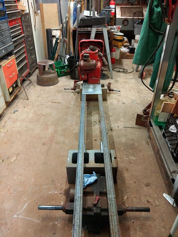

JPWH 6,544 #184 Posted August 4, 2024 I spent some time cleaning up my shop from months of "lay down n go" so I could have room to work on the dump truck build. I did a rough layout and next step is seating area. That will determine overall length and wheel base. 7 4 Share this post Link to post Share on other sites

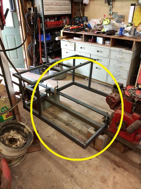

JPWH 6,544 #185 Posted August 4, 2024 Floorboard and seat frame mocked up. Also the position of the motor and front axle mocked up. Nothing is welded in place just tacked or clamped. 8 1 Share this post Link to post Share on other sites

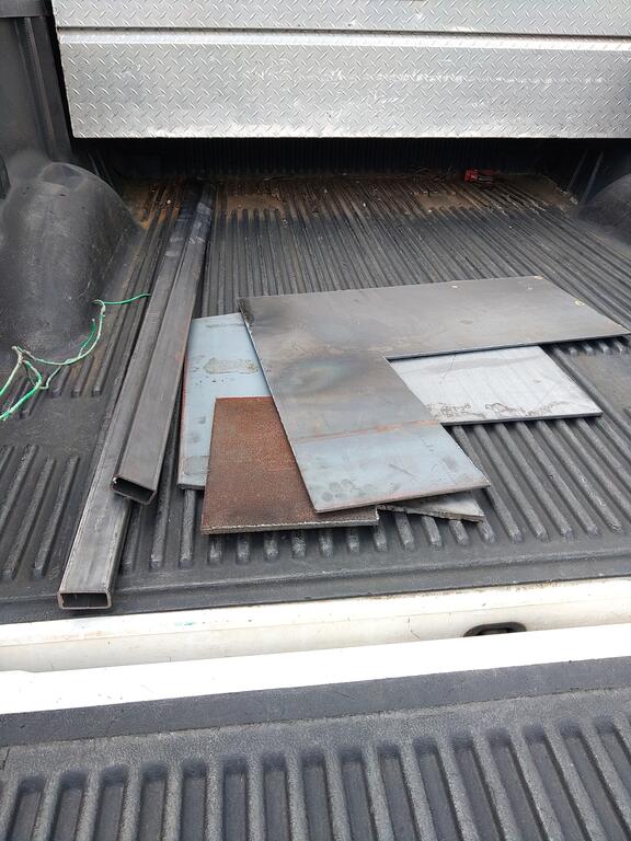

JPWH 6,544 #194 Posted August 6, 2024 (edited) I did some more lay out today and I think I have the wheel base down to about 74" and a steering angle of about 40° - 45°. According to the turning radius calculator that should give me about a 6' - 6 1/2' turning radius. I think that is pretty short for a two seater dump bed and keep the dump truck look I am after. I will have to make a couple design changes but had ran short on a couple pieces of metal and needed to visit the metal shop anyway. Edited August 6, 2024 by JPWH 3 Share this post Link to post Share on other sites

JPWH 6,544 #197 Posted August 7, 2024 I think I have found the final design. Now to start building it. I decided not to cut up any more metal mocking it up and just improvise, looks crude but it works. Final wheel base is about 66". 6 Share this post Link to post Share on other sites
953 nut 69,939 #198 Posted August 7, 2024 30 minutes ago, JPWH said: I have found the final design. Like the front axle placement. However, Won't those two short step ladders look a bit out of place. Wheels would work much better! 4 Share this post Link to post Share on other sites
ebinmaine 81,009 #199 Posted August 7, 2024 27 minutes ago, 953 nut said: Like the front axle placement. However, Won't those two short step ladders look a bit out of place. Wheels would work much better! I was wondering about steering without front wheels too. 2 Share this post Link to post Share on other sites
