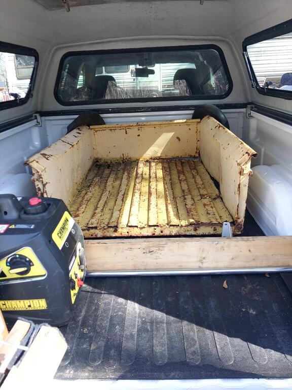

JPWH 6,544 #278 Posted March 22, 2025 (edited) I got the bed on the frame so I could see what I need to build for support. The bed is rusted so bad I will probably only use the sides. Edited March 23, 2025 by JPWH 7 1 Share this post Link to post Share on other sites
19richie66 17,937 #279 Posted March 23, 2025 20 hours ago, JPWH said: I got the bed on the frame so I could see what I need to build for support. The bed is rusted so bad I will probably only use the sides. I'm Looks good Jay! 2 1 Share this post Link to post Share on other sites
953 nut 69,939 #280 Posted March 24, 2025 On 3/22/2025 at 6:31 PM, JPWH said: The bed is rusted so bad I will probably only use the sides Those galvanized steel channels I gave you should take care of that little problem. Looking forward to taking a ride on it. 1 Share this post Link to post Share on other sites

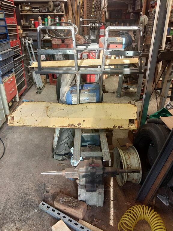

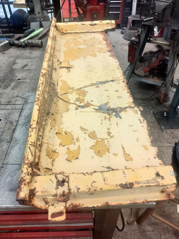

JPWH 6,544 #281 Posted March 30, 2025 I started on the process of repairing the dump bed. 8 1 Share this post Link to post Share on other sites

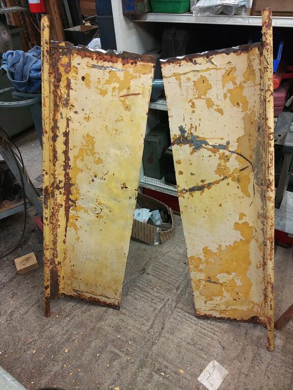

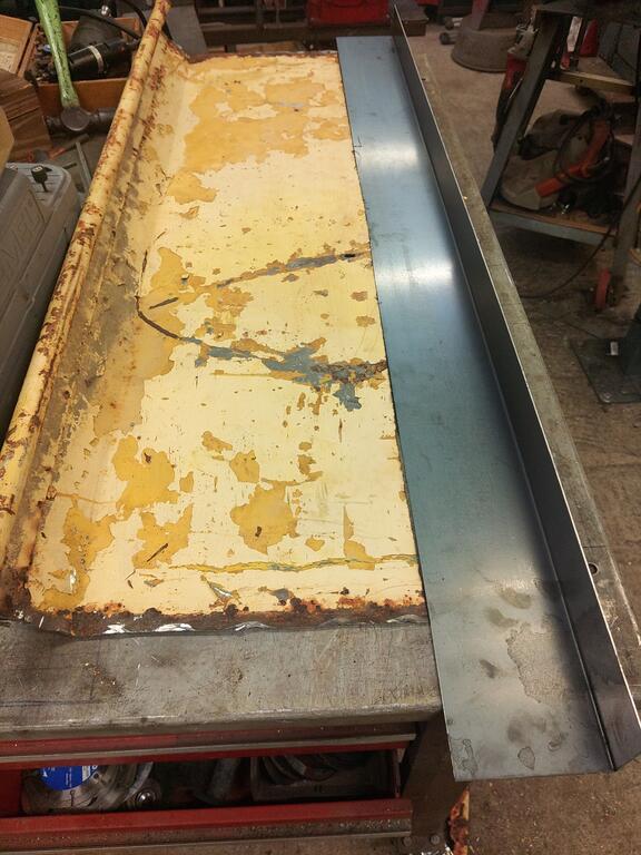

JPWH 6,544 #282 Posted April 27, 2025 This bed probably should have been scrapped but I just couldn't do it. Some of it will be but not all. I straightened the side panels and cut the too far gone parts away. Lots of character still left (Dents). I had some metal bent to add back some height and give some structure for the bottom to connect to. 7 Share this post Link to post Share on other sites

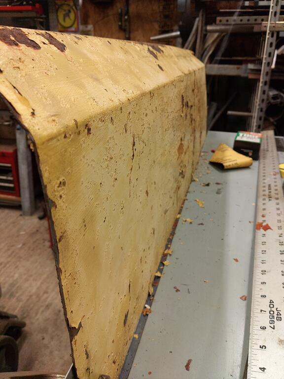

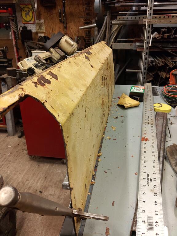

JPWH 6,544 #283 Posted May 4, 2025 The top of the bed sides were bowed, bent, and the angle was not consistent so I spent a few hours getting them straightened out. I bought the metal for the bottom frame and ordered the sheet metal to replace the bad ends I had to cut out. I'm not ready for days of this type of work yet so I just do a little at a time. Hopefully I have some progress pictures in the next week or so. 6 5 Share this post Link to post Share on other sites

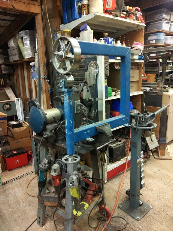

JPWH 6,544 #284 Posted August 30, 2025 Still no progress but I did purchase an English wheel so I can flatten out the sides when I get back on this project (hopefully in about a month). 5 1 Share this post Link to post Share on other sites
8ntruck 9,356 #285 Posted August 30, 2025 2 hours ago, JPWH said: Still no progress but I did purchase an English wheel so I can flatten out the sides when I get back on this project (hopefully in about a month). Where did you get the English wheel from? HF had some on clearance some months ago - I almost pulled the trigger on one, but talked myself out of it. 1 Share this post Link to post Share on other sites
JPWH 6,544 #286 Posted August 30, 2025 (edited) On 8/30/2025 at 10:35 AM, 8ntruck said: Where did you get the English wheel from? HF had some on clearance some months ago - I almost pulled the trigger on one, but talked myself out of it. I ran across it on Facebook marketplace. I did a Google search for my zip code and the Facebook listing came up. Only about 20 minutes from me. After doing some research it is built like a metal ace 22b. Edited September 2, 2025 by JPWH 1 Share this post Link to post Share on other sites

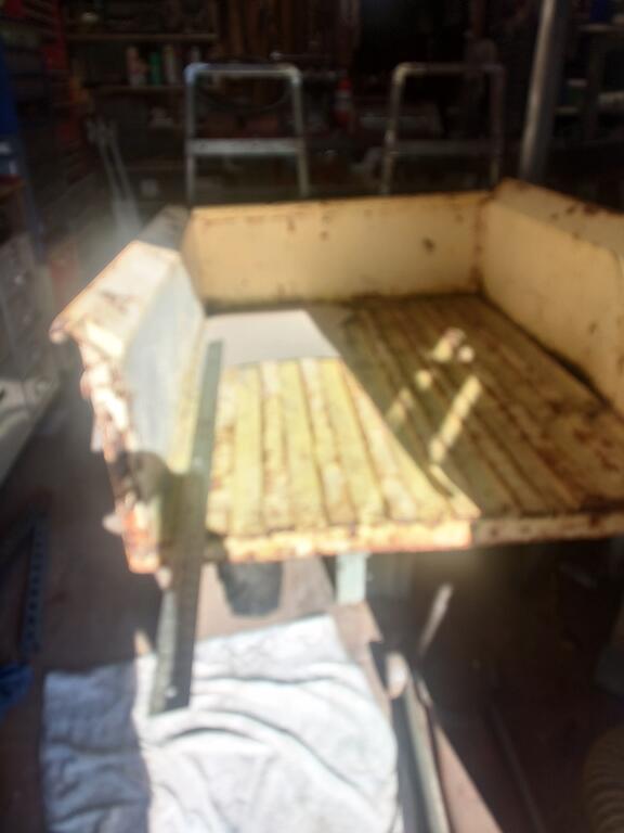

JPWH 6,544 #287 Posted September 15, 2025 (edited) I was messing around with the English wheel today and decided to run a panel on it to try it out. Just a little time made a big difference. After the DR releases me I think I will be able to get it pretty straight. Edited September 15, 2025 by JPWH 6 3 Share this post Link to post Share on other sites
