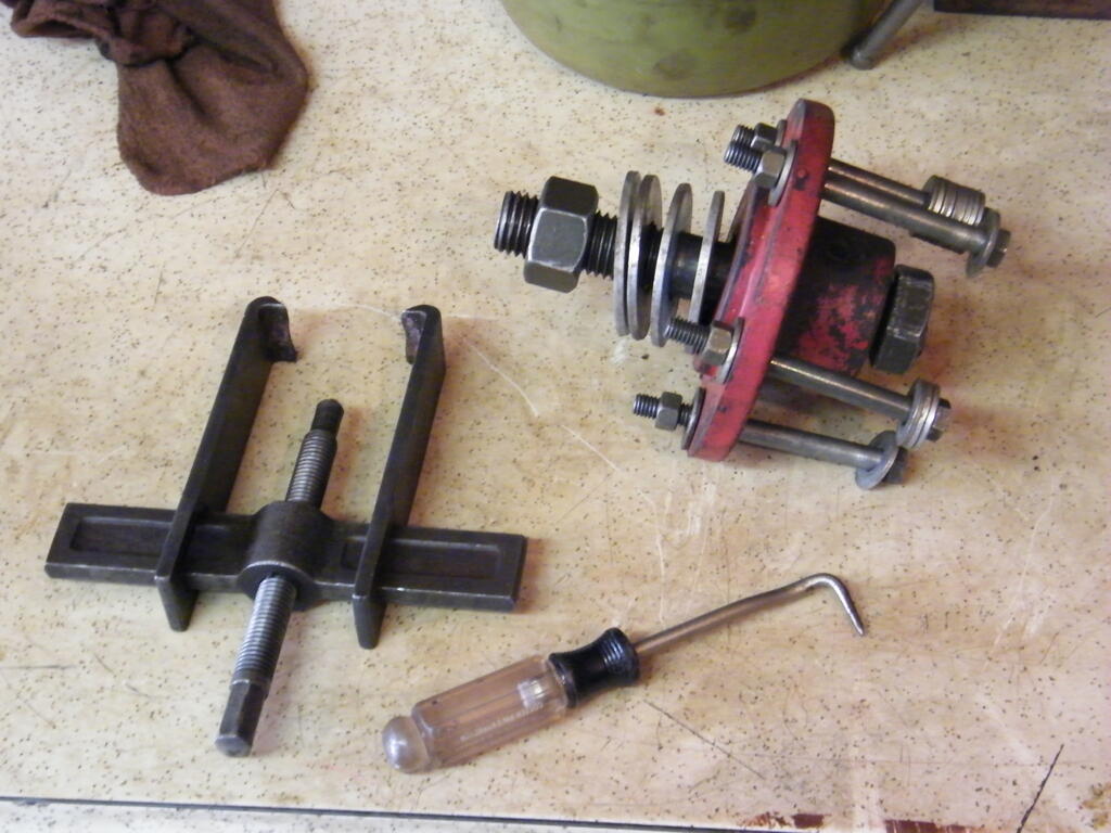

stevasaurus 23,512 #31 Posted July 15, 2023 Those hubs and the hitch pin can be the toughest part of tearing a transmission apart. If you have an extra hub, you can get bolts to make a puller. Like this...top right. Even with a hub puller, it is no guarantee they will come of without breaking. My brother's 5091...in the end, I just cut them off and ordered two from A-Z. Also, just cut the hitch pin with a sawzall and drill and/or pound out. I Believe it is just 1/2" stock...get from ACE or TSC. Either cut slots for "C" clips or buy long enough to drill and use roll pins. If you broke the one on the brake drum side (left), you can still open the transmission, unbolt the differential housing and pull out the guts so you can then pop the "C" clip and get the right axle out with the hub on it. Then you can get hub pressed off without breaking and only buy one hub. Share this post Link to post Share on other sites
