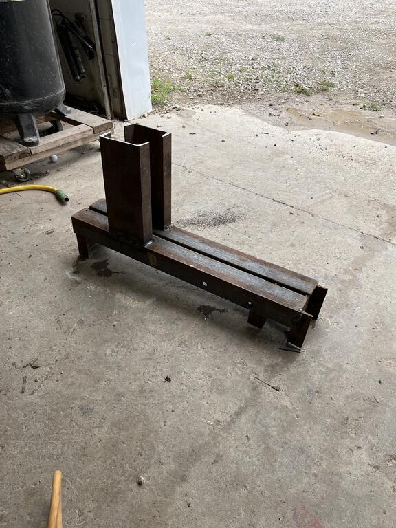

ilovemy1974b80 28 #1 Posted June 26, 2023 I am making a new frame and making some things stronger for my wheel horse. Because of the frame differences the inside part of the frame is not wide enough for the original steering. Do you have any idea for steering? This is the frame don’t mind the welds I’m a beginner welder Share this post Link to post Share on other sites
Pullstart 68,776 #2 Posted June 26, 2023 What’s the thickness of that angle iron? You could massage a clearance with smooth transitions like a | ( ) | shape… 2 Share this post Link to post Share on other sites
Pullstart 68,776 #3 Posted June 26, 2023 Also, if you want to make sure your new frame is as strong as you’d like, it may pay off to practice on similar thickness pieces until you are satisfied with the penetration and quality of your welds. Clean steel, quality grounds, smooth movements, good settings on the welder, all good things to get used to for good strong clean welds. 1 Share this post Link to post Share on other sites

ilovemy1974b80 28 #5 Posted June 26, 2023 I’m not sure how thick the metal is Share this post Link to post Share on other sites

Pullstart 68,776 #7 Posted June 26, 2023 1 hour ago, ilovemy1974b80 said: I’m not sure how thick the metal is it would be a good idea to verify. Strength is measured in many ways. I’d be sad to hear that the taller and wider angle is flimsier than stock… 1 Share this post Link to post Share on other sites
ilovemy1974b80 28 #8 Posted June 26, 2023 It’s thicker than stock Share this post Link to post Share on other sites

ilovemy1974b80 28 #10 Posted June 26, 2023 Over all, all of the metal is thicker than original 1 Share this post Link to post Share on other sites
oliver2-44 11,202 #11 Posted June 26, 2023 5 hours ago, Pullstart said: What’s the thickness of that angle iron? You could massage a clearance with smooth transitions like a | ( ) | shape… This is a good solution for your steering. If you were concerned the oval notch was a weak point you could put some vertical pieces of flat bar behind the notch area. What are you planning to use the tractor for that you are building a custom "stronger frame"? 1 Share this post Link to post Share on other sites
ilovemy1974b80 28 #12 Posted June 26, 2023 Yes I’m more of strengthening the frame and stuff so I can put more weight and a loader and 3pt Share this post Link to post Share on other sites
