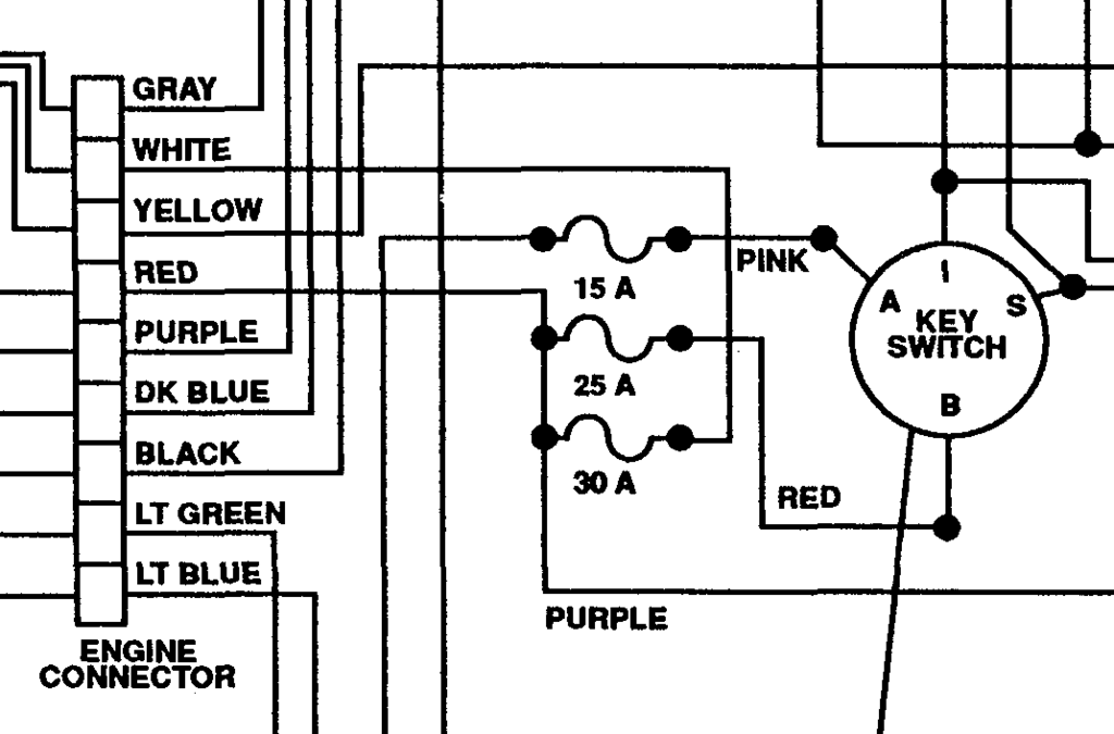

S416-8 398 #35 Posted July 29, 2023 (edited) Update is that I got it running great - found a hole in the hose that runs from the intake manifold. Nor for the electrical issue,, it is in how I ran the new fuse box. Thought I had it figured out but now even when I pull the fuses out the lights stay on. Now to try to figure out what white goes to what side and well as the other ones... Any ideas would be great thanks The way It was wired when I got it was the whites on the 30 amp, reds on the 25 amp and pink on the 15 amp. Each opposing the matching colors so the 30 linked the 2 whites, 25 the 2 reds and 15 the 2 pinks. now as soon as the battery is connected the dash lights are on.. is there a way to tell which wires go to the 4 connected terminals and which to the individual ones? Thanks Edited July 29, 2023 by S416-8 Share this post Link to post Share on other sites
RED-Z06 2,718 #36 Posted July 29, 2023 I had a problem with the fuses on my 416, ended up being that there was a common hot lead that was split inside the fuse block between multiple fuses..not realizing this, i cut the wires on the outer most fuse out..and wired them to an external fuse holder...problem was, these 2 fuses were the back end of the fused circuit and had no power in...they were together in one side of the block with no wire feeding power to that fuse...it was the common hot "strap" inside the fuse block. Share this post Link to post Share on other sites
lynnmor 8,736 #37 Posted July 29, 2023 1 hour ago, S416-8 said: Update is that I got it running great - found a hole in the hose that runs from the intake manifold. Nor for the electrical issue,, it is in how I ran the new fuse box. Thought I had it figured out but now even when I pull the fuses out the lights stay on. Now to try to figure out what white goes to what side and well as the other ones... Any ideas would be great thanks The way It was wired when I got it was the whites on the 30 amp, reds on the 25 amp and pink on the 15 amp. Each opposing the matching colors so the 30 linked the 2 whites, 25 the 2 reds and 15 the 2 pinks. now as soon as the battery is connected the dash lights are on.. is there a way to tell which wires go to the 4 connected terminals and which to the individual ones? Thanks You have the pinks connected to the reds. The 15 is separate. The 25 & 30 are on a common bus. Share this post Link to post Share on other sites
S416-8 398 #38 Posted July 29, 2023 (edited) great and thank.. figured it out just before I got this.. the new fuse block has the 4 terminals tied together.. found a few pics of what it should be like, cut the terminals apart so the white and red were together and the reset separated and it works.. all this time looking at the wires when it was the linked terminals that were the issue.. Now to finish the cab and get some pics posted Edited July 29, 2023 by S416-8 1 Share this post Link to post Share on other sites
RED-Z06 2,718 #39 Posted July 29, 2023 27 minutes ago, S416-8 said: great and thank.. figured it out just before I got this.. the new fuse block has the 4 terminals tied together.. found a few pics of what it should be like, cut the terminals apart so the white and red were together and the reset separated and it works.. all this time looking at the wires when it was the linked terminals that were the issue.. Now to finish the cab and get some pics posted So it was similar to what i had, the fuse block tying the hots together? Share this post Link to post Share on other sites
S416-8 398 #40 Posted July 29, 2023 (edited) Yup. Once I cut that strip and got the red and whites together and the pinks on their own it is all set... now to get it finished up.. then I get to start my free 312-8 that I picked up as a "non runner" that I have purring nicely.. without digging I got a list of front tires, belts, fixing a couple bangs etc.. Edited July 29, 2023 by S416-8 Share this post Link to post Share on other sites
