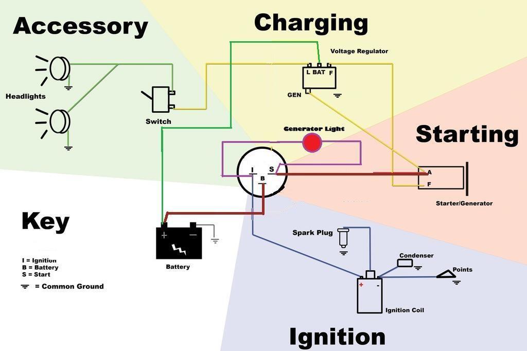

nigel 150 #1 Posted June 18, 2023 Has anyone got a good engine wiring diagram please Share this post Link to post Share on other sites
gwest_ca-(File Mod) 11,983 #2 Posted June 18, 2023 Just a guess on the tractor model number. 2 Share this post Link to post Share on other sites
wallfish 19,069 #4 Posted June 18, 2023 You can also wire in a starter solenoid if you don't have the proper switch that can handle the starter amperage. Share this post Link to post Share on other sites
