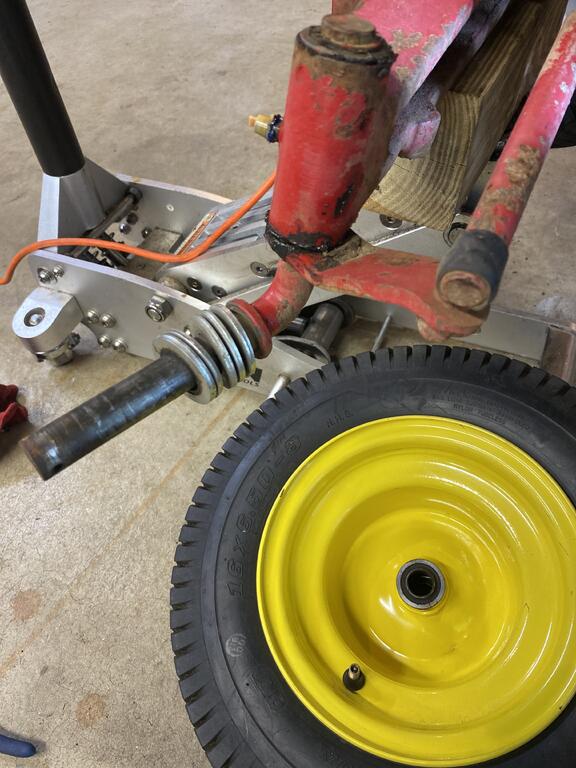

Sparky-(Admin) 24,612 #1 Posted June 17, 2023 My 416-8 will be up for sale soonish so I’m slowly going thru it fixing small and big stuff. Both front wheels are oddballs so I figured I get something that matched mounted up. Check out the first spindle!! How long did the original wheel ride on it! Dang!! 4 3 8 Share this post Link to post Share on other sites

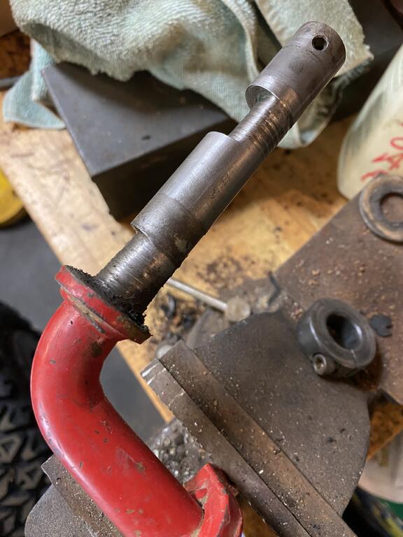

Sparky-(Admin) 24,612 #2 Posted June 17, 2023 The “John Deere” side was heavily spacer’d 3 Share this post Link to post Share on other sites

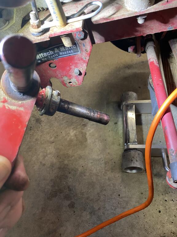

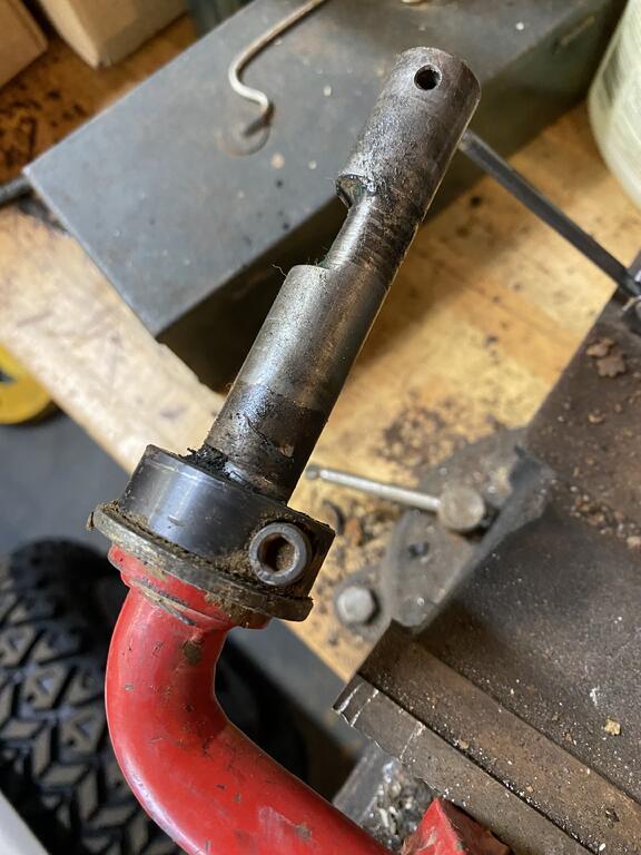

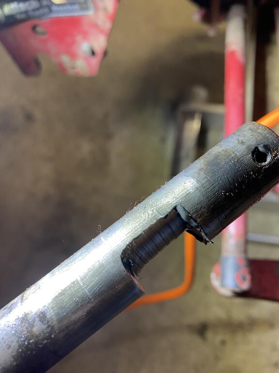

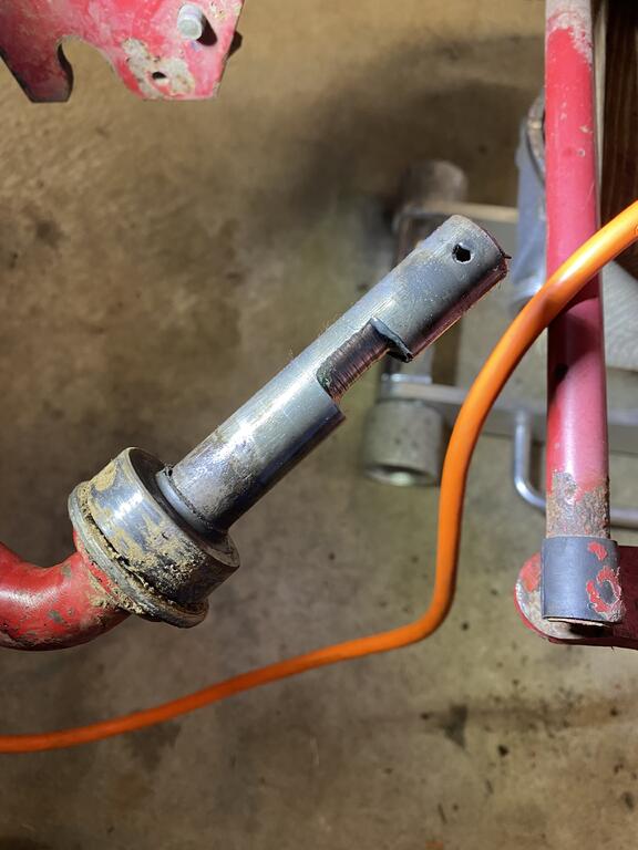

Sparky-(Admin) 24,612 #7 Posted June 17, 2023 It gets better, there was some sorta spacer that clamped onto it. Got that off to reveal another custom groove !! 4 2 3 Share this post Link to post Share on other sites
squonk 45,473 #8 Posted June 17, 2023 Looks like you had a Lincoln log for a spindle! 13 Share this post Link to post Share on other sites

ri702bill 11,242 #10 Posted June 17, 2023 (edited) Mike - good catch. That must have had the "Gangster Lean" with both bearings riding in the grooves. And NO... JB Weld ( three tubes!!!) is not a "proper" fix - I am surprised the spindle is not bent upward... We have TIG welded MINOR grooves and reshaped them with good success - Keep the clamp collar & washers - toss the spindles... Bearing failure too?? Could always wander thru the woods and grab a pair from Doc --- and leave a note !! Edited June 17, 2023 by ri702bill 6 Share this post Link to post Share on other sites

wallfish 19,248 #15 Posted June 17, 2023 That guy got every single cent outta that spindle. Then adds the spacer to move the "bearings", or what was left of them over a bit to start on a couple more grooves! 1 2 Share this post Link to post Share on other sites

kpinnc 17,138 #17 Posted June 17, 2023 Looks like a seat post clamp from a bicycle. Never seen one used like that! 2 Share this post Link to post Share on other sites
