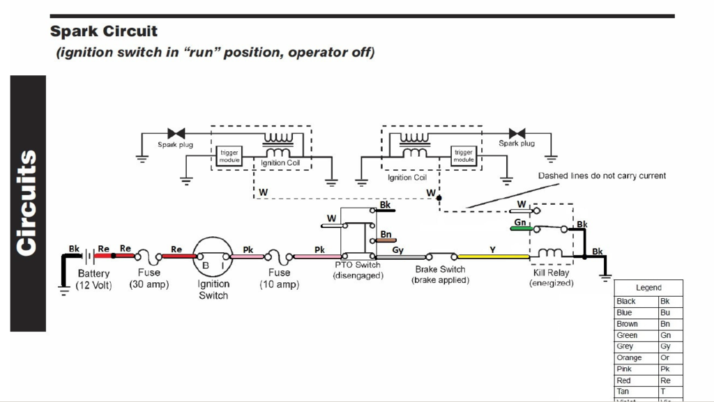

JoeM 9,579 #2 Posted June 12, 2023 Hard to tell what the problem might be, need to go through the drawing and eliminate all the items that ground the magneto wire. Share this post Link to post Share on other sites
JD2000520XI 4 #3 Posted June 12, 2023 thanks, are you talking about the white wire from the kill relay? this looks a little overwhelming to me at the moment. thanks again for your response 1 Share this post Link to post Share on other sites
JoeM 9,579 #4 Posted June 12, 2023 9 minutes ago, JD2000520XI said: white wire from the kill relay Yes, that wire should run along side of the right side of the engine. Near the starter wiring. Since it starts with the key it could be any one thing in this string to the kill relay. Share this post Link to post Share on other sites

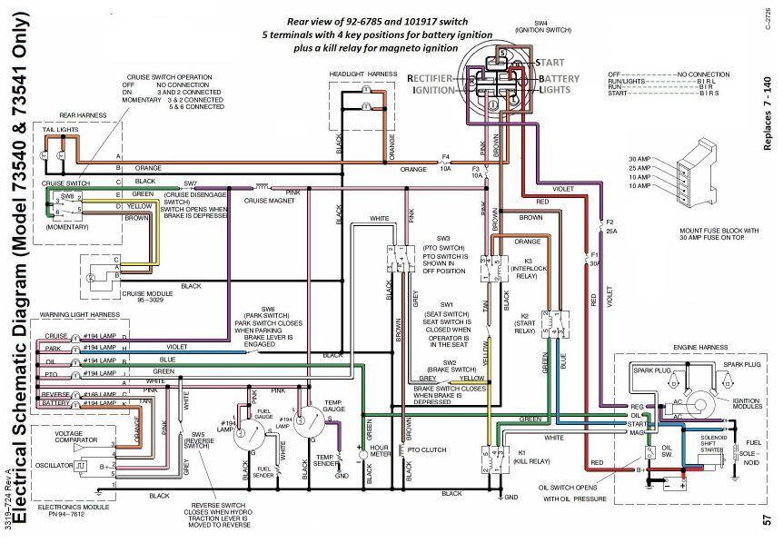

JD2000520XI 4 #6 Posted June 13, 2023 so yesterday i looked things over again and started trying to eliminate a few things in the wiring. just for the heck of it i started the engine and backed the key off to the "run with lights on " position and it stayed running. then 1 ahead to "run with lights off" and it stayed running. shut it down and it started once from " run with lights off" then it didnt the second time. looks like maybe a connection in the ignition switch or replace it all together? i did find relief that it does run now. thank you for the advice. Jim 2 Share this post Link to post Share on other sites
JoeM 9,579 #7 Posted June 14, 2023 On 6/13/2023 at 6:47 AM, JD2000520XI said: looks like maybe a connection in the ignition switch or replace it all together take a light and look into under the hood at the rear of the ignition sw. I have seen where they become corroded and may just need the plug taken off and cleaned up. Share this post Link to post Share on other sites
