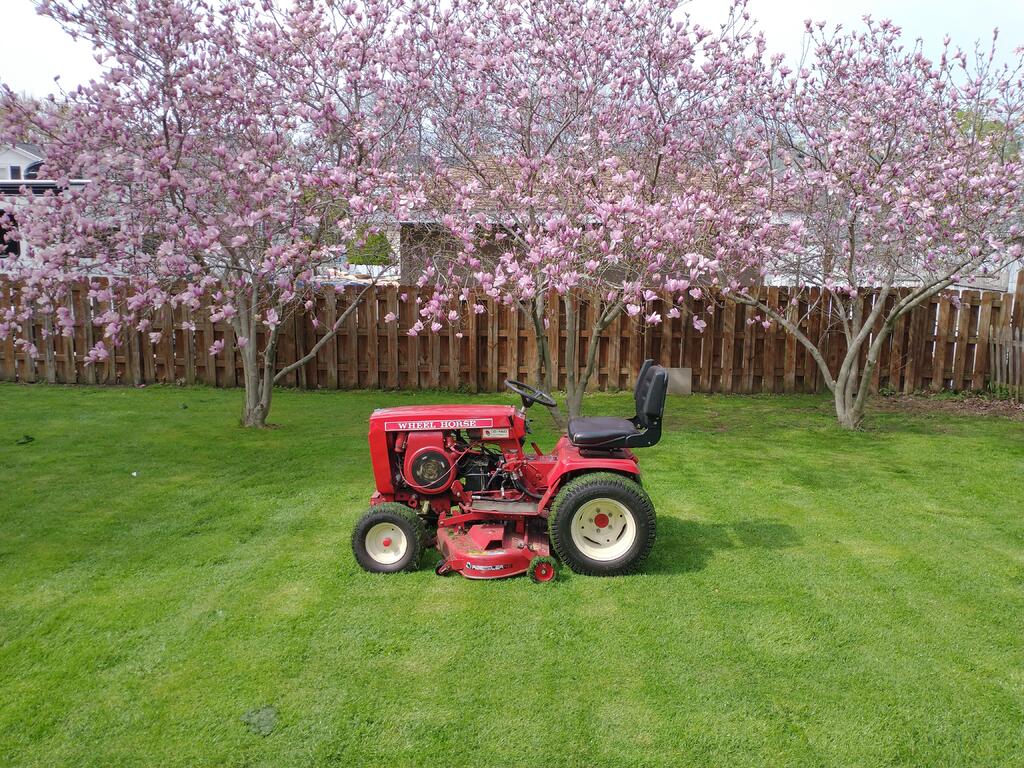

squonk 44,746 #8 Posted June 12, 2023 (edited) I have this adjustable seat on my C-160 mounted on u springs. Very comfortable and I think I had to drill 2 holes. Edited June 12, 2023 by squonk 1 Share this post Link to post Share on other sites
Dreamcatcher 102 #9 Posted June 13, 2023 5 hours ago, squonk said: I have this adjustable seat on my C-160 mounted on u springs. Very comfortable and I think I had to drill 2 holes. That sounds great! Do you recal where you purchased it? Share this post Link to post Share on other sites
squonk 44,746 #10 Posted June 13, 2023 9 hours ago, Dreamcatcher said: That sounds great! Do you recal where you purchased it? I got mine at Surplus Center Share this post Link to post Share on other sites
