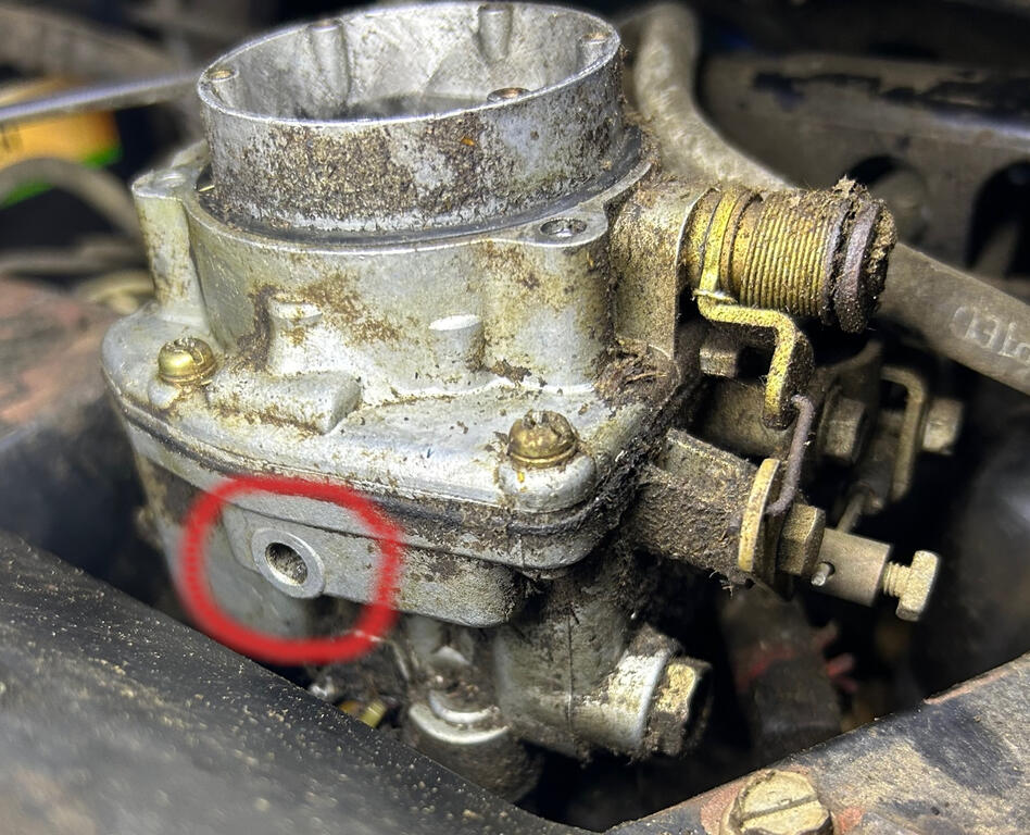

pgiro 36 #4 Posted June 2, 2023 Thanks for the replies. I took a look at it tonight and I don't see anything obvious unless this one hole on the side of the carb which I've circled is supposed to have a screw. Otherwise, I don't see anything loose or missing that would cause it to keep surging. If I leave the choke up almost all the way, it will stop surging and run ok, which seems to indicate a fuel/air mixture issue. 2 Share this post Link to post Share on other sites
lynnmor 8,297 #5 Posted June 2, 2023 You still need to remove the carburetor and give it a proper cleaning, the need for the choke says it all. You will need to pull the intake with the carburetor, so new genuine Onan intake gaskets will be needed. Since you will have it apart it would be a great time to adjust the valves. Here is the location of the welch plug I mentioned: 1 1 Share this post Link to post Share on other sites
Handy Don 15,368 #6 Posted June 2, 2023 48 minutes ago, lynnmor said: Here is the location of the welch plug I mentioned: And yes, in this image the welch plug IS missing 😁 The plug is a metal disk that wedges in tightly to seal off that hole. 1 Share this post Link to post Share on other sites

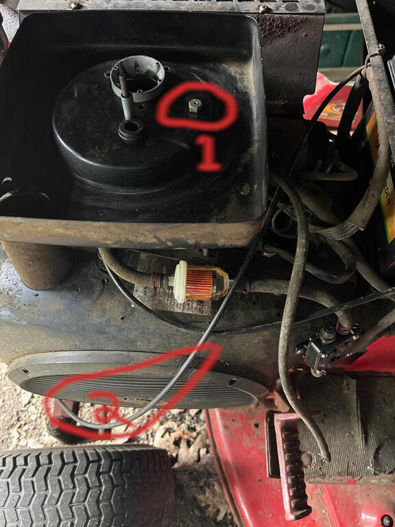

pgiro 36 #12 Posted June 27, 2023 Thanks for the very good advise on taking of the top of the carb and cleaning the ports. That seems to have fixed the problem. It's running normal now. One last question.. there is a thin vacuum type line that is connected to the air cleaner and I can't figure out where it was connected, if someone could tell me where it is supposed to be connected.. Share this post Link to post Share on other sites
RED-Z06 2,699 #13 Posted June 27, 2023 2 hours ago, pgiro said: Thanks for the very good advise on taking of the top of the carb and cleaning the ports. That seems to have fixed the problem. It's running normal now. One last question.. there is a thin vacuum type line that is connected to the air cleaner and I can't figure out where it was connected, if someone could tell me where it is supposed to be connected.. Im not explicitly familiar but usually any vacuum fitting inside a filter housing is for a filter minder, as a filter gets dirty it pulls a slight vacuum. Share this post Link to post Share on other sites
lynnmor 8,297 #14 Posted June 27, 2023 A small vacuum hose connects to the fitting on the bottom of the air filter base. The other end connects to a vacuum switch to turn on the air filter lamp when the vacuum gets too high. That vacuum switch is located on the left side of the dash, if the hose is not connected it needs to be plugged to keep dirt out. . It is common for those to have a broken nipple and the wiring connections fail as well. It will look something like this: Share this post Link to post Share on other sites
