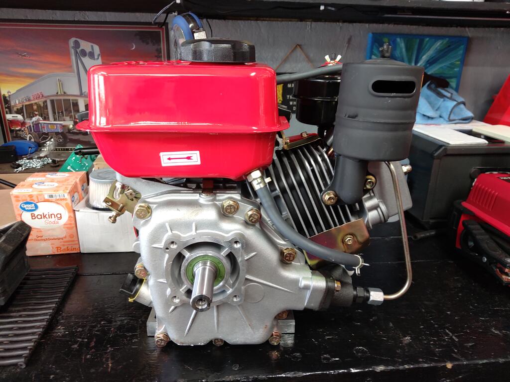

ML3 1,721 #1 Posted May 31, 2023 (edited) Although I have the original Kohler & a 2nd era correct Kohler (shout out & thanks to Buckeyes from this forum- he gave me engine!) for my RJ I decided for the time being I'm gonna install a 196cc ebay diesel. Since hood has been trimmed & I don't have an original fuel tank I thought I'd go the diesel engine route. Might be more cost effective to just buy a correct, restored RJ? Should be interesting. Edited May 31, 2023 by ML3 . 3 4 1 Share this post Link to post Share on other sites

953 nut 60,220 #4 Posted May 31, 2023 (edited) If it will fit where the K-91 went then I don't see any problem doing it. May be some interfearance with the muffler and hood stand but that can be worked out. Edited May 31, 2023 by 953 nut fat finger 2 Share this post Link to post Share on other sites
Pullstart 66,988 #5 Posted June 1, 2023 Wow, same footprint as a Predator 6.5 hp I take it? Nice! Share this post Link to post Share on other sites

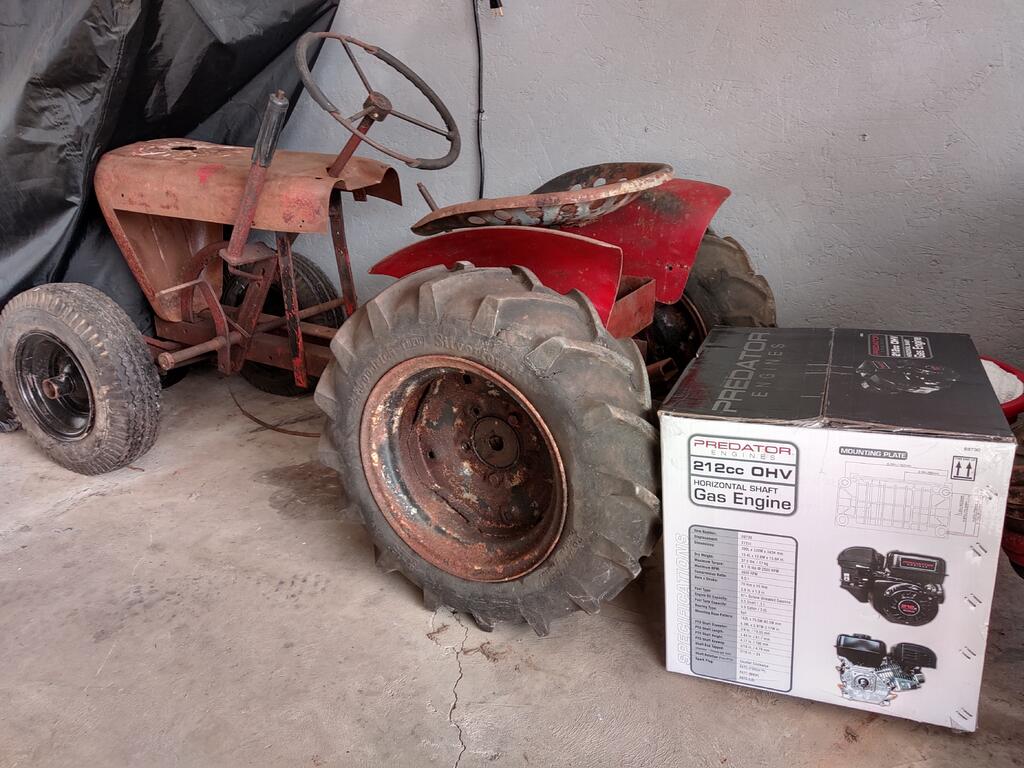

ML3 1,721 #6 Posted June 1, 2023 It looks like it will fit right in. I'll probably relocate fuel tank or replace it with another tank. Wanna try to utilize the original opening in the hood for stock fuel filler. I already have a predator sitting in garage for the Suburban. I'm doing the rat rod theme. I'll clean up & paint wheels, I'm gonna have an old school striper pinstripe hood & fenders in red & almond white Wheel Horse colors them I'll clear coat the rust. I'm going to order stage 2 kit for predator so it will have a k&n filter & straight pipe. Might also cover seat w/vinyl & some studs along with some fringe. 3 Share this post Link to post Share on other sites

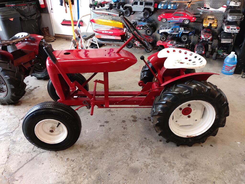

8ntruck 7,862 #7 Posted June 1, 2023 (edited) Really interesting. I see by the collection in the background you seem to be, or have been involved in RC hobbies. I used to race RC boats a long time ago. What is the story on the 4 mono hulls hanging there? Edited June 1, 2023 by 8ntruck 1 Share this post Link to post Share on other sites
ML3 1,721 #8 Posted June 1, 2023 (edited) 9 hours ago, 8ntruck said: Really interesting. I see by the collection in the background you seem to be, or have been involved in RC hobbies. I used to race RC boats a long time ago. What is the story on the 4 mono hulls hanging there? As far as the rc stuff, it's another out of control hobby. 3 of the 4 boats are Proboat products from Horizon Hobby. Gray boat is a real jet drive- it's really fun in the rapids.The yellow boat is an older Thunder Tiger outlaw. All are brushless electric. Also have an Oxydean Marine Animal catamaran that goes over 100mph. For what I paid for that it stays in the house with a few other of my really expensive rc stuff. Keep my Sea Ray up at the Lake Erie islands so I usually have the rc boats up there. Edited June 1, 2023 by ML3 . 1 Share this post Link to post Share on other sites
ML3 1,721 #9 Posted June 3, 2023 Added oil & took some time to bleed out high pressure fuel injection pump. After that- 3rd pull & it fired up. It even rolls some coal! Lol. Gonna be fun in the RJ! Unfortunately I can't get video of engine running downloaded Share this post Link to post Share on other sites
